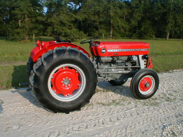

Man, that looks good. I repainted everything on my 135 about 1 1/2 years ago and watching your progress makes me want to do it again. It's something about the first shot of color to make you forget all the prep work. If you really want to get carried away (like I did) hit it with some glaze and microfinisher and buffer. Definitely brings out the gloss. But remember, those high spots and runs are just areas that might see more wear and need more protection than others.
Don't you just love the smell of fresh paint on a warmed up tractor.
Great job. This is mine after 3 months of work and learning how to paint.
Thomas

Good lookin' 135 you got there!
I've already wet sanded and buffed out one "sag". (Not quite a full-blown run)
I'll probably wait 6 weeks or so to let everything dry down good, then do some polishing. I'm not so much after more shine as I am just getting a good lasting finish. It just happened to turn out REAL shiney. I used the absolute maximum amount of hardener, sprayed just a tick "wet" (thinned) with the paint, and the lowest air pressure I've ever used with my paint gun. (25psi-Sharpe Platinum HVLP) The hood has been done for almost a week now, and from 10 feet away, it still looks wet.
And funny you should mention it, but the 3 remaining runs are ALL in high wear areas. (Where leg makes contact with fender when getting on and off the tractor) Before painting, those areas were worn clear to bare metal. It won't take too long to wear off the runs in all likelyhood.
