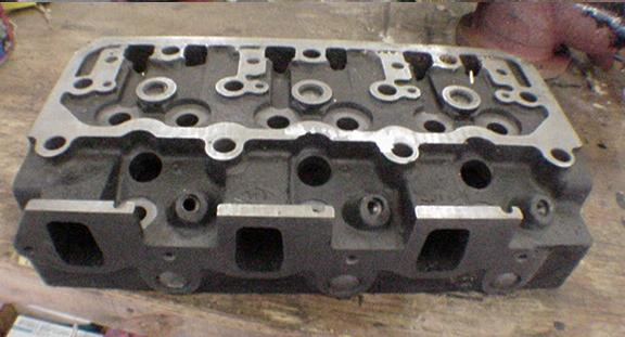

Well, I'm still waiting on confirmation that my 284 engine is Direct Injection. It has no glow plugs, manifold heater or compression release. It DOES have a heating circuit though. Stupid.
Does anyone know if glow plugs can be retrofitted to a DI engine?

Not likely. Direct injection engines typically use different cylinder heads, have no pre-combustion (swirl) chambers, and may even have different shaped piston heads. Glow plugs on indirect injection engines heat into the swirl chambers. On those direct injection engines that do in fact employ glow plugs, they heat directly into the cylinder (no swirl chamber). That said, there could be plugs screwed into holes that would otherwise have glow plugs in them. You just have to know where to look.
To save money, they use a common fuse box for more than one line of tractor - or type of engine. In this case - when fitted with an indirect injection engine - the tractor wiring includes that fused circuit. But if a direct injection engine is put in the same tractor, that fuse slot simply isn't used.

If your head looks like these you can retrofit glow plugs, if not, you can't. You need those small angled threaded holes adjacent to the intake ports.

Well, my heads won't accept glow plugs but I now have a radiator heater
(600W KATS) plumbed in and WOW. IN the 20's yesterday, all I had to do was turn the key and it fired IMMEDIATELY. Amazing difference.
Thanks for all the posts and help.
