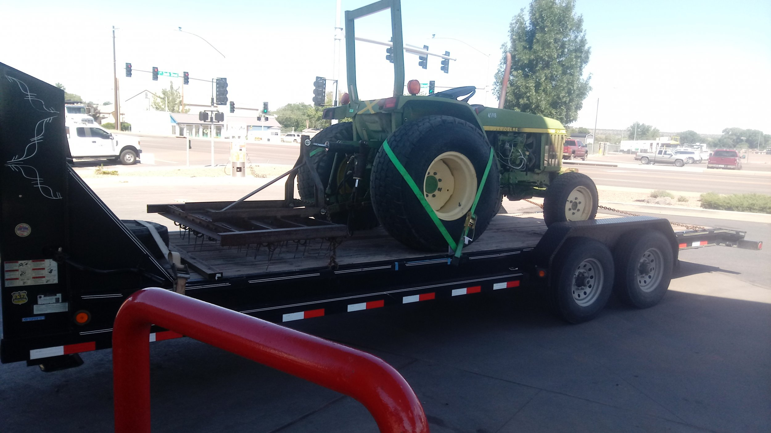

10,000 miles of towing my 3 horse slant load bumper pull and another 8000 with an equipment trailer with hay or whatever on it, I've only hit 3000 rpms maybe a few times when I wanted to show off, otherwise easily you won't notice the engine struggle with 8-9000 lbs behind it uphill on into the wind.
