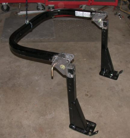

The reason I brought this up was a comment by RonR in another thread where he indicated he had a strong desire to have a folding ROPS on his tractor. For some reason that sentence he wrote stuck in my mind after reading it. RonR REALLY seemed to want a folding ROPS. I could feel it...
Being a practical kind of guy part of the time, in my mind I tried to blow the smoke out of the way and to see the issue at hand.
Is there any reason to believe that a qualified welder should not be able to duplicate what a welder in the factory does? Doubt it. Is there any reason why the end result should be weaker than the original folding ROPS, if the OEM design is duplicated? Doubt it. Net conclusion on my part? If the hinge was added and the tractor rolled or back flipped, protection offered by the ROPS would not be less than what is offered by OEM folding ROPS.
From the practical side, the protection offered should be as good as it was to start with. All the other legal issues fit into the smoke side of the equation in my mind. I don't mean to make light of them as they are real issues, especially if the tractor would be used in a commercial venture, etc. But we are talking home use by a private party.
Granted I am putting some faith in Kubota engineers and assume that the hinge assembly they designed is adequate for the job intended.
To carry this discussion a step further, some of you may remember that I added a light duty FOPS to my tractor. The reason was because I feared that trees on my back hill, and had visions of sugar plumbs dancing in my head...no, that's not it...had visions of the tractor with ROPS up, and with me securely belted in, going over on its side, next to a tree, with the tree on my side of the ROPS...can't get the belt loose, tree folds me in half and squeezes me into the seat...OUCH!
So I built this "head protector" that slips over the ROPS, and is held securely in place at the ROPS end and also supported in the front by the loader structure.
Using the logic discussed in this thread, my modification would be "illegal" too, wouldn't it? By the same token, this protector has protected my head a couple times from falling stuff, including a full bundle of shingles, that slid down the loader arms and was caught by the hood guard and front uprights. /forums/images/graemlins/blush.gif But that's another story...
This modification actually has helped make my tractor safer than it was with just a ROPS on it. I am glad I did not let the smoke get in my eyes and prevent me from implementing this idea on my tractor.
Ironic, but the B2910 ROPS is folding, but it has never been folded and probably never will be... /forums/images/graemlins/tongue.gif
Wonder if I should weld that hinge up and make it stronger, since I am never going to use it anyway? /forums/images/graemlins/shocked.gif /forums/images/graemlins/blush.gif /forums/images/graemlins/tongue.gif /forums/images/graemlins/grin.gif

Since I made my own ROPs, if and/or when I sell the tractor I'll remove it and either give it to the new owner labeled as "Scrap metal" or keep it............but while I have my tractor, I feel comfortable with it on there, it's better than what I had before, which was nuttin!
I had no qualms about making it or installing it, and while I'm not a "Certified" welder, I've been doing it long enough that I feel competent enough to risk at least my own life with it........

one other option, if you are going to copy a folding rops for your tractor, maybe you can buy one to fit it?
