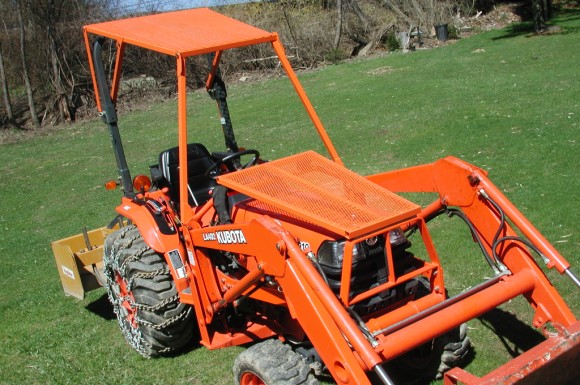

To carry this discussion a step further, some of you may remember that I added a light duty FOPS to my tractor. The reason was because I feared that trees on my back hill, and had visions of sugar plumbs dancing in my head...no, that's not it...had visions of the tractor with ROPS up, and with me securely belted in, going over on its side, next to a tree, with the tree on my side of the ROPS...can't get the belt loose, tree folds me in half and squeezes me into the seat...OUCH!
So I built this "head protector" that slips over the ROPS, and is held securely in place at the ROPS end and also supported in the front by the loader structure.
Using the logic discussed in this thread, my modification would be "illegal" too, wouldn't it? By the same token, this protector has protected my head a couple times from falling stuff, including a full bundle of shingles, that slid down the loader arms and was caught by the hood guard and front uprights. /forums/images/graemlins/blush.gif But that's another story...
This modification actually has helped make my tractor safer than it was with just a ROPS on it. I am glad I did not let the smoke get in my eyes and prevent me from implementing this idea on my tractor.
Ironic, but the B2910 ROPS is folding, but it has never been folded and probably never will be... /forums/images/graemlins/tongue.gif
Wonder if I should weld that hinge up and make it stronger, since I am never going to use it anyway? /forums/images/graemlins/shocked.gif /forums/images/graemlins/blush.gif /forums/images/graemlins/tongue.gif /forums/images/graemlins/grin.gif
Attached is a picture of the bad boy... /forums/images/graemlins/smile.gif

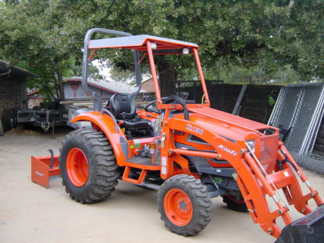

   / Why not make a fixed ROPS foldable??? #27
You were my mentor Henro, the same thoughts entered my mind about a tree falling on me from the side while I was safely strapped into my seat.

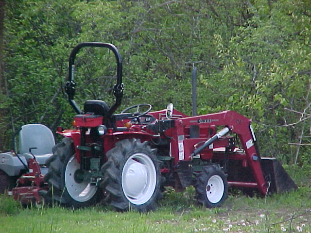

   / Why not make a fixed ROPS foldable??? #29
Since I made my own ROPs, if and/or when I sell the tractor I'll remove it and either give it to the new owner labeled as "Scrap metal" or keep it............but while I have my tractor, I feel comfortable with it on there, it's better than what I had before, which was nuttin!
I had no qualms about making it or installing it, and while I'm not a "Certified" welder, I've been doing it long enough that I feel competent enough to risk at least my own life with it........
