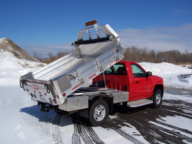

As I come to use my truck more and more it dawned on me that a cab chassis with an aluminum flat bed would really serve me better. The standard pick up bed is fairly limited and fragile compared to the flat bed offerings. I'm starting to wonder why more of us don't end up going the cab chassis route? I'm thinking real hard on trading in the current pick up and going with the flat bed.

Make it with fold-down sides, and dump.

I put a 8' dump on my 99 F250, old bed rusted. Love it. Have sides on it most of the time, but they lift off easily. If you have to get a loan, check with your bank first. Some will consider a flat bed or C&C a work truck, not a personal vehicle and so no loan or different loan.
