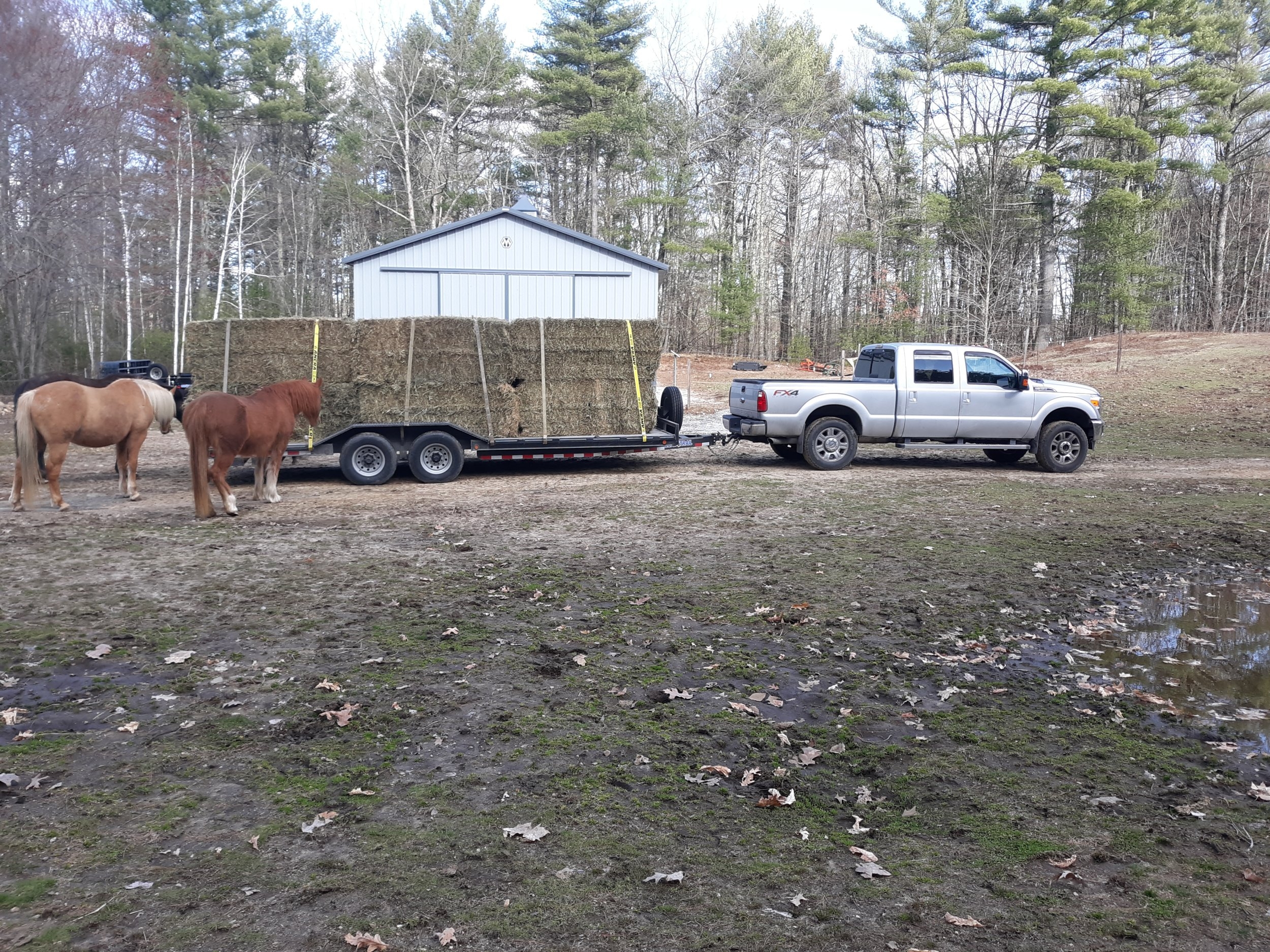

My 22 foot load trail .....

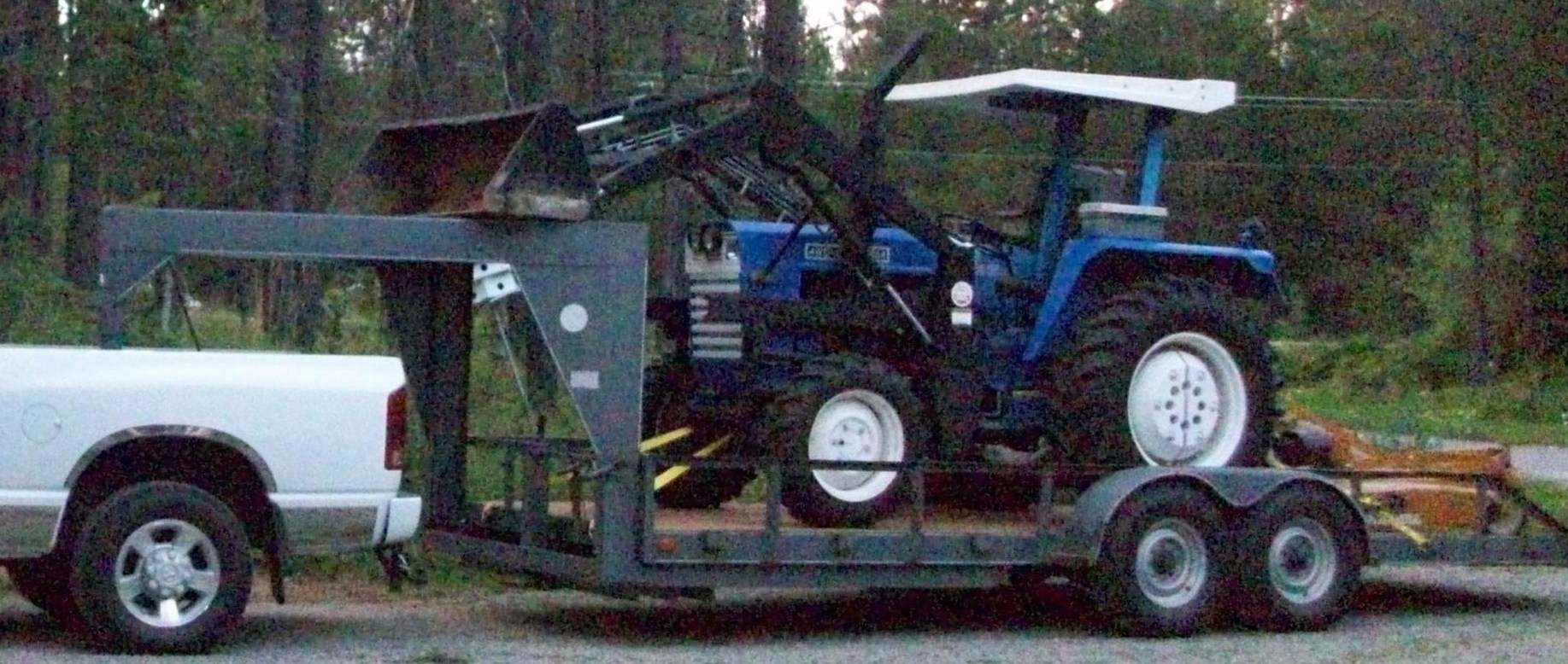

You can see it perfectly with sea2summint picture with a tractor with a FEL the rear wheel is behind the rear axel and 3/4 of the tractor is in front if the rear axel the trailer is sightly angle up. If the axels would be in the middle most of the weight would be in the back resulting in a negative tongue weight resulting in intensive swaying.

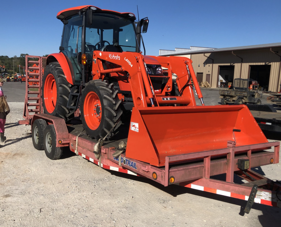

I'm in the market for a 22' car hauler for my Kubota. What I've been noticing is that most of the trailer length is in front of the axles, putting a lot of weight on the hitch. What am I missing here? My last 22' trailer had the same problem and I recently sold it. I was constantly being flashed at night for high pointing headlights. Any manufacturers that put their axles a little more towards the front?
