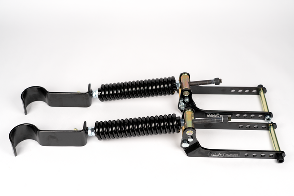

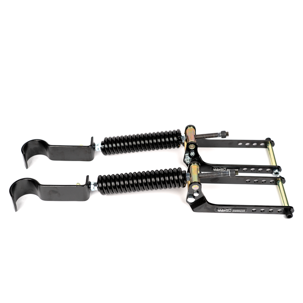

I second your concern based on the image. If you’re buying new, then I’d be very selective.
Bandaids could include installing airbags or an add-a-leaf, but going that route wouldn’t be my Plan-A.
How is that going to help tongue weight?

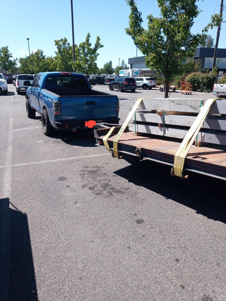

That depends. Too much tongue weight can cause the same kinds of problems as too little, with lack of steering also thrown into the mix. Here's an example I saw parked at Home Depot a while back. Toyota Tundra with a tandem dually trailer with concrete perma column posts loaded at the very front of the trailer. I think I could have lifted the front of the pickup off of the ground by hand.

That depends. Too much tongue weight can cause the same kinds of problems as too little, with lack of steering also thrown into the mix. Here's an example I saw parked at Home Depot a while back. Toyota Tundra with a tandem dually trailer with concrete perma column posts loaded at the very front of the trailer. I think I could have lifted the front of the pickup off of the ground by hand. View attachment 855876
Of course, it needs to be within the rating of the truck. Kind of common sense, or it should be.
lol that photo belong in the ''Pics of people hauling or towing something wrong'' tread, a toy truck hauling a real truck load is the problem here not too much tonged weight.
True. The principle still applies though. Even if the trailer is at or lighter than the rated capacity of the tow vehicle (unlike the one in that photo), too much tongue weight can cause big problems.

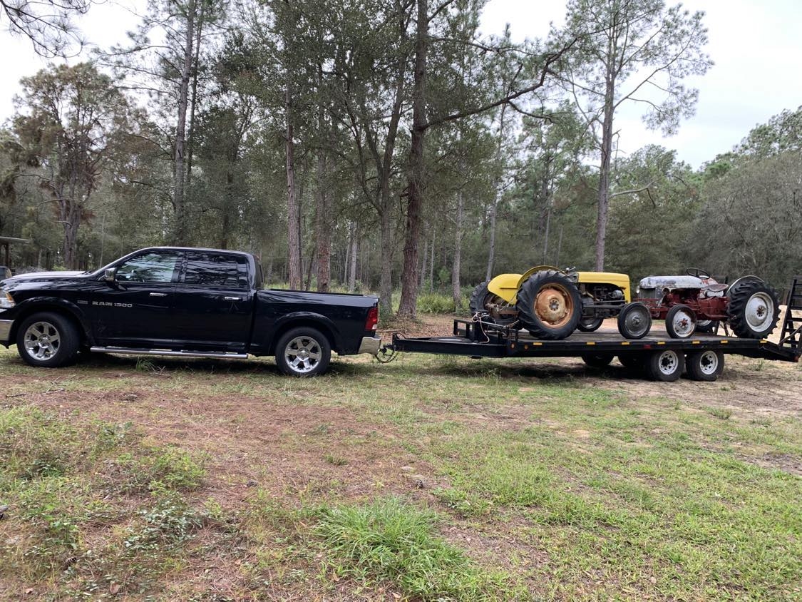

20' Rice 10K trailer loaded with everything precious to me ;)
Pulled with 1/4 ton F150 and weight distribution hitch. Rear sat 2" lower (which actually leveled the truck) and front raised 1/2" ... if front lifts any higher you have to adjust load.
