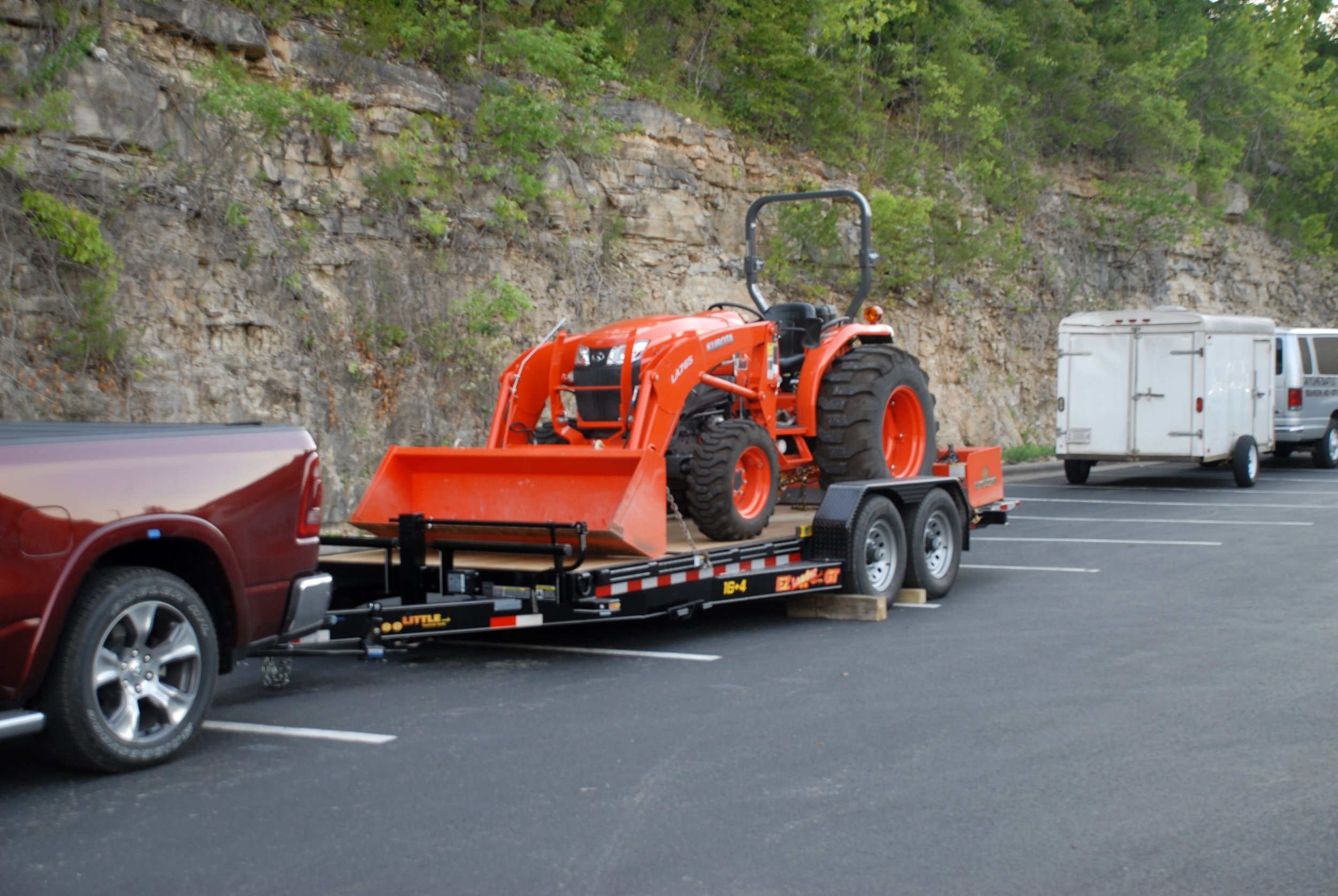

I'm in the market for a 22' car hauler for my Kubota. What I've been noticing is that most of the trailer length is in front of the axles, putting a lot of weight on the hitch. What am I missing here? My last 22' trailer had the same problem and I recently sold it. I was constantly being flashed at night for high pointing headlights. Any manufacturers that put their axles a little more towards the front?
Placement of load, obviously weight needs to be on trailer tires, hard to get one trailer to fit all vehicle lengths - sometimes placement requires backing on trailer - equipment / buckets up front seem to balance a little easier, if you are new get a weight scale hitch, or simply use a scale and experiment, placement of load and following GVW guidelines work - overloading the hitch is not a good idea, it not only can cause serious handling problems it can easily fail under hard braking / maneuvering

It seems that you have the wrong truck, not the wrong trailer. You may need to go up to a heavier duty truck to alleviate your problem. Good tongue weight is essential, or your trailer will be unmanageable and will be steering your truck. If you have the room. you may be able to move the tractor back a little on the trailer to shift some of the weight off the tongue. Also, if the trailer is not level and tips down at the hitch, more weight shifts to the tongue.
The axle location is based on having optimum control of the trailer while towing. When the axle is moved too far forward you stand a better chance of losing control of the trailer. With the amount of weight you can have on the trailer it would take control of your vehicle and cause an accident that would cause injury or death to yourself and or others.

The link to etrailer, which explains the 60/40 and 10%-15% is spot on. With that said, if you have a trailer that has the axles farther back, you need to keep in mind the purpose of that trailer. It isn't going to be an all-purpose trailer, it's a purpose-built trailer. A car hauler is purpose-built to haul a car, not a tractor. Not saying you can't haul a tractor on it. Just saying that you need to keep in mind that the trailer was "purpose-built" to haul a car. A car is usually balanced at 60-40, or 55-45. And when you load a car, generally speaking it's going to only be slightly forward of the the center of the axles, and not hanging off the back. A tractor is usually (especially with a FEL) front heavy, and with the loader it's hard to not have too much tongue weight because the loader will be all the way to the front of the trailer, and the rear tires at the rear of the trailer. So, either the trailer is meant to have a car that is easier to position as it was intended, or it's meant to be pulled by a 3/4 ton or one ton. Or, as mentioned, a weight-distribution hitch NEEDS to be used.
Loading a trailer is very often done wrong. How many trailer do you see with just a few things on it, but all of the load is at the front? I see it all the time. Motorcycles loaded on the front of a 16 foot trailer. Why? Because they want to use the front of the frame to hold the front tire. The proper thing would be to install wheel chocks on the trailer so the bike could be loaded over the axles (slightly forward) to keep the balance at 60/40 and the tongue weight at 10%-15%. If said bike is loaded on the front, but towed by a 3/4 ton truck, no big deal. But if towed by a 1/2 ton, or SUV, the bike needs to be only slightly forward of the axles. Another thing to keep in mind. I have two trucks. Both Rams. One is a 1/5 ton, the other is a Dually. However, they BOTH have the exact same hitch. Rated at 5,000 lbs, or 10,000 lbs with a weight distribution hitch. Long story short here....If you are pulling that trailer with a tractor on it, with a 1/2 ton truck, you NEED to load it right, AND use a weight-distribution hitch.

RV industry is just trying to convince people to buy bigger campers than their trucks can handle.
Rams trucks are squat machines, you don't need much behind and they are squatted right up... so its ether you have air bags or a weight distribution hitch... Sure having a 2500 would be nice but to haul a camper twice a year I ratter used a distribution hitch or air bags.
   / Why so much tongue weight on 22' car hauler trailers? #55
If you want to know the REAL reason, listen up:
If the axles were more centered, the center of gravity of the rig would be right around the center of the 2 axles. With a load placed on it, this location would pretty much be the same. Given the total mass of trailer + load, the yawing frequency would be (lets say) F_sub_yaw.
With the axles placed farther back, the yaw inertia is a higher value because of the 'axis translation' theorem (I_zz = I_zz + M*r^2). R being the altered distance. This LOWERS the natural yaw (tongue swing frequency) so it will be much more manageable. It it gets higher than about 1 Hz. you're probably not going to be able to save it if it starts oscillating above the critical speed.
Another way of saying it is that the swinging tendency will happen at a much higher speed.
That's my typical expert witness court-room testimony.

My 20' car hauler is like this also, axles set pretty far back.
However this is the correct way to make and use such long trailers. If you put the axles right in the middle, there would be a huge potential for negative tongue weight, which we all know is a terribly dangerous situation.
If you want such a long trailer, you need a tow vehicle that can handle the tongue weight, simple as that. You also MUST be using a WD hitch. Start there if not.

It is important to remember, that the trailer rotates around the axles.
I’ll try not to go off into the physics of what goes on too far.
Think of the trailer from the hitch point to the center of the axle(s). This lever length for easy to follow math, I’ll do like a physicist, and make it twenty feet for convenience, knowing it is unrealistic.
The trailer will want to rotate around the center of gravity if it starts to sway. The further forward from the center of the axles, the center of gravity is, the more leverage the trailer has has to control the sway. For purposes of easy math we will say that the distance from the axles to the center of gravity is 5-ft.
So, if the trailer wants to sway and yaw, you have a thirty foot lever to stop it with. And with the hitch to center of axles of 25-ft, and teh distance to center of gravity of five feet, the percentage of the load on the hitch will be 5/25 or 20% of the total trailer load. This 20% pushes down on the rear wheels. Which in turn increases the friction between teh tire and the pavement. And it is thus harder for the trailer yaw, and sway, to push the tow vehicle around.
Down side of increasing the load on a bumper hitch, is that the load on the rear of the vehicle, causes leverage acting around the rear wheels, which wants to lift the front of the vehicle and decreases the ability to steer the vehicle.
The use of a load distributing hitch, creates a torque around the hitch, which counters the torque created by the tongue load, and put a load equal to that on the rear wheels, and make the steering stable.
None of this over rides the tow vehicles, max towing weight and GVW. Much of the GVW maximum is based on how big the brakes are. Which is why the wheel size of newer 3/4 and 1-ton trucks keeps getting larger. They need the bigger wheels, to fit ever increasing brake systems into the wheels, so they can tow ever increasing loads. Soon they will hit the max allowable without air brakes. At which point we will see whether they change the law or not.
Well, I know from experience that you DO NOT want that much trailer and load STEERING for you if you get the tongue weight too low!
That bad boy will toss you around like a puppy shaking a rope if it doesn't have enough on the tongue.
