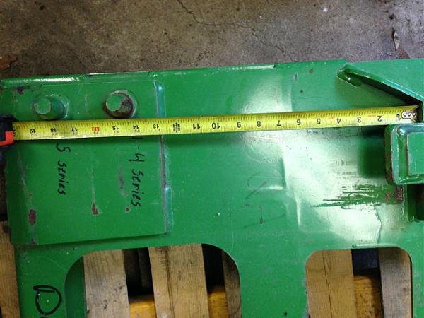

The other noteworthy disadvantage to the Deere couplers is they aren't even compatible across Deere loader models.
SSQA is only "too large" for subcompacts IMHO. It is the most common, most utilized and has the most variety of attachments, period. No way that anyone choosing SSQA for a CUT or utility tractor is making a mistake.
/ Why SSQA? #10
The 1, 2, 3, and 4 series machines share the same JDQA, only when you get into the 5 series the lower pins are about 4" lower.
