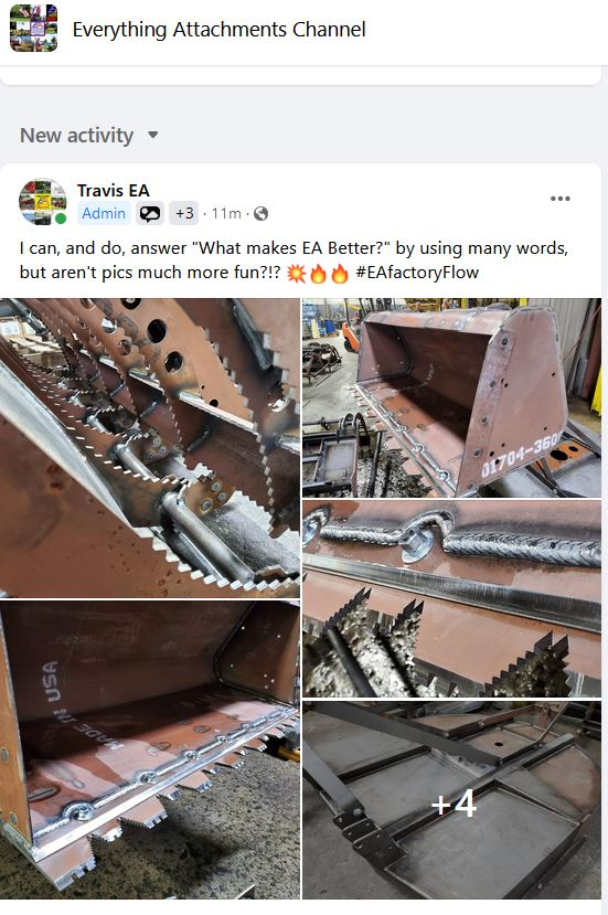

If you guys like seeing the build processes, and unpainted Wickedness, along with good fun all day, come on over and check out the Everything Attachments Channel Group on facebook. You can see the content, even if you aren't a fan or member of facebook.
Travis
I just took and posted some fresh, Wicked pics from the factory..
Travis

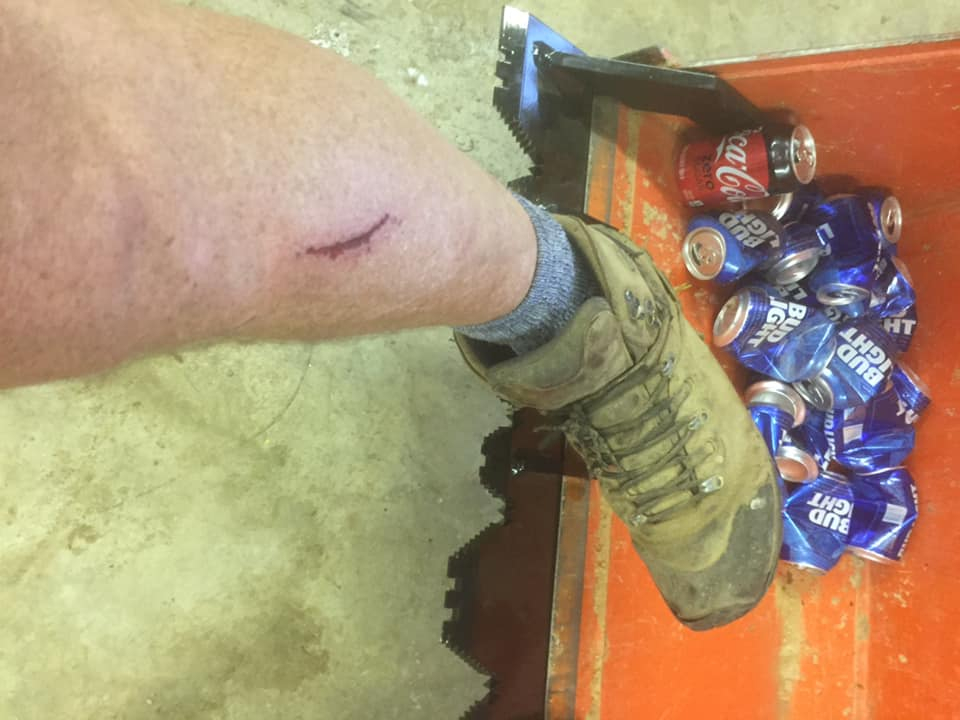

*PUBLIC SERVICE ANNOUNCEMENT*
Keep your body away from WICKED teeth!!
Oh, and don't drink Coke around them, either.. :ROFLMAO:

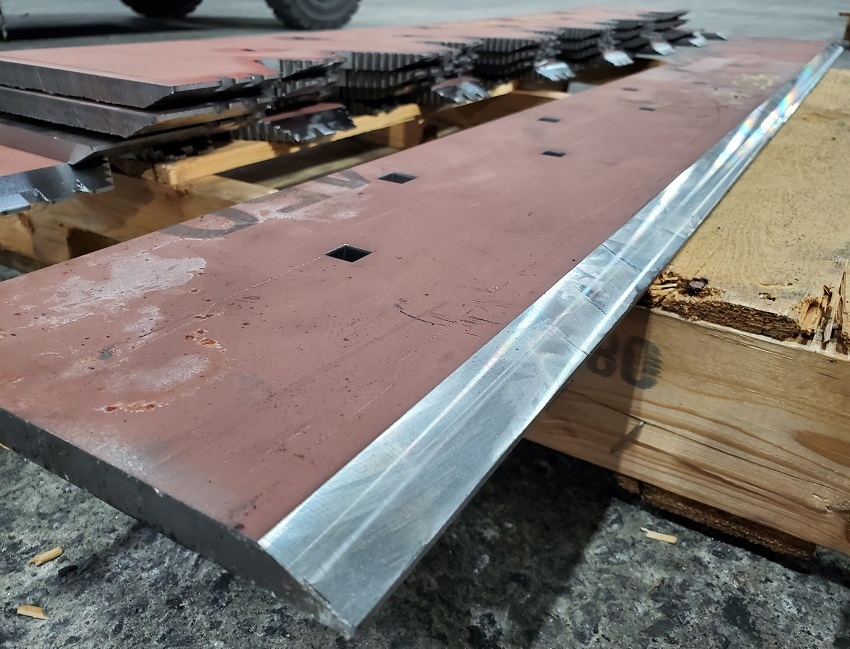

It definitely wouldn't be a pain to add it.
I've sold quite a few for Kioti buckets with those weird shapes, and haven't heard of an issue.
This may help. For installation, the distance from the tip of the cutting edge to the center of the bolt can be up to about 8.5".
Travis

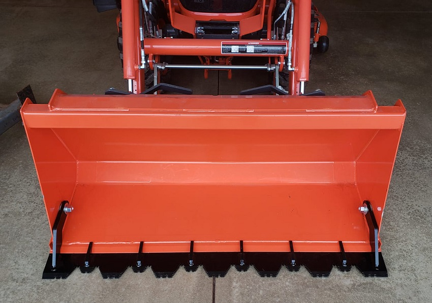

Yeah, around 4wks build time here lately.

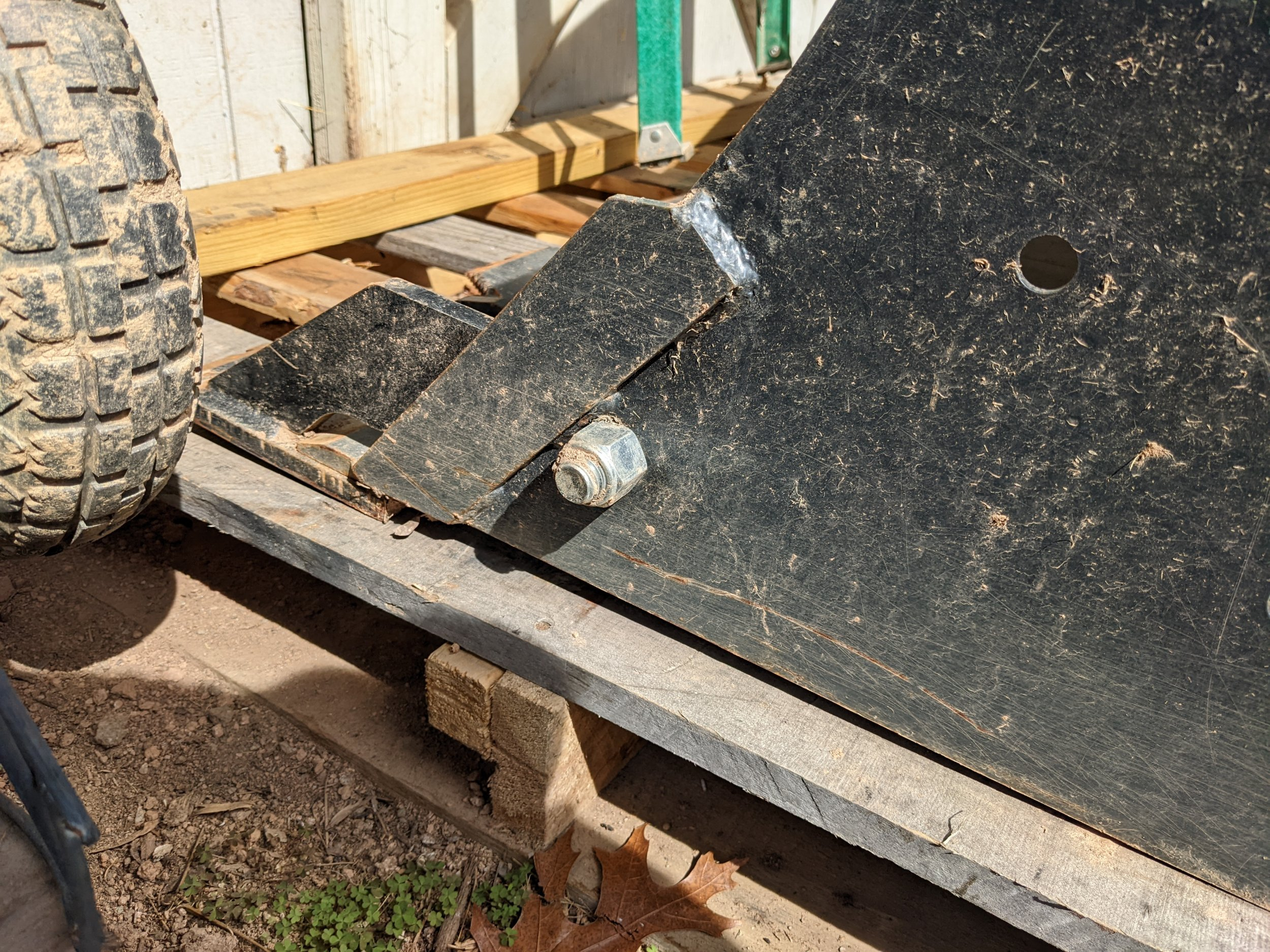

The inside measurement is the most crucial. As long as it is correct, you could ballpark the overall at a couple inches more and be safe. 3rd question is plate thickness of the welded on edge, and that's not usually any thicker than 1/2".
Because of not knowing the exact overall, it could stick out a little further than the bucket edge on either side, instead of being perfectly matched, as shown here, but that wouldn't be a biggie for most..
Travis
