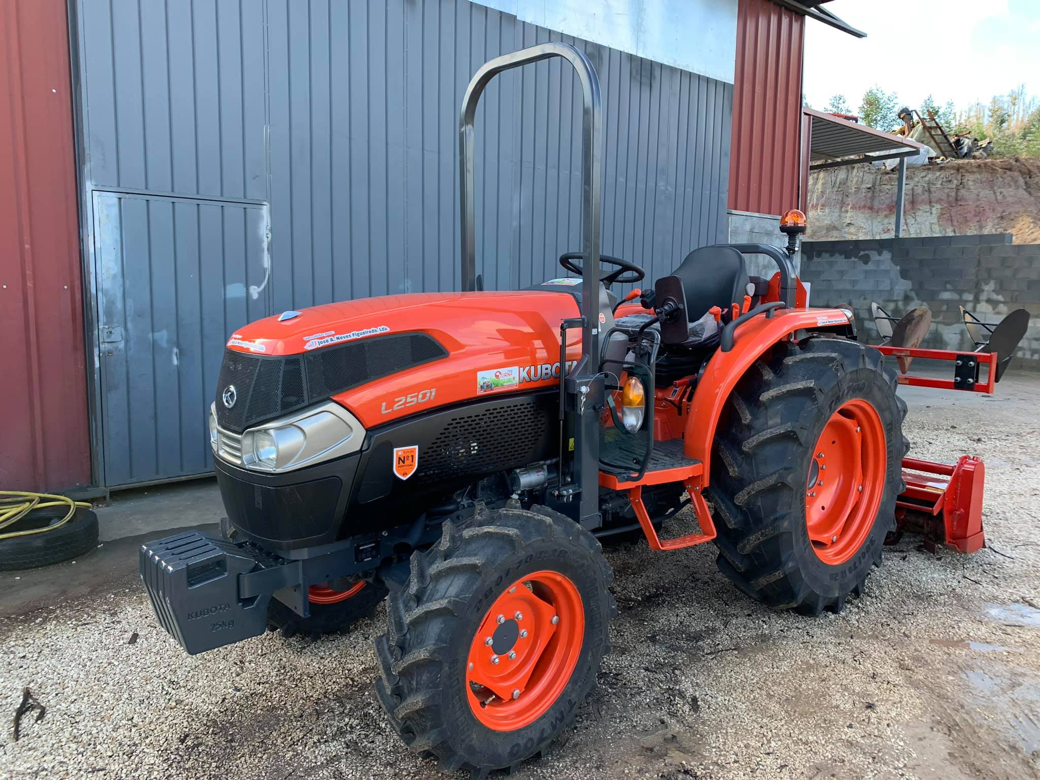

Here are a couple of Kubotas on radials:

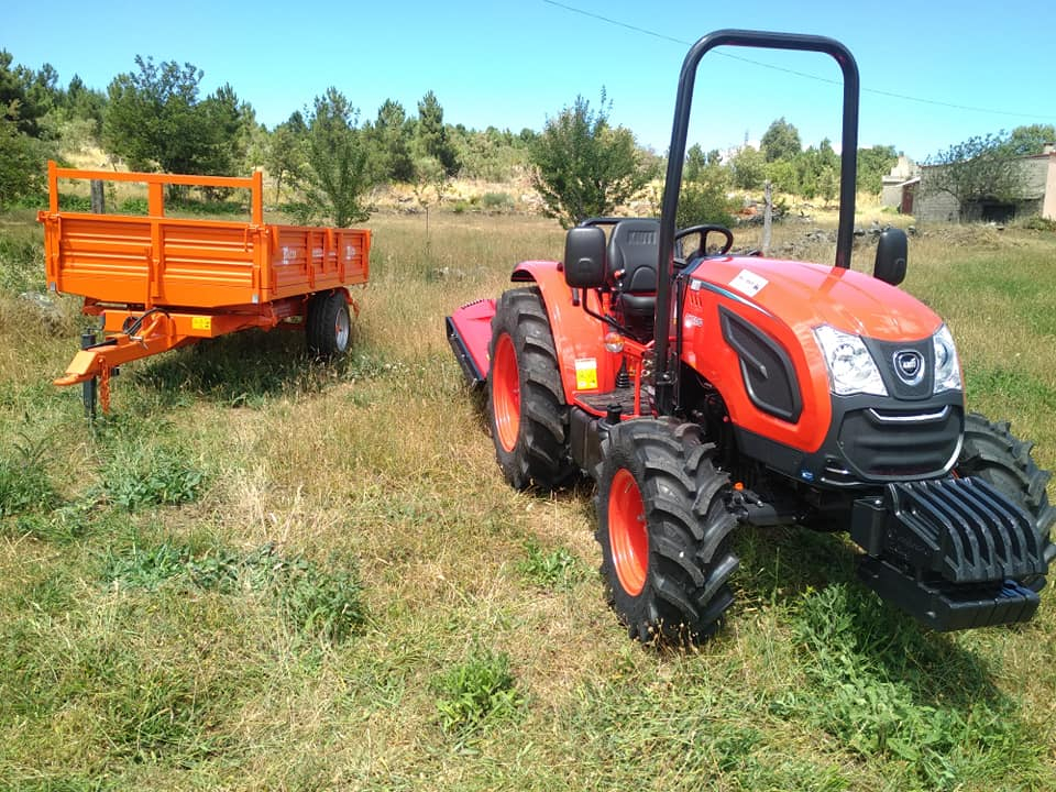

And a Kioti:

Being that we drive the tractors a lot on the roads, these radials last longer and provide a better ride. Along with all the other advantages of radials, like better flotation, traction, better resistance to punctures, etc.
