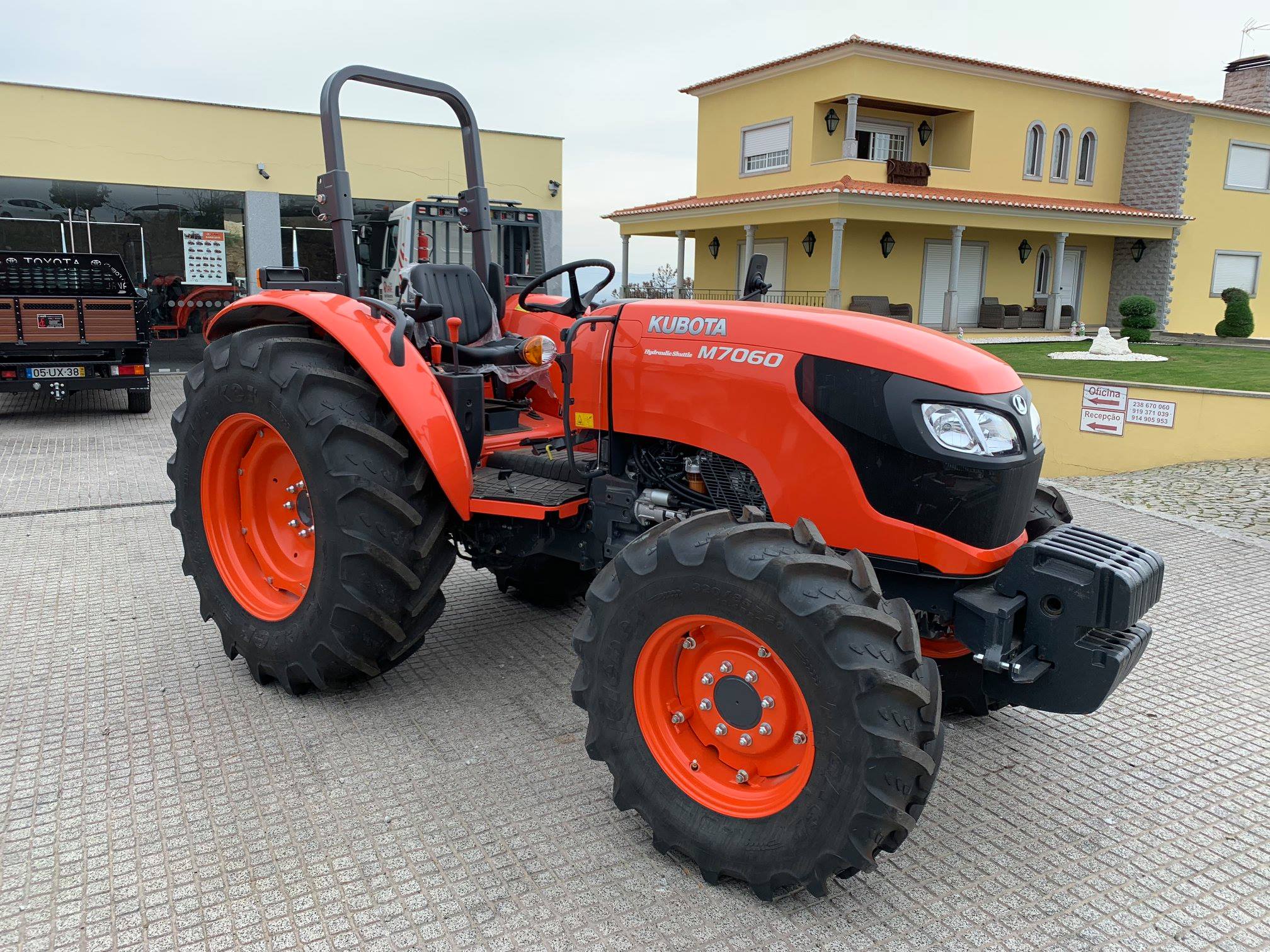

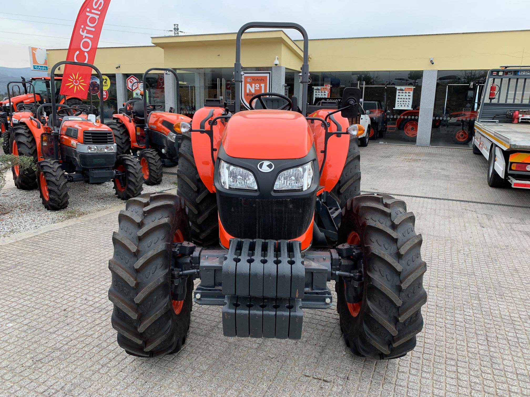

How common is to get R1 radial tires in the US? What's the main reason for the diagonal R1, other than the cost?
We get them in every tractor from SCUT up to big AG tractors. Besides giving a very cool look to the tractors, they also provide better ride and traction with less compaction.
43672058_2103734393024194_940488028395143168_o.jpg44787264_2103734349690865_3711948961859239936_o.jpg
   / Wider front tires M7040 Kubota #46
Radials are very common. Actually, might be more common than bias ply. Especially on AG tractors.
I have Radials on my M9540. I really like them. Better ride. Better traction.
Canada has been using R1W tires for a few years now. They are just beginning to show up in U.S. I replaced the 12.4Rx24 front tires with R1W tires last Summer. Gained 1.5" section width.

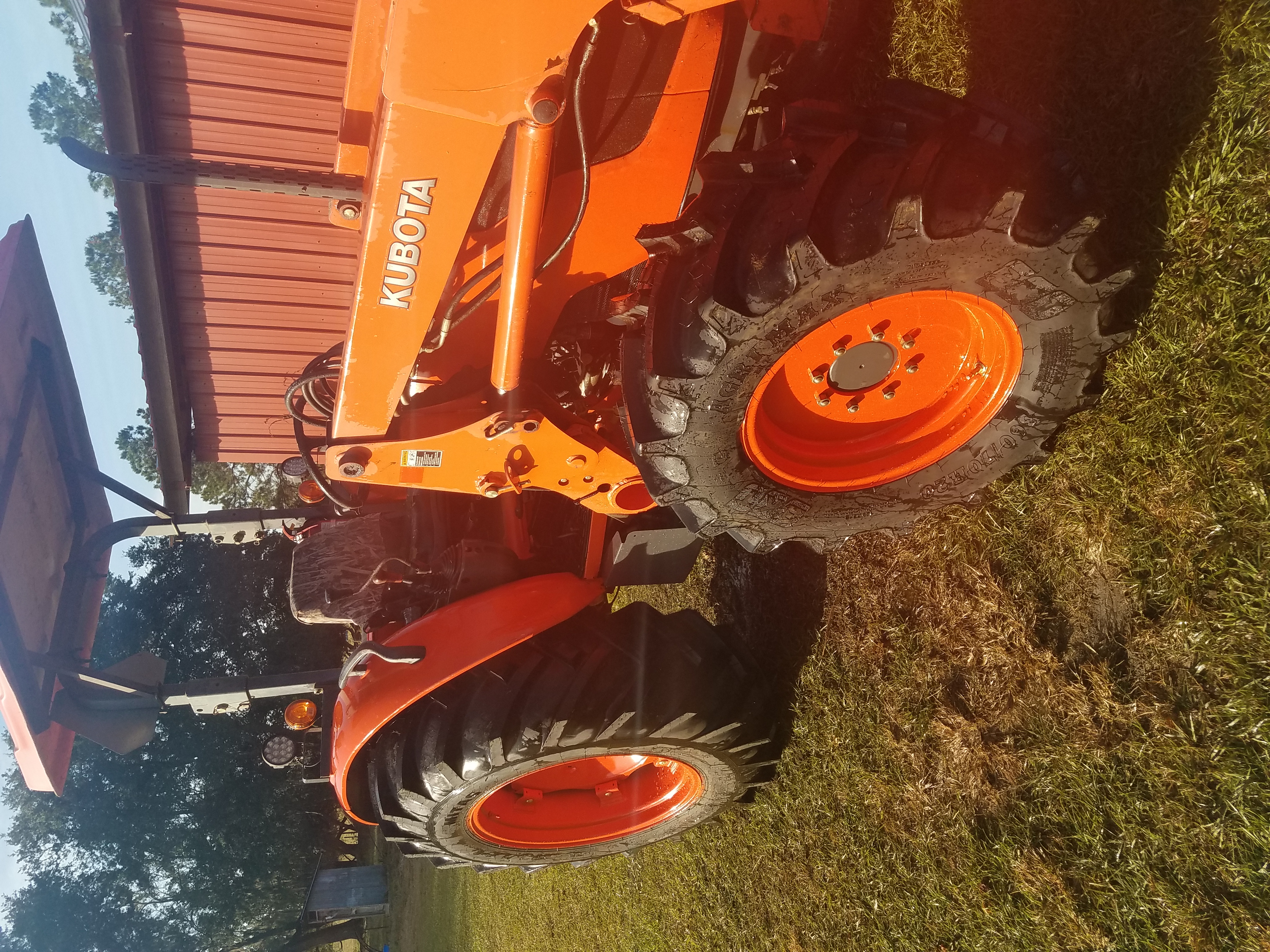

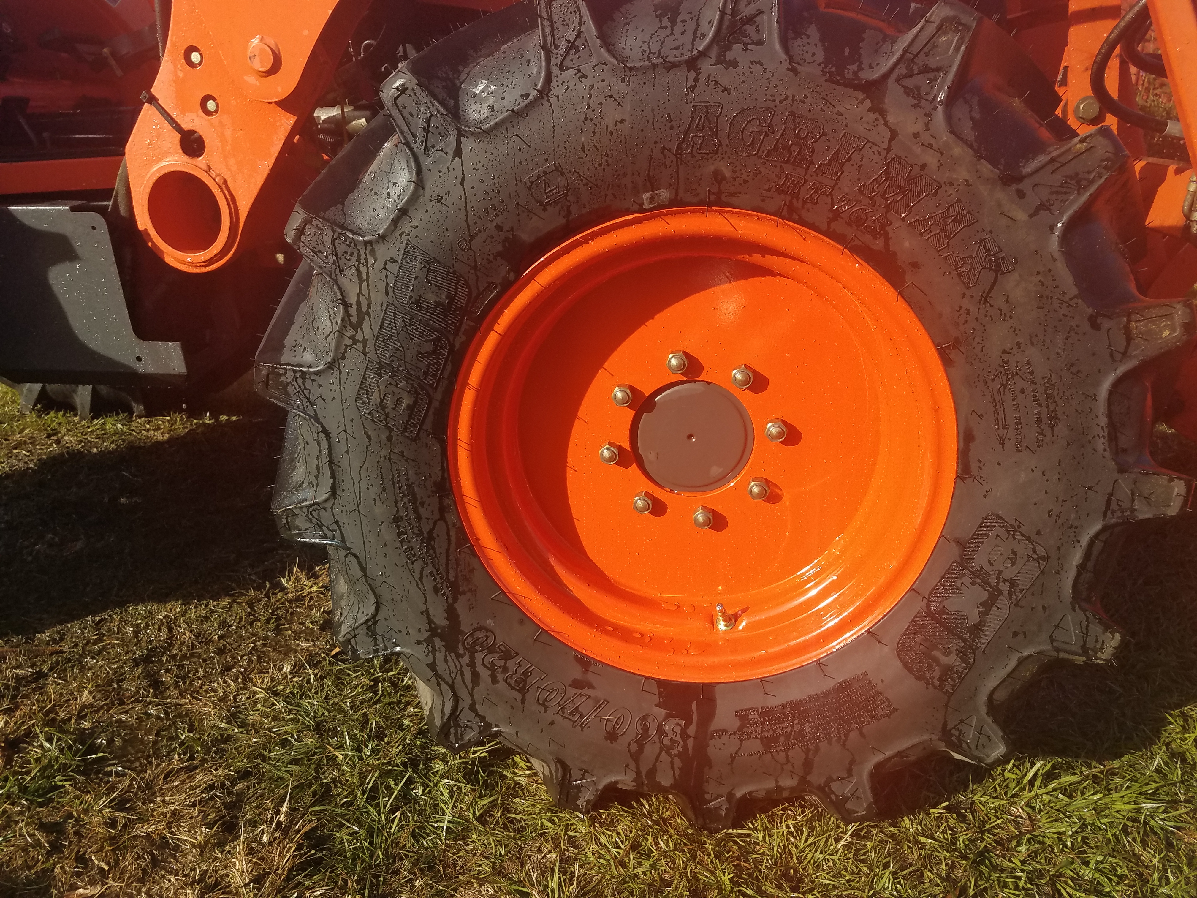

Here are a few pics. First time uploading, hope it works. Talk to Mr. Ed at e.d.Miller tire and he can set you up. Happy Thanksgiving!:turkey::turkey:
   / Wider front tires M7040 Kubota #48
Nice!!! Can you take a shot from the front showing the front and rear tires to get a good comparison.
What size are these tires?
Thanks for the pics!!!!
