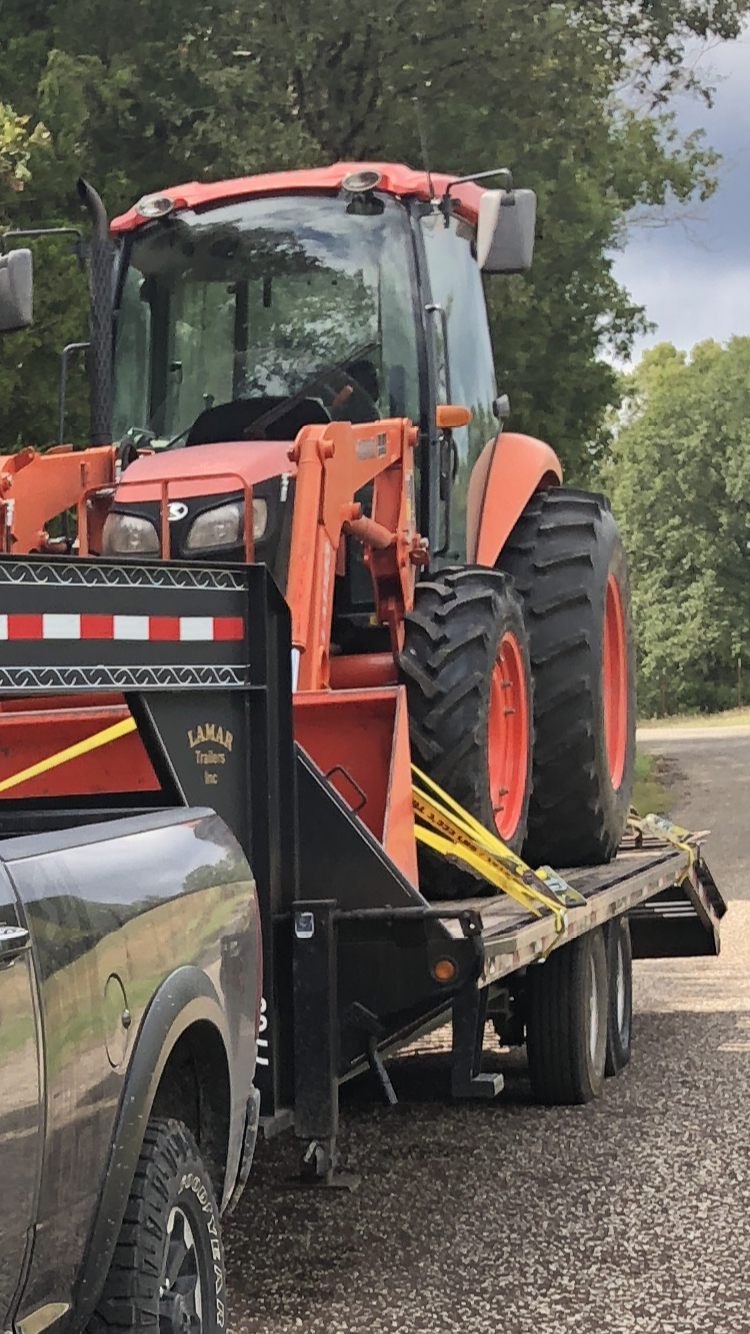

I ordered my tractor with cast tears and radials. It was a $1600 upcharge. I really like them. Traction is great and floatation on soft ground is awesome. IMG_2151.JPG
