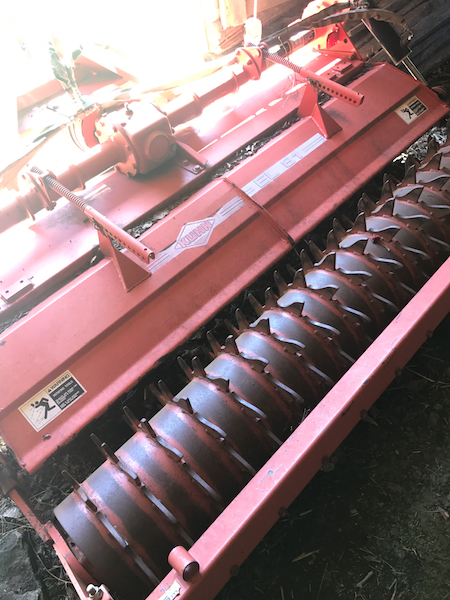

Will this thing work? A neighbor owns it. It's a rototiller but on the back are some monster spike like blades sticking out of what looks like a segmented roller. Couldn't find much on it on the web. It's a Kuhn EL 81. Is this a "Cultivator"? It's got hydraulic cylinders on the roller thing to lift it.

The roller is to firm up the bed prior to seeding. If the seedbed is too soft, the seeds won't germinate well. The 'spiked roller' is basically a 'cultipacker' attached to the rototiller. If you have enough HP, that setup just might work. Take it slow, and let the tines really chew up the sod. The cultipacker will just firm up the 'soft fluff' you are creating by going slow with the tiller. It is a good thing.
Try it and see what happens. If the rocks are bogging you down, or you aren't getting the results you desire, I would NOT press on with the tiller. But if things are giving you what you want, get after it. BUT... have a plan on how you are going to seed and with what, FIRST. If you till your pasture, then leave it for any significant length of time, you will have an eroded field of weeds before you get the tiller off. Line up your drill or broadcast spreader, or whatever. Make sure you have purchased your seed. Then get after it. If it doesn't work, just look to borrow a plow. That will work for sure.
