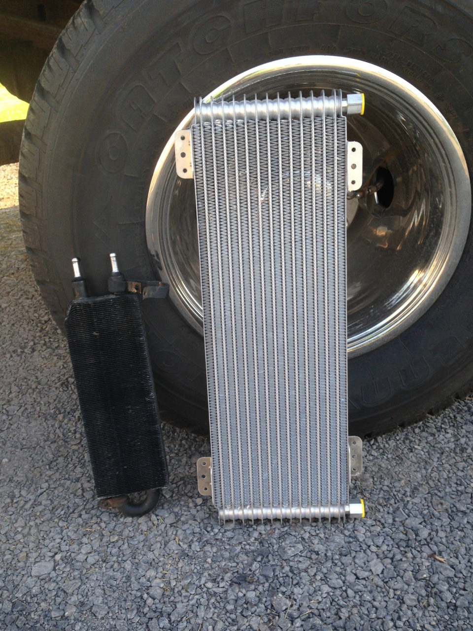

Todd - That seems to be a good less expensive option. I read somewhere that the OEM cooler is made by Tru-Cool, but who knows if that is true or not. Since Tru-Cool is made in Canada I would say it is as the OEM is stamped as made in Canada too.
I installed an OEM 6.0 PSD 26 row cooler last weekend. My local Ford dealer matched an online price I gave him so it I didn't pay full retail, but it was still a little over twice as much as the one you found. If the one in the picture is the actual cooler, the OEM one I installed is almost twice as tall, which reduces the price sting a little bit. (EDIT: I JUST CHECKED THE DIMENSIONS AND THE DIESEL SITE ONE IS INDEED ABOUT 1/2 THE HEIGHT. IT HAS 13 PLATES VS. 26 ON THE 6.0 VERSION.)
I haven't tested it under a heavy load but driving around yesterday in the 85 degree heat the tranny never got above 150, and that includes climbing the 600 foot hill to my house.

Just ordered the Tru Cool Max. For the money I thought I'd give it a shot. Will report back someday when it's installed if this thread isn't buried 15 pages deep.

Installed the Tru Cool Max this morning. Here's a little side by side comparison of the stock cooler and the new one:
