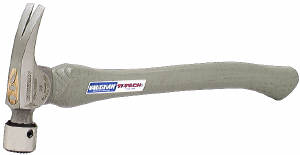

Dick and or Jane could easily use successfully
Pat: Dick and Janes solution!:D
