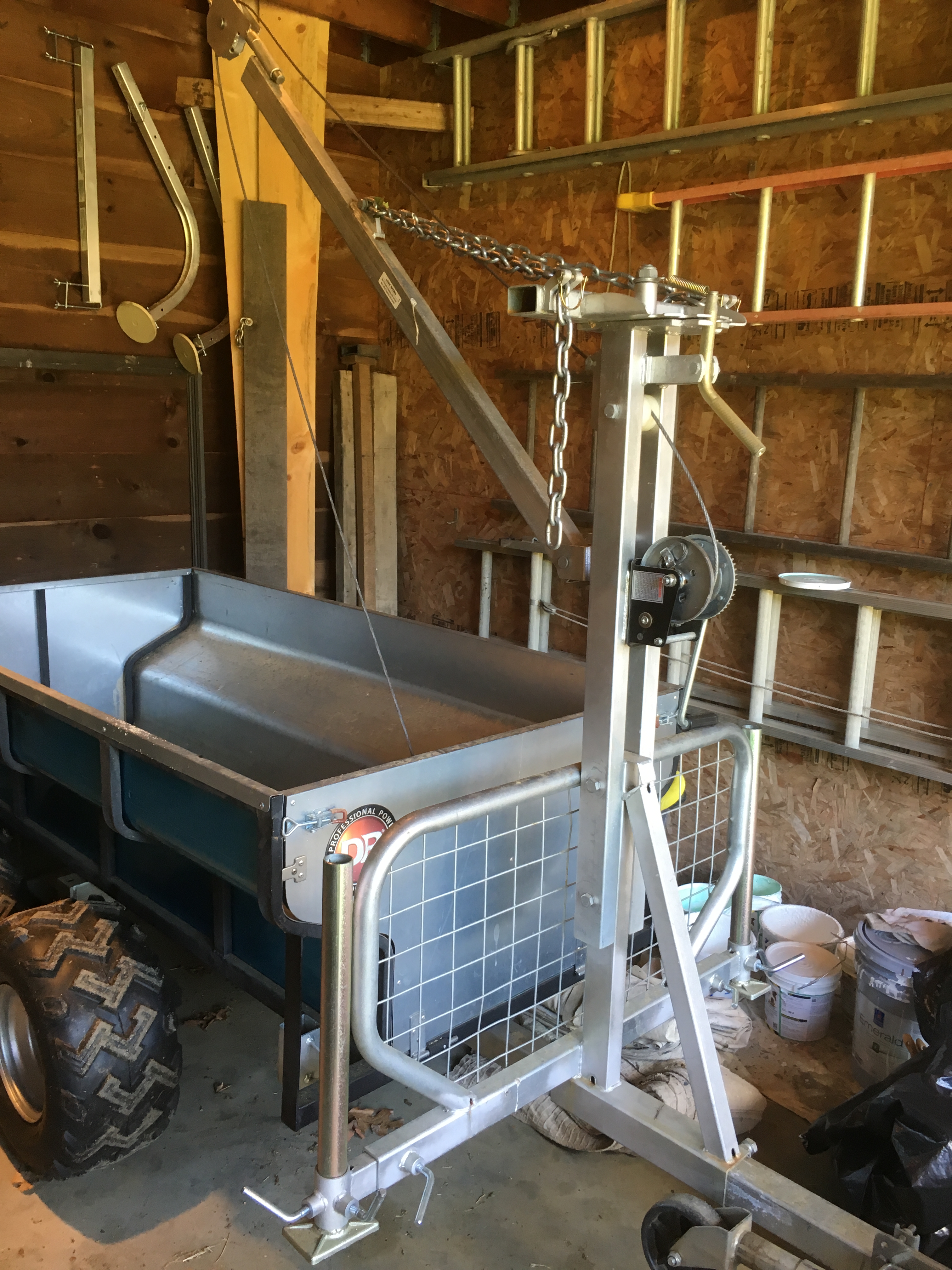

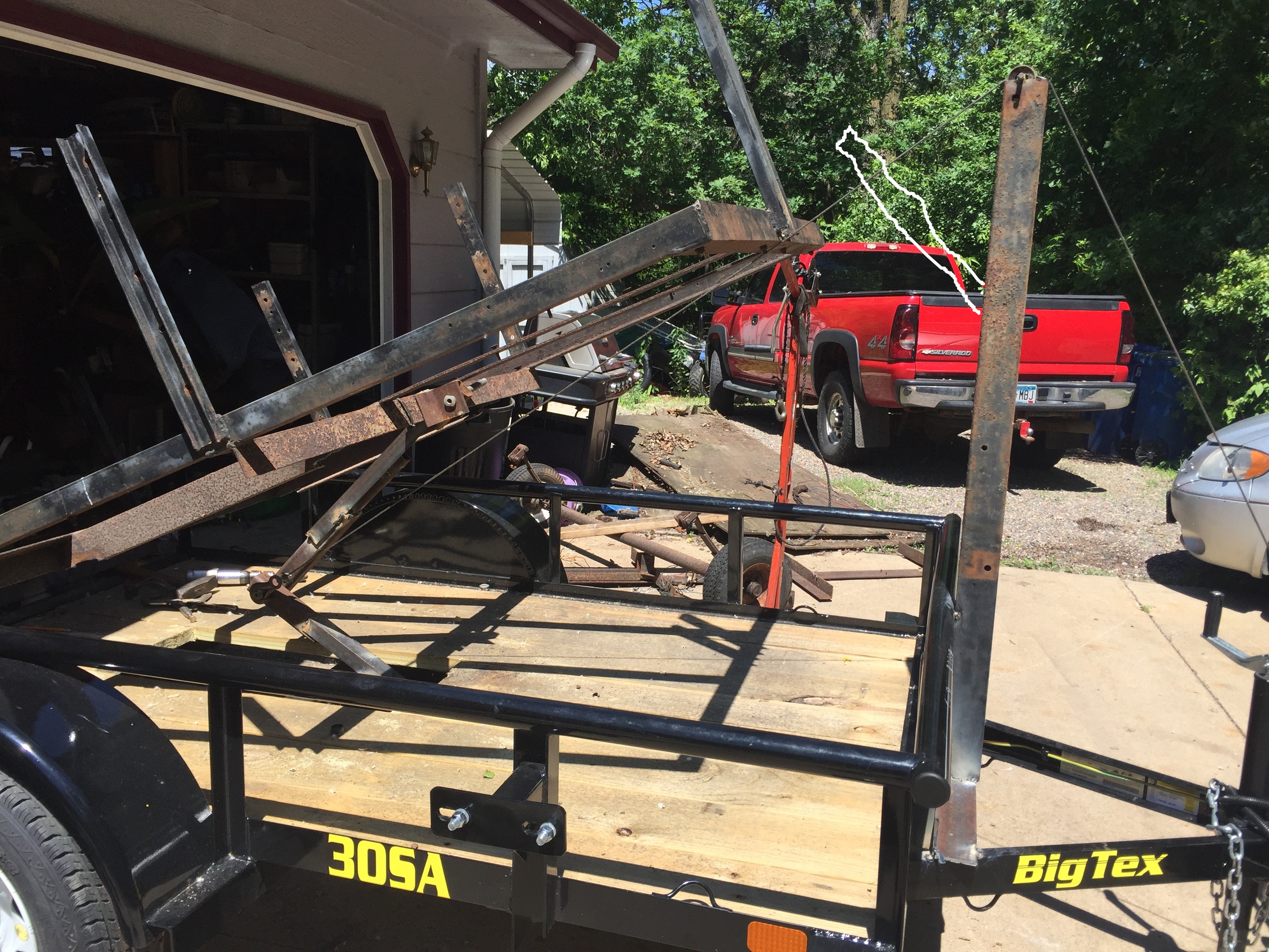

Lots of great info and suggestions here guys, thank you. I wish I had started with 2x4 wood for the arms when I was trying to figure out lengths.
Here is we're I'm at with this as of today. You have to remember I wanted something lite that t I could pull around my yard with my atv as well as being hyway ready, also really hopped it could haul 1 yard of rock or gravel. (Tall order for a 3000lb trailer).
Anyways, here is we're I'm at. I went all out with the first test, it's about .8 of a yard of mixed gravel. Honestly I was pretty nervous something was going to let go but t held up fine!
big tex 5x8 into Homemade light weight winch dump tip trailer - YouTube
/ Winch dump trailer build #22
Nice, looks like you have that folding arm geometry figured out, that dump should come in handy a lot.

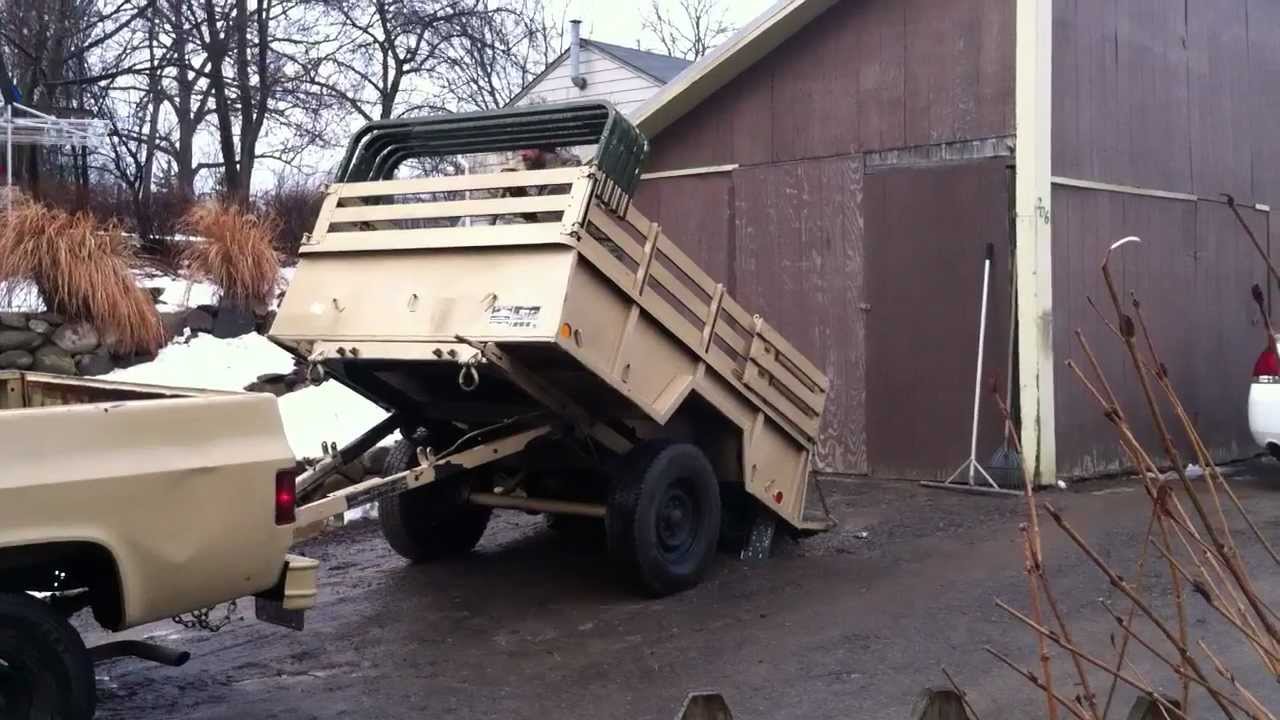

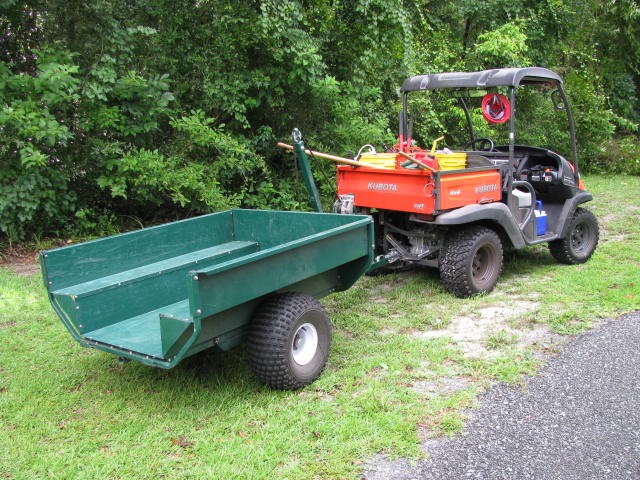

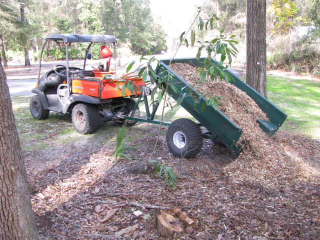

My self made dump trailer measures 5 x 9 and has stake pockets.
The "Hinge" is the trailer axle wheel bearings.
I modified a camper jack to raise the bed for tilt.
Works well but I cannot go vertical for two reasons...
1. The rear overhang will hit the ground at about 50 degrees
2. The camper jack has limited lift range.

:thumbsup:Congratulations! I like how you stuck with it until you figured it out.
As long as you can dump out gravel/dirt, I'd still call it a success. When you get a change grab a pic of that folding lift arm, I might want to make something like your trailer sometime.
