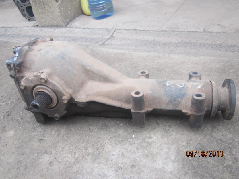

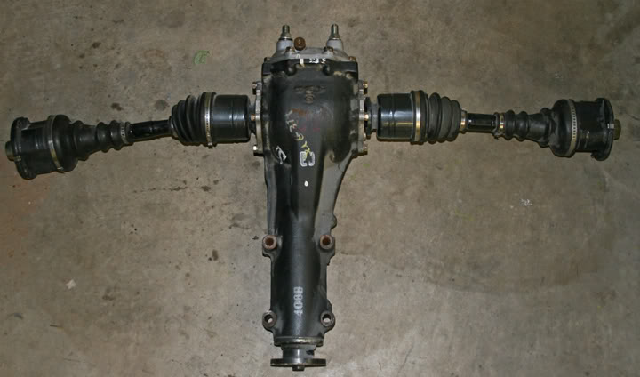

Is there a common (cheap) independent rear suspension differential that would work without all the modifications needed to use a rigid drive axle?
Subaru comes to mind.
diff1.jpg 1380789697_551128825_2-Pictures-of--Subaru-rear-differential-unit.jpg
What else?
View attachment 371002 View attachment 371003
What else?
Bruce
If one were out "scrounging" Be sure to take along the drive shaft and both half shafts! Save a trip for the required spline fittings. That is why I suggested the BMW or the AUDI rear ends. Bolt on flanges! I'm sure there are others, but I'm not a car guy....

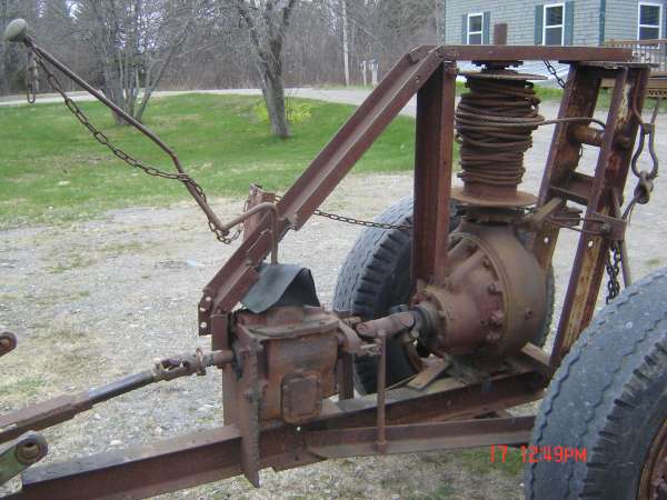

They used a cable drum and brake drum mounted on a shaft, the brake drum had a large sprocket mounted on it that was driven by a pto chain drive. To engage the winch, there was a master cylinder and brake line connected to the wheel cylinder in the brake drum that when depressed, it would engage the brake shoes to the drum and make the cable drum rotate.
There are basic plans for a winch similar to this in "The Lincoln Stabilizer" (No2 Vol31) 1962. The main difference being , two brake drums are used, one for the drive and one as a brake.
If anyone would like a photo copy of this design + some others, let me know.
   / Winch from rear end #38

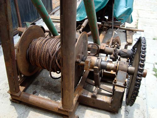

We used to own a BigStick and later a Kennemer wood loader. I dont remember which one it was, but one did have brake drums on each end and the other used a wide brake band on one end like was used on some of the older trucks as a drive shaft emergency brake. If i remember correctly, the one with the emergency brake band worked better because you could adjust the tension so that the cable didnt free spool when you where pulling it off the drum.
I tried searching for plans of one of those winches about a year ago, but didnt find anything. I have the design in my head. I had to work on ours so many times, I can still see it in my mind.
They are pretty simply. The cable spool in mounted on a shaft and is supported on each end with pillow block bearing. On one side of the spool, it had a large dia, looked like pipe, welded to it. The pipe like piece had a brake band wrapped around it and a cable to pull it tight to act as a brake. The other end of the shaft was machined to accept a front hub and brake drum off a car or truck. The brake backing plate was welded to the shaft. A hole was center drilled and cross drilled to add a line for the brake line from the shaft to the wheel cylinder on the backing plate. The end of the shaft had a swivel fitting to attach the brake line from a master cylinder that was lever actuated. The hub had a sprocket attached using the wheel studs. A roller chain was used to connect the winch sprocket to another sprocket on a shaft ran off the truck pto. I dont remember the gear ratio of the sprockets, but the one on the brake drum was at least as large as the brake drum dia. When the pto was engaged, the brake drum turned continuous with the cable spool remaining stationary. Whenever the brake master cylinder was depressed, the brake shoes would contact the brake drum and turn the cable spool. The cable spools where large enough to hold 200ft of 3/8 cable.

I think this is close to what mudstopper described as the BigStick?
   / Winch from rear end #40
In the first photo in my post 37 above, that is what they did, but it is hard to see.
