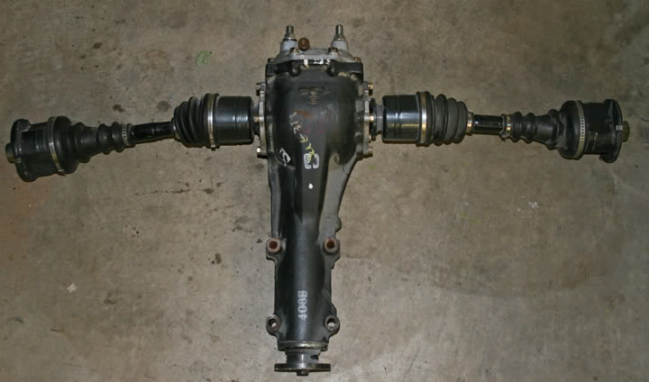

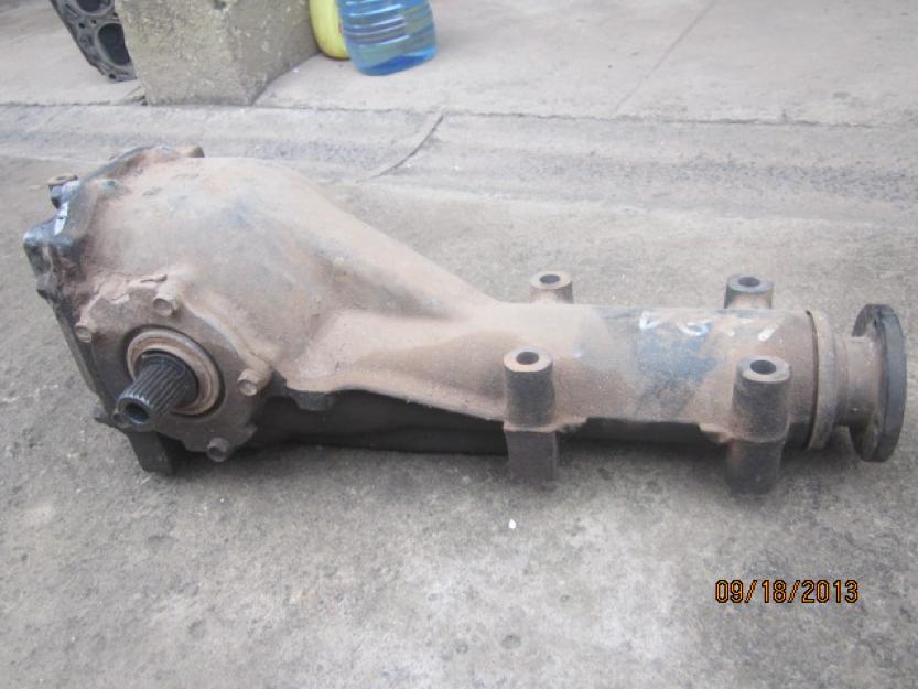

Is there a common (cheap) independent rear suspension differential that would work without all the modifications needed to use a rigid drive axle?
Subaru comes to mind.
diff1.jpg 1380789697_551128825_2-Pictures-of--Subaru-rear-differential-unit.jpg
What else?
View attachment 371002 View attachment 371003
What else?
Bruce
If one were out "scrounging" Be sure to take along the drive shaft and both half shafts! Save a trip for the required spline fittings. That is why I suggested the BMW or the AUDI rear ends. Bolt on flanges! I'm sure there are others, but I'm not a car guy....
