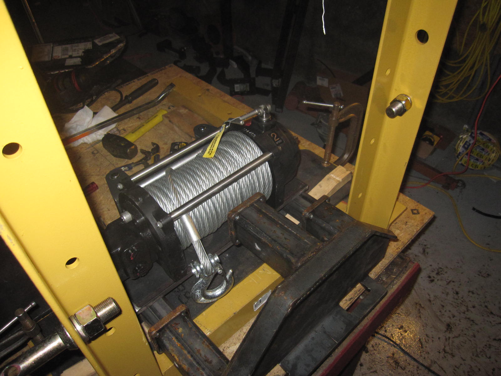

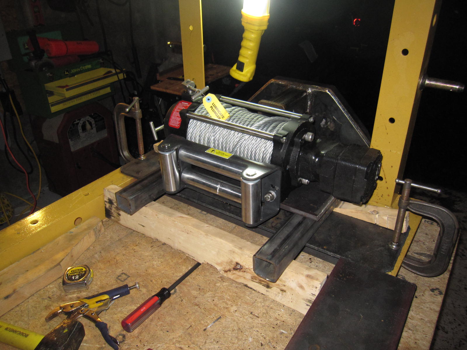

Looks like I figured out the picture thing. These are construction pics but also show the double receivers on the back of the 425 where the winch attaches. Its a heavy duty winch with nice features.

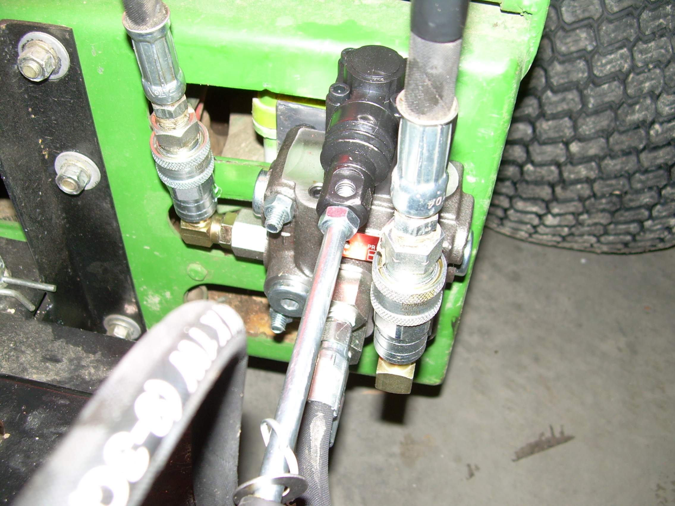

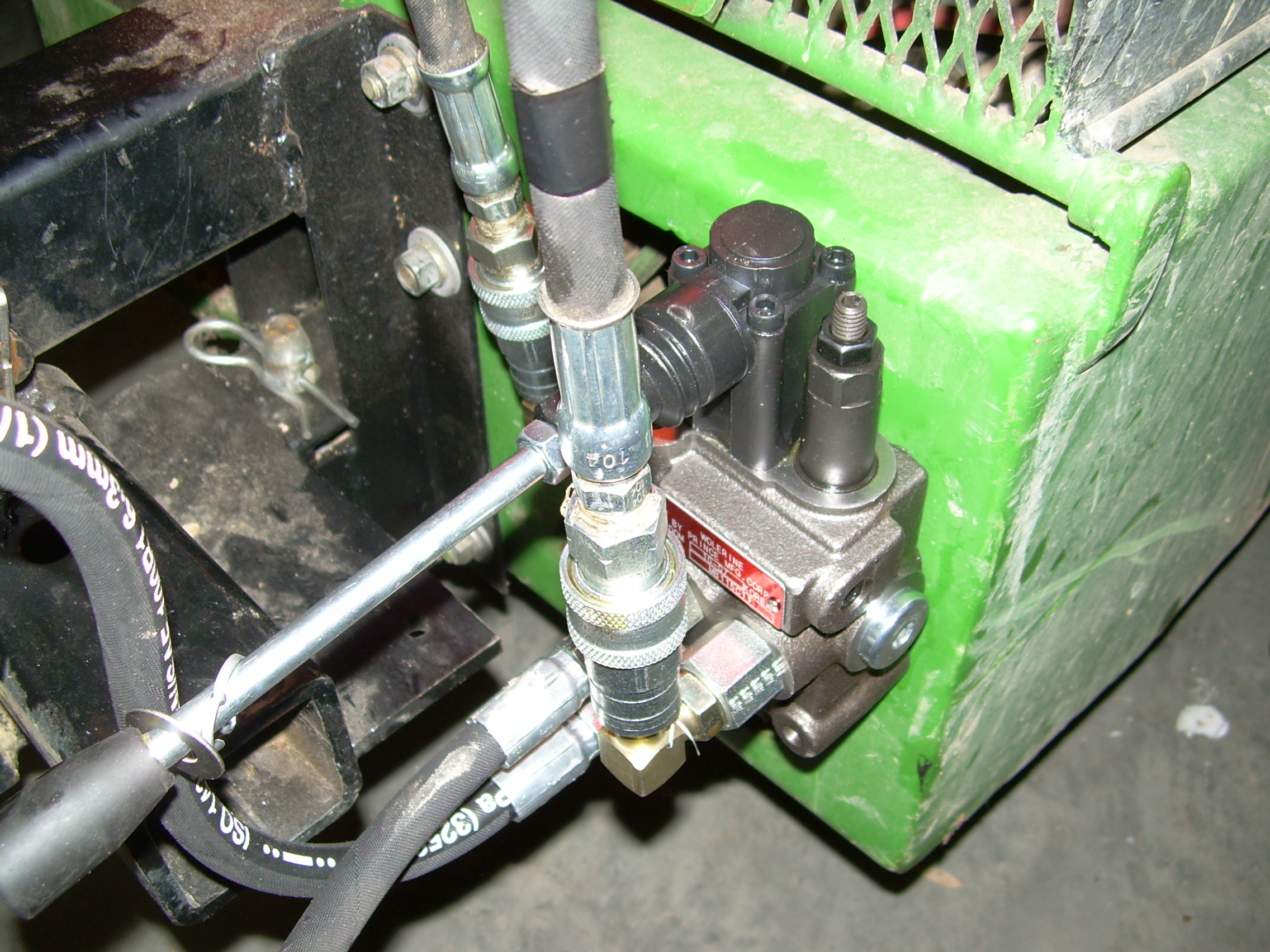

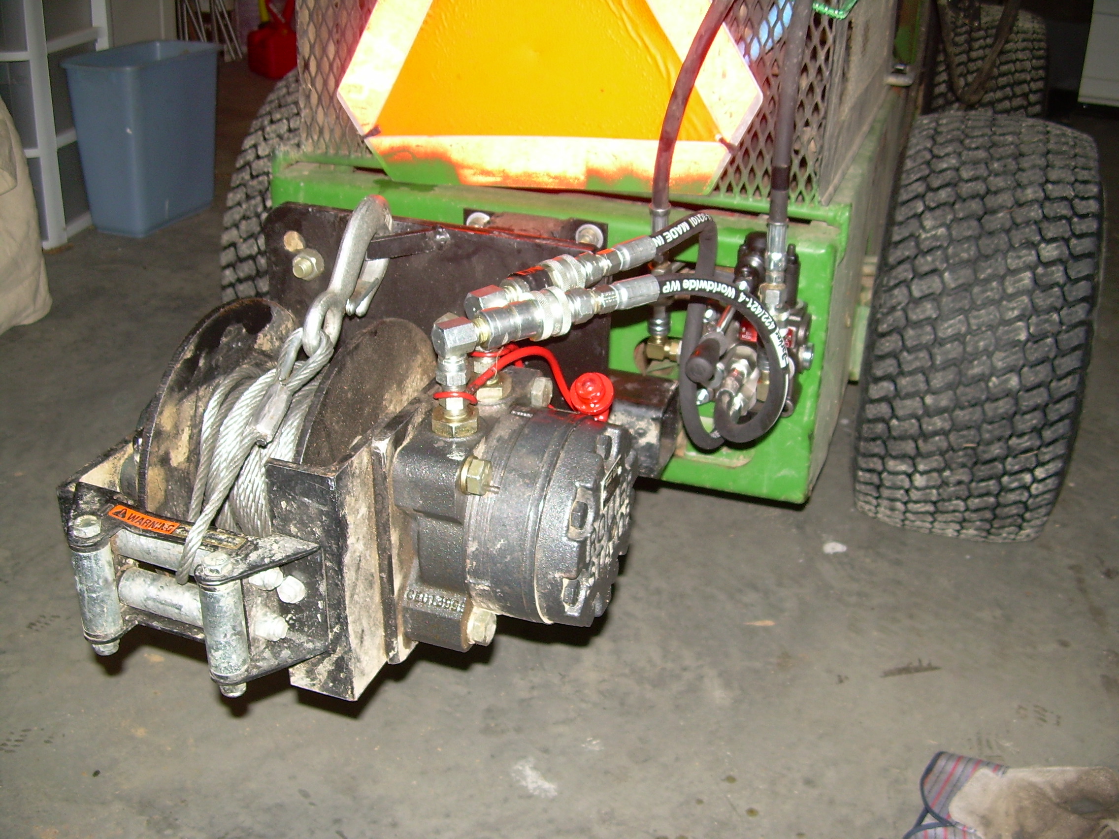

I added the valve today. It seems to work fine. I can control the winch from the drivers seat or from the back. I have to lock on the valve that I am not using.
The valve has quick connects on it so I can take it out of line if I like. It is bolted to the back of the PT.
The valve is spring return to off from both directions. I would like it to lock in one direction and spring return in the other. You can take the spring out, but it has no detent and can easily move to the other positions. This sounds very dangerous. I wander if I can get a kit to modify the valve. Of course the spring return to center is probably the safest way.
I have attached pictures of the installation. The valve drawing is too large to upload.

   / Winch Modifications #99
Bob,
Are you using the PTO hyd's or the Quick Attach circuit hyd for the winch?
   / Winch Modifications #100
Bob
Thats a neat installation and will be really versatile. Very nice job Bob.:thumbsup:
Its great having a winch in the front or back. I use the small grapple boom on the back to load the heavy winch assembly up to slide onto the receivers so I don't have to lift it with my back. these things are heavy. Watch for the cable/choker slinging back at you under load if you are standing next to the winch.
