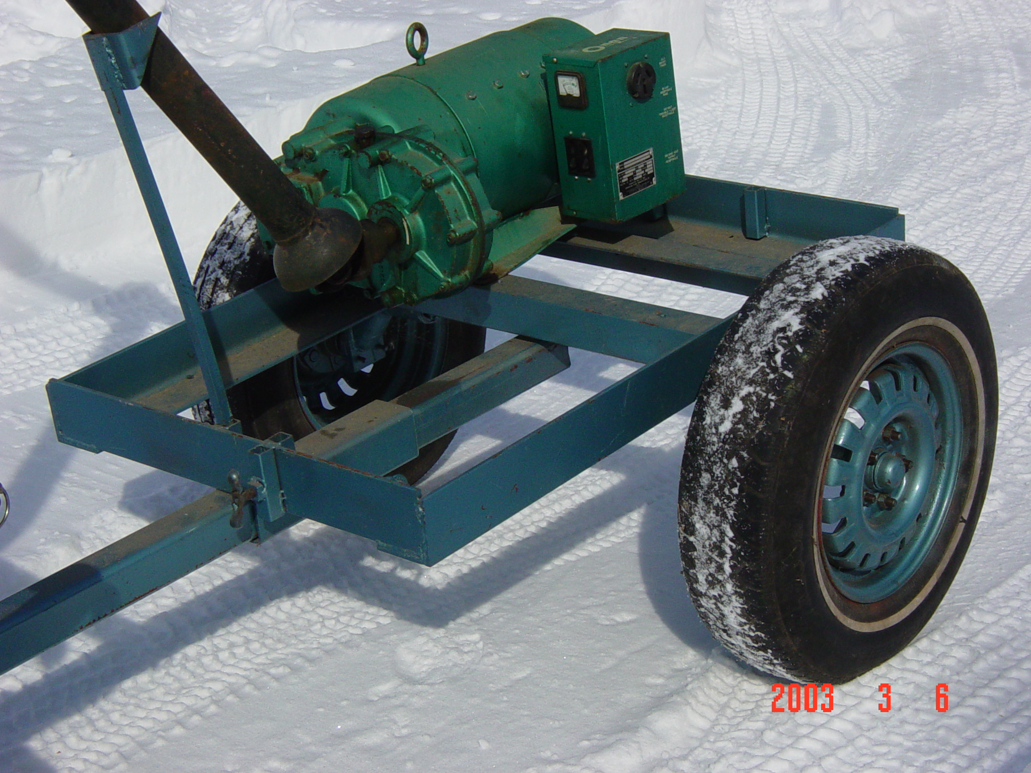

I had a 25KW Katolight I picked up for $300-350 on a trailer... pretty nice trailer with an adjustable tongue, real clean 1800RPM Made in USA generator. Found I would rather put the 7kw generator on and not worry about running the tractor balls out the whole time, the exposed driveline, etc. despite not being able to use the stove or AC. Ended up selling it and made some decent cash. Before I would put out thousands for a new PTO generator, I would look at a used diesel or propane/nat gas generator set.

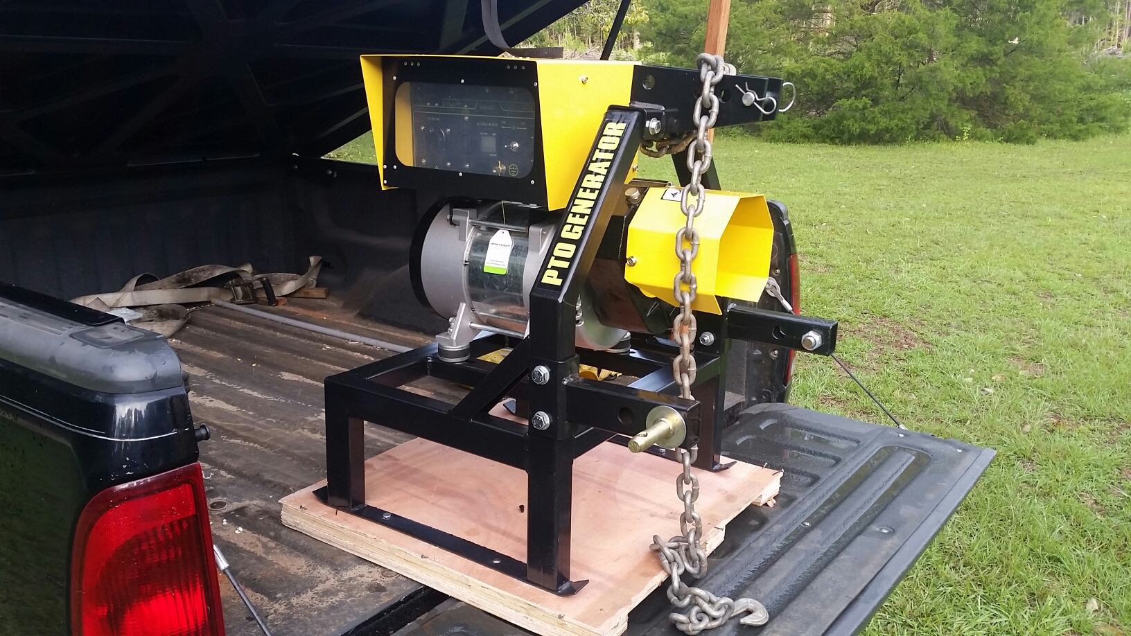

I just purchased a 15,000 watt made in china pto generator from Agri Supply for 1295.
Been running it for a while off and on today. It's all my little 855 can handle when I use the hot water heater. I leave all the 120 circuits on and alternate any 240 demands.

The 855 is 24 hp engine with 19 hp pto. All I can say is with the water heater on it just will maintain 60 hz.
/ Winco PTO Generator #28
IIRC, an electric water heater element is either 3500 or 4500 watts,,,
most generators make that much with, what,, ~8HP,,, ??:confused:
Maybe your heater is wired to power both elements at the same time?
I know only one of my elements can come on at a time,,,
Possibly there is a defect in the upper thermostat?

Could be any combination of reasons. The least of which is the fact this is a cheap Chinese gen.
My water heater is an old 50 gal Rheem with two 4500 w elements running on a 30 amp breaker. I imagine they both run till it reaches temp.
I purchased and connected the day after the hurricane so all proper supplies were bought out. I had to rig it and back feed through the 30 amp dryer circuit.. Will get a proper switch mounted when parts are available. In the meantime I have to keep the main breaker manually turned off while connected and running.
Either way my 19 pto hp is undersize for this unit so power will be limited.
