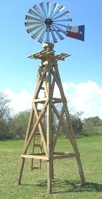

Went today to pickup a windmill kit. The head is from http://windsco.com and it was already assembled by a local dealer. He was trying to get out of the business and had a 5' headkit marked at 40% original cost. I think he was wanting to make some space, seeing as he is moving within the next month. Anyhow, the kit came with a set of detailed, step-by-step instructions on assembling a wooden tower. Mine will be 20' in height when the project is complete. Now, I've got to dig a footing or pad and buy the lumber. Stay tuned for coming pictures. Here are a few from the mfc website.

Rx, maybe you could explain something to me.
In the 2 pictures you posted from Windsco, on one head the tail fin is straight out the back and on the other it looks to be sideways.
Are my eyes playing tricks on me ?

After talking with the guy, i asked the same thing. He said it can go either way, depending on preference. However, he did point out that straight out allows the fan to spin much faster and is not a good idea in real windy locations. I clearly need it angled here in Oklahoma.

Windmills used to have a chain you could pull to shut them down. It would pull the tail sideways, locking the wheel so it wouldn't turn, & not pump water if you didn't need it. Or shut it down in a storm so it didn't "run away".

I was kinda thinking it had something to do with speed control.
I wonder if any vary the amount of angle themselves, like a built in governor of sorts.

Don't know about the Windsco brand, but the old time windmills had a lever that turned the tail fin to the side to stop rotation. Did not alway stop the mill dead still but actually worked pretty good. For the most part the ones that were out in the pastures were just set to run all the time with an overflow on the tanks.

I need to clarify something, this is not a "pumping" windmill. I just wanted one strictly for ambience & looks only. However, i believe you are right in that you could lock down the wheel on the Aeromotor designs. Truth be known, i probably could fabricate something to swap in a fully functioning head should i ever decide to drill a well.

The earlier posters who stated that it was a control mechanism were correct.
The vane is to turn the blades into the wind. So when it is "straight out" it puts the blades into the wind-stream so they can spin with the wind speed. If the lever is adjusted to pull the tail to the side the vane will turn the blades so that the blades are not 90 degrees to the wind but parallel and thus should not spin or at least much. It is basically just a weather-vane for turning the blades to the angle to the wind that is appropriate for what you want. Back in the early 60's we had a working one in SW Kansas and it did not spin at all when the vane was pulled 90 degrees.
/ Windmill plans?? #20
When the tail of a windmill is parallel with the fan, the unit is turned off and does not spin. As the brake adjustment wears in, the fan will still spin a little. As far as furling out of the wind, with an Aermotor windmill, as long as you have the furling spring set as light as it will go, the mill is safe for 100MPH winds. My 12 footer has seen 80MPH + and has held up fine for the last 12 years. ;)
