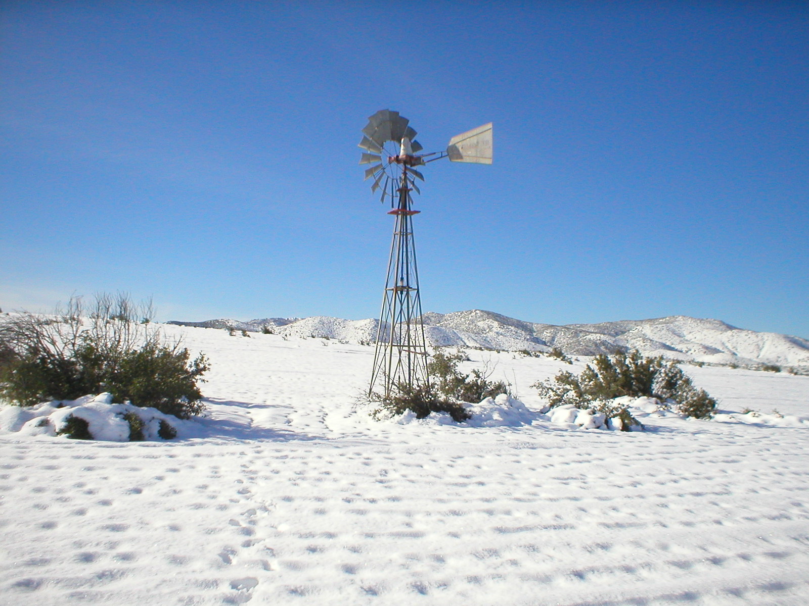

I anchor my towers with angle irons which have some cross girts bolted to them at their bottom. The secret to lining all this up is to stand the tower up in position while supported a few inches above the ground using cement blocks or stacks of 2 x 6 pieces. Level the tower out so it is square to the ground line. Then I take a hand post hole digger and drill straight down directly from the corner posts. Go as far as you like. Then I fill the holes with mixed concrete and push in the angle irons. Then attach them to the tower legs with bolts. All this is done while the cement is still wet and flowable. After a few days, remove the support blocks and you have a sturdy, square, durable, and strong installation. Since pushing a tower over requires the legs to go outward as much as upward, the outward component of the leg foundation needs to be pretty well packed dirt. All my mills use about three 80 lb bags of cement per leg. Its the just-add-water fast harden stuff from Home Depot, etc. Lining the leg pins up while the cement is still wet saves you an awful lot of grief. I don't use (or recommend) the round ground pillar forms, either. I want good grip to the soil.
/ Windmill plans??
#43
Wow, nice looking windmill. Thanks for the recommendation and pic.

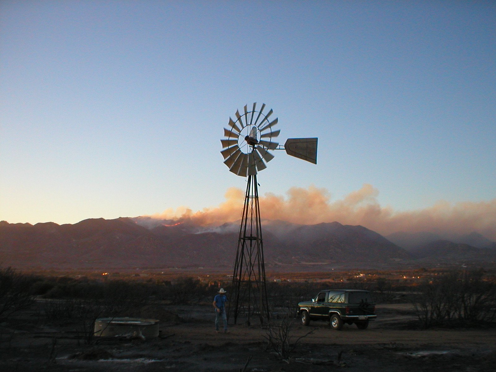

Here is the finished project. I chose to position the tail fin straight back and it worked fine for 4-5 months in oklahoma winds. However I think the bearing on the actial head didnt get paclked with grease well enough and it started to squeal. (adds character right) That lasted for a day or two then it ground to a halt entirely. In hind sight I should have made the service ladder a bit wider bc my wide shoulders dont allow me to climb it to the service platform.
Thats where my wife comes to my aid. She scurries to the top and help me service it. She spun the tail over to a 80° angle and lube the head bearings. Now it just pivots in the strong winds.
