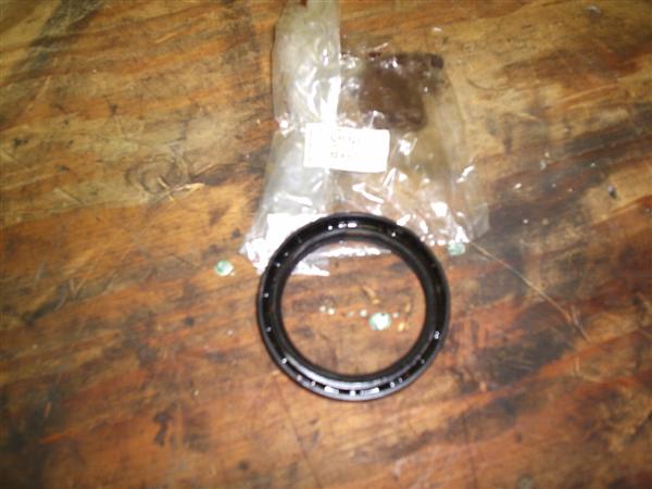

Mine Had two seals , Just thought all of them did.That is good to know if I have to ever do the 1700 . I think the AXle is two peace on it.
The YM1700 won't take as long to do because you don't have to pull the axle. It is a good idea to replace both the seal & the seal collar.

Worked it about 3 hours yesterday moving a pile of dirt at son's house. Don't see any leaks yet. Hopefully a successful repair.

Here is a picture of the axle seal.

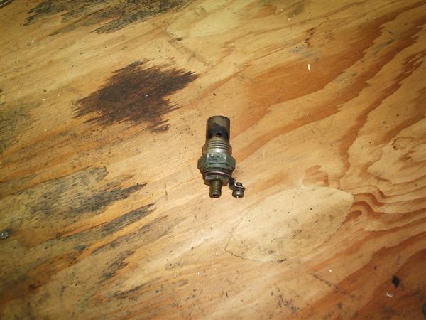

Also the Thermostart glow plug was burned out. Replaced it.
