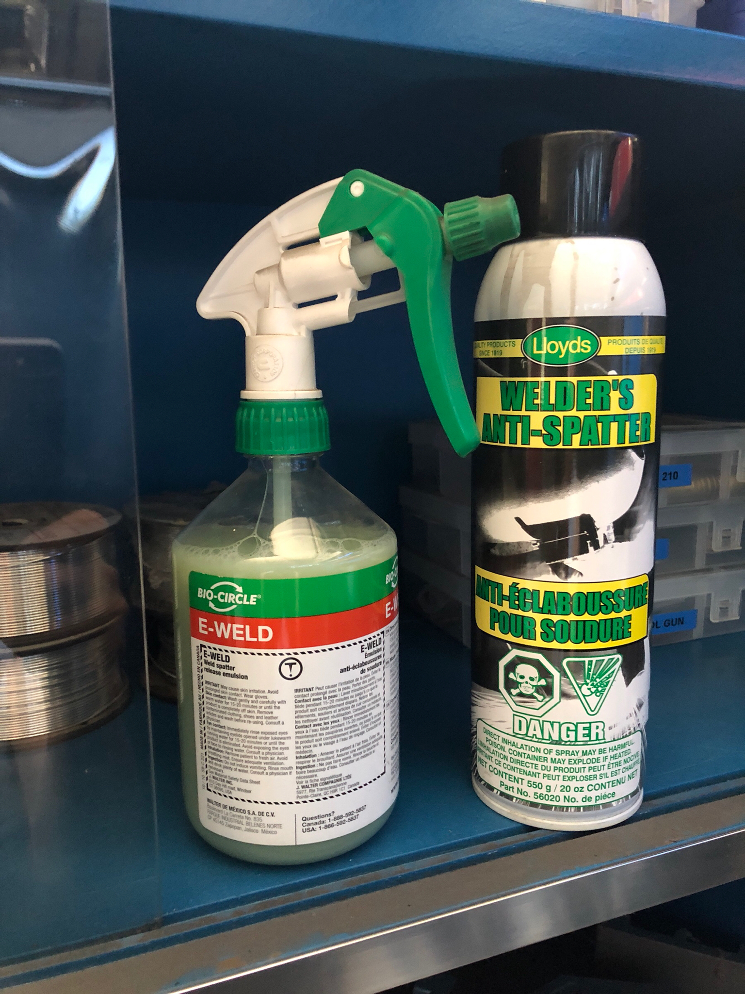

Anti splatter spray, not sure if it reduces splattter or stops it sticking.
s
Anti spatter spray prevents spatter from sticking.
I like the one on the left the best.
