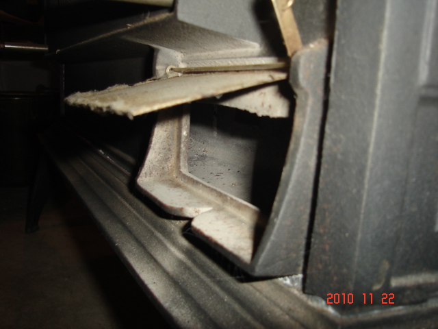

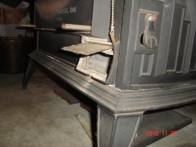

   / Wood Stove Rebuild #49
You might also take a peek, with a strong flashlight, into the thermostatically-controlled air damper at the rear.... there's a LOT of fine ash that will fall into that horizontal air passage at the rear of the stove by passing through the vent holes at the bottom of the burn box from the inside.
I've found mine will not draw well if there's a collection of ash in there; vacuuming it out makes a big difference. (TIP: I made a small scraper to reach in and pull out as much ash as I can that way first, then vaccum out the remainder- that stuff will plug a vacuum bag in a hurry!)
