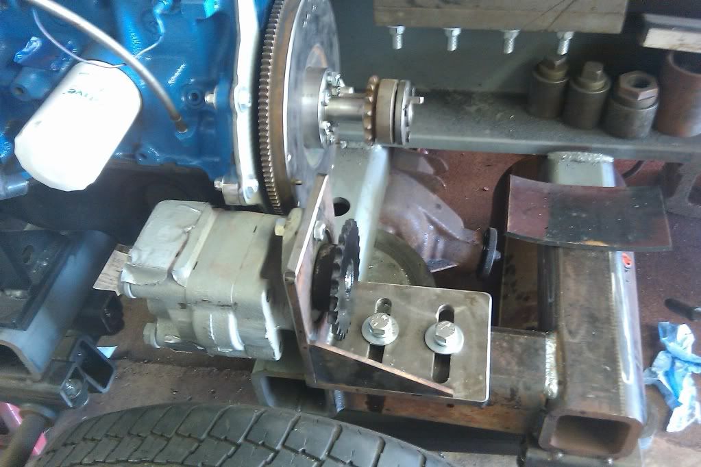

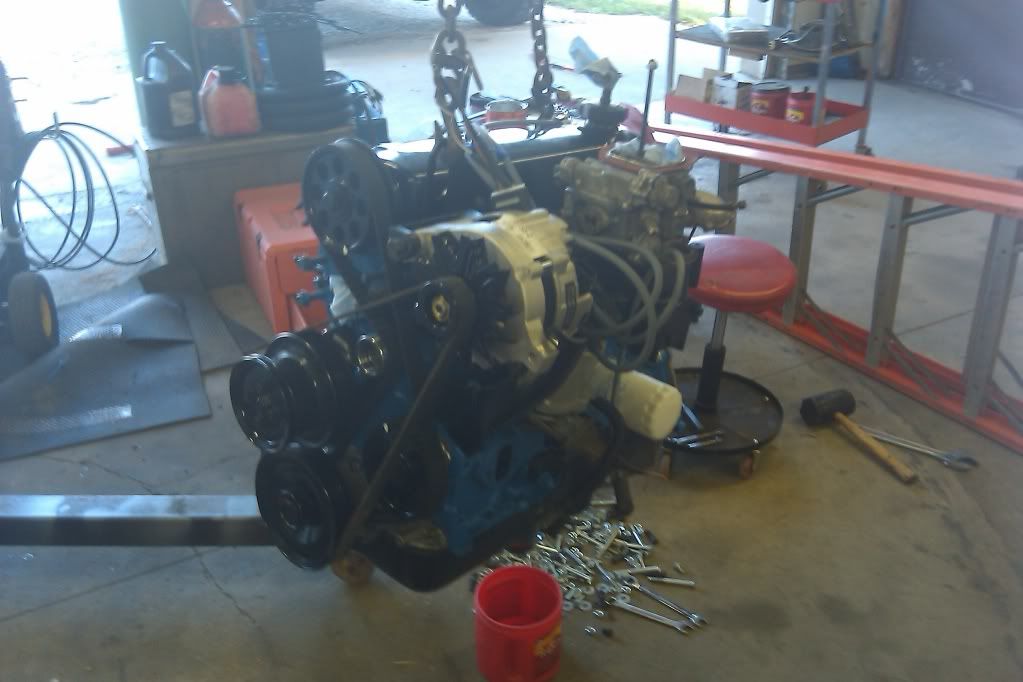

So I have been following this form for a month or so and I want to say very cool stuff you guys.. everyone seems to genuinely want to help and not criticize to much ... so I have been building my own log splitter for about a year now . I am getting close to trying it out maybe next month. So I thought I would post up a few pics of various stages of my build. Yes it is a bit over kill , but I have bought 2 factory units and destroyed them both in 3 years .so I only want to do this once.

I should probably say that its built from mostly items that people where discarding. So I would get a item and then build around it.
The motor is a Ford 2.0 that had a hole burned in the # 4 piston.
The axles are Ford 7.5 's
The pump is old but never been used from a forklift repair shop i got one and they gave me a second still In boxes .
I built the hyd/gasoline tank my first one. Psi checked it ( I hope it doesn't leak )
It has air ride bags from a semi trailer. And air tank.
I am working on the load table and hitch now. Going to add a six way wedge to it ( maybe)

What kind of pressure and GPM's are you getting out of your pump?
Also, what kind of cycle time do you estimate?
I, too, vote for some video once the 'beast' is alive and devouring all of those defenseless wood chunks. :D

Looks cool! I'm curious what size chain will be used on that pump drive?

tell you the truth Idk . Fast I hope . I am having trouble finding info on my pump its a commercial intertec for a hyster forklift its old but in new shape and I have a spare so I hope it works . I am shooting for 2200 psi and 24 gpm . I will definitely have video and pics and a party when its done . It's gotten pushed back a few more days this week as I am doing a large clearing job , but I'll have a lot of large rounds to split .. I am shooting for November 2010 . Working on the wiring harness and a few odds and ends.

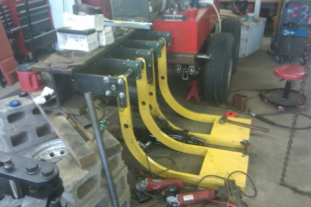

Here are some more pics . The loading arms and a cool
[/IMG]old delta tool box I'm going to mount on the rear. And my big score a hendrickson leveling valve for the air ride.
[/IMG]
[/IMG][/IMG]
[/IMG]
