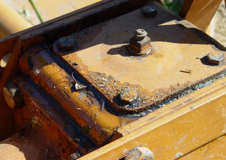

I searched my own posts (how embarrassing /forums/images/graemlins/blush.gif ) and found some pictures from April of 2001 of what I think you are talking about, right?
The bolt that is circled should not be there.
   / Woods gearbox gives out again #52
If the bolt is there, it causes this to flex, as shown by the flaked off paint.

   / Woods gearbox gives out again #57
Mike that bolt isnt supposed to be there. it is restricting your attach point from rotating 360 degrees. when it is hitting the a frame it is causing the flex. yours looks just like mine.
the bolt would go in the hole below where your rotating attach point if you used a quick attach.
take it out and just save it.
I took a sledge and with the cutter raised attached to the tractor straightened my arms. they look fine now.

   / Woods gearbox gives out again #58
Mike i also noticed your gearbox is venting oil. mine has been doing it alot also.
does yours vent alot ?
   / Woods gearbox gives out again #59
<font color="blue">take it out and just save it. </font>
I removed the bolt soon after those pictures were taken, about 2 years ago. Someone probably didn't read the manual, saw the bolt and, since there's no other place that bolt could go, installed it. /forums/images/graemlins/shocked.gif
<font color="blue"> does yours vent alot ? </font>
It hasn't gotten any worse than how it looks in the picture.
