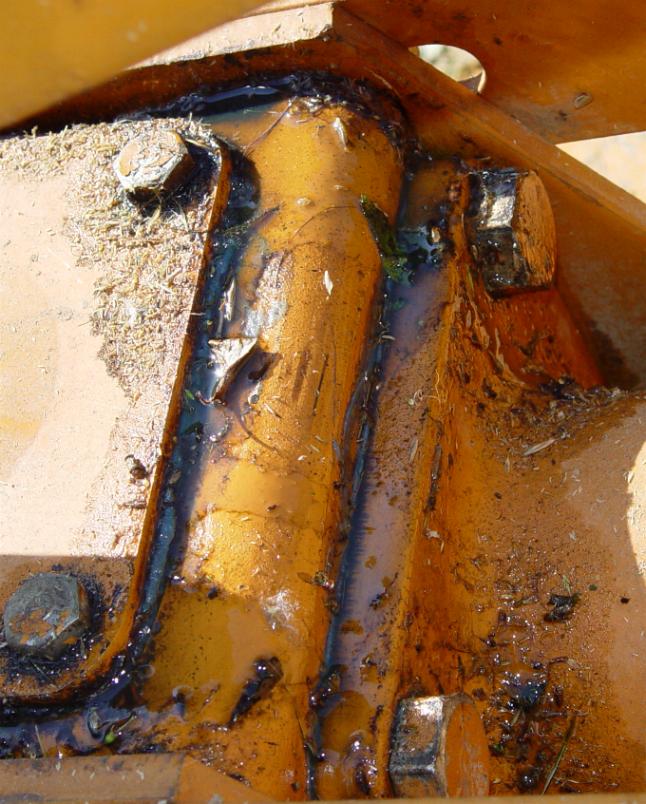

another view

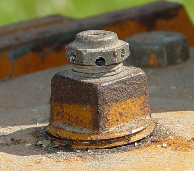

Vent holes

<font color="blue">...oil is to the proper height ... </font>
Hi Robert...
For some reason, it seems there is way too much oil in the gearbox... in order to expand that much...
If the oil is being forced under heat/pressure to do that what you can see on the top of the gearbox...
Imagine, what it is doing to the main seal on the bottom of the gearbox... that you CAN"T SEE... /forums/images/graemlins/crazy.gif
(for a test... I'd remove 1/2 the gearbox oil to allow more room for expansion and run the cutter for the 2 hours or so...)
(your vent with 5 million holes... still appears to be restricted/clogged... I didn't see a speck of oil anywhere released from the vent... remember that oil under intense pressure will take the path of least resistance... it should be pouring out of that vent assy and nowhere else!...I don't believe that's working properly... )

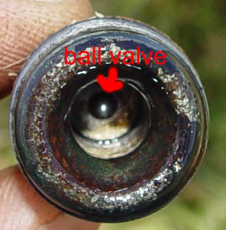

Hi John, the oil is set about halfway up the gears in the box (exactly the way Woods spells out in the Owners manual). The vent plug is completely clear as I had removed it and inspected it when I drilled it out. The oil should be coming out of there but it isn't which baffles me. Right now my father is using the chopper and I am about to head down again to check on it. I will take my camera and take pics of the bottom side of the vent plug. There is a spring and a ball inside the valve but it moves freely as I checked to make sure that was not the problem. I know others have had this same problem as my dealer told me shortly after I bought it that some of the other MD owners drilled out the vent straight down (most likely to remove the ball and give the heat a easier escape out). I don't want to just put a big hole in the top of the gear box though so I will look things over again and let you know what I find. Talk to you again in a few hours. Later.
   / Woods gearbox gives out again
#68
Here is a pic of the vent. You can see the ball valve in the pic. Nothing blocking it. The oil is still down to the correct level and all the bolts are tight. I am still baffled but am getting frustrated with this chopper. I shouldn't have to alter the gearbox design to get it to work properly. /forums/images/graemlins/frown.gif

<font color="blue">...I shouldn't have to alter the gearbox design to get it to work properly.... </font>
I agree Robert... you shouldn't have to be the "test pilot"...
But before we throw in the towel just yet... /forums/images/graemlins/shocked.gif
Remove the entire vent valve assembly... completely... put a piece of masking tape over the hole and punch a hole in it for venting... now take the baby out for a two hour cutting stretch... you better see the gear oil "bubbling" out of that taped hole... and not a single drop oozing from the gearbox gaskets... /forums/images/graemlins/blush.gif
