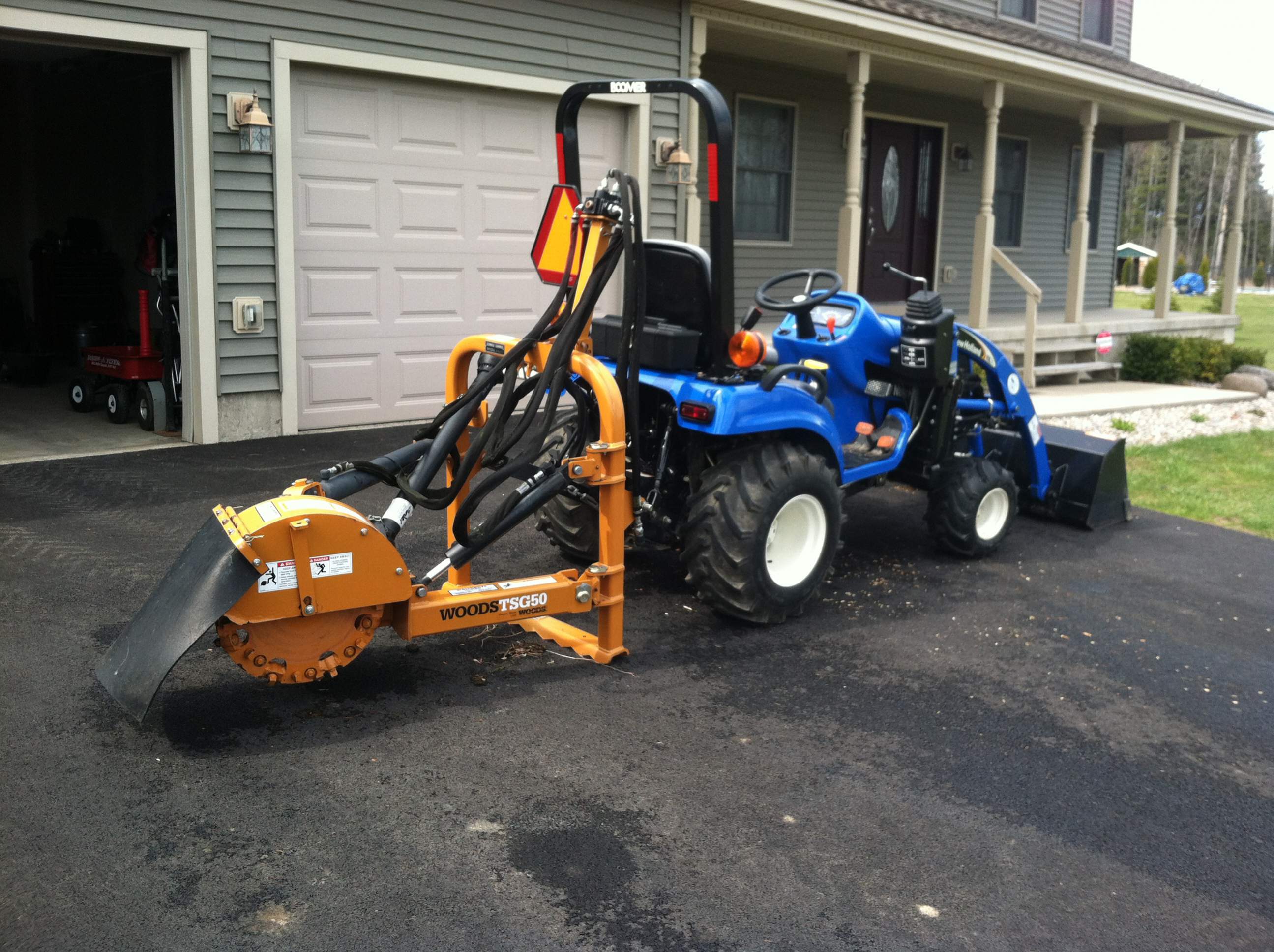

Pictures!!! When I picked it up I was very happy to see it has the control valve. With only one output on my tractor how can I use the control valve?

What do you mean by 'one output' ? Got a pic?
Are you saying you have a remote valve, or power beyond loop for a backhoe?
