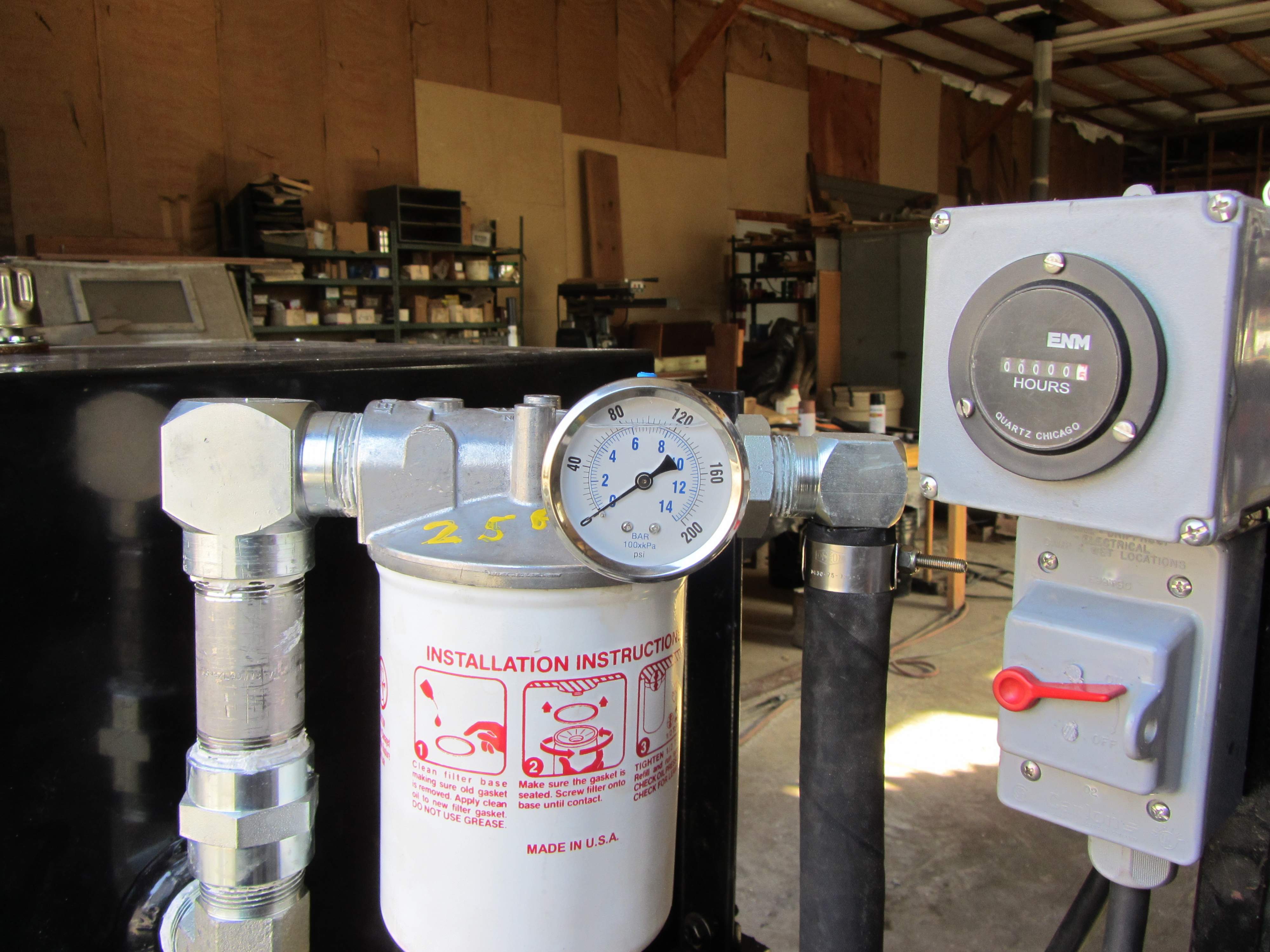

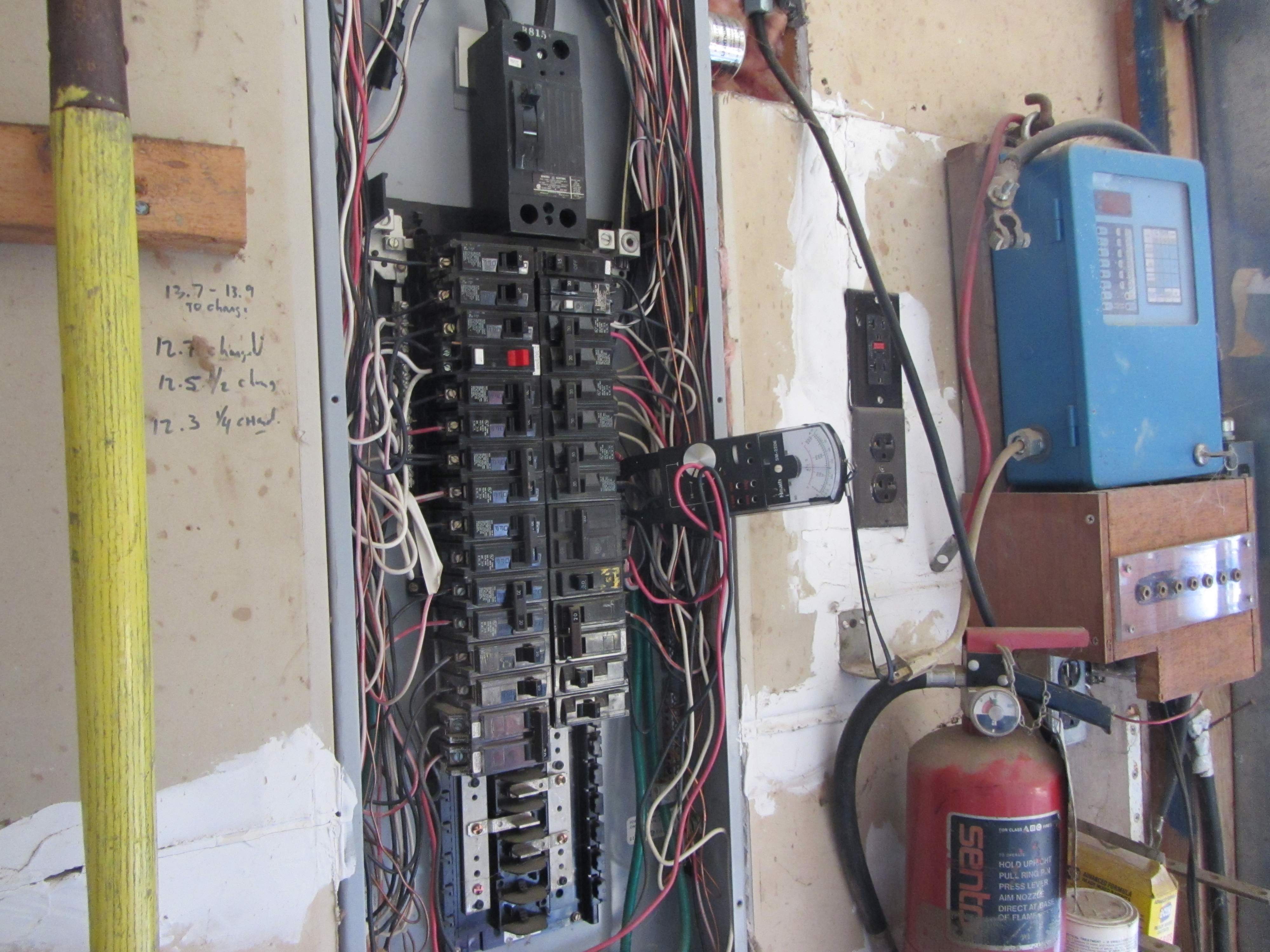

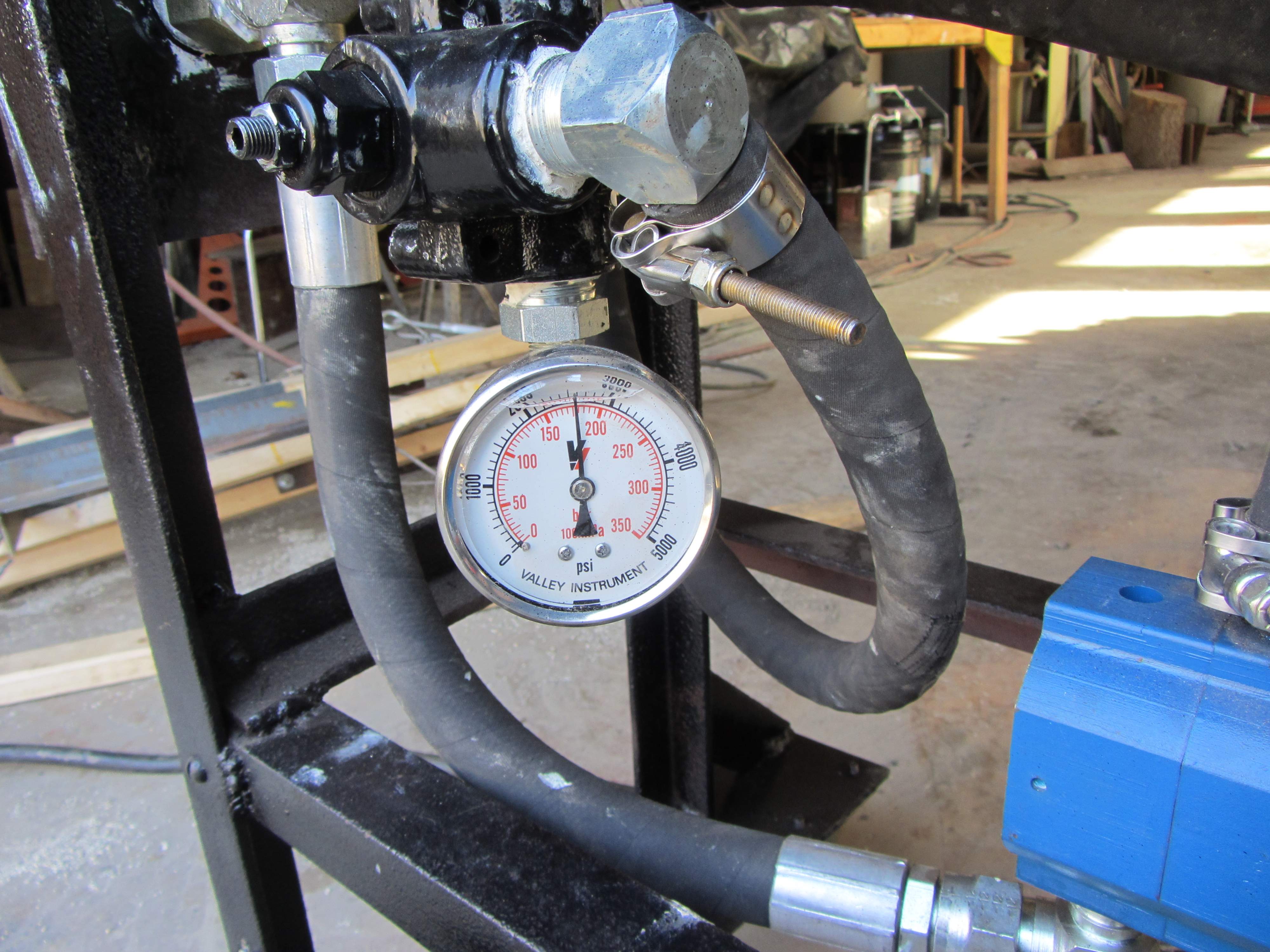

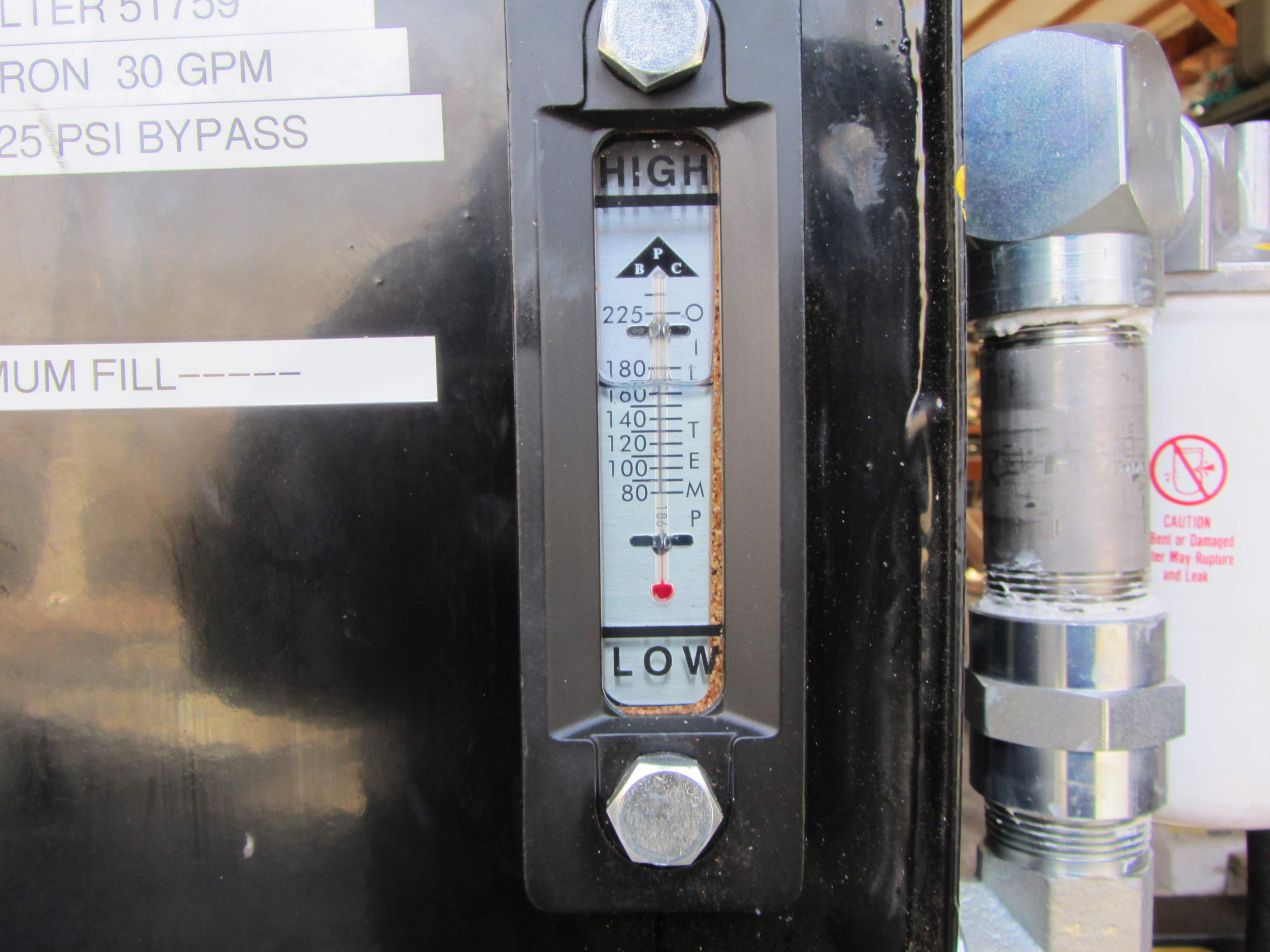

Pictures Running on my 50A welding outlet
The 10ft 10g line cord stayed cold The 12g pigtail to the motor stayed cold
The filter was getting warmer.
Amp meter on 60A scale

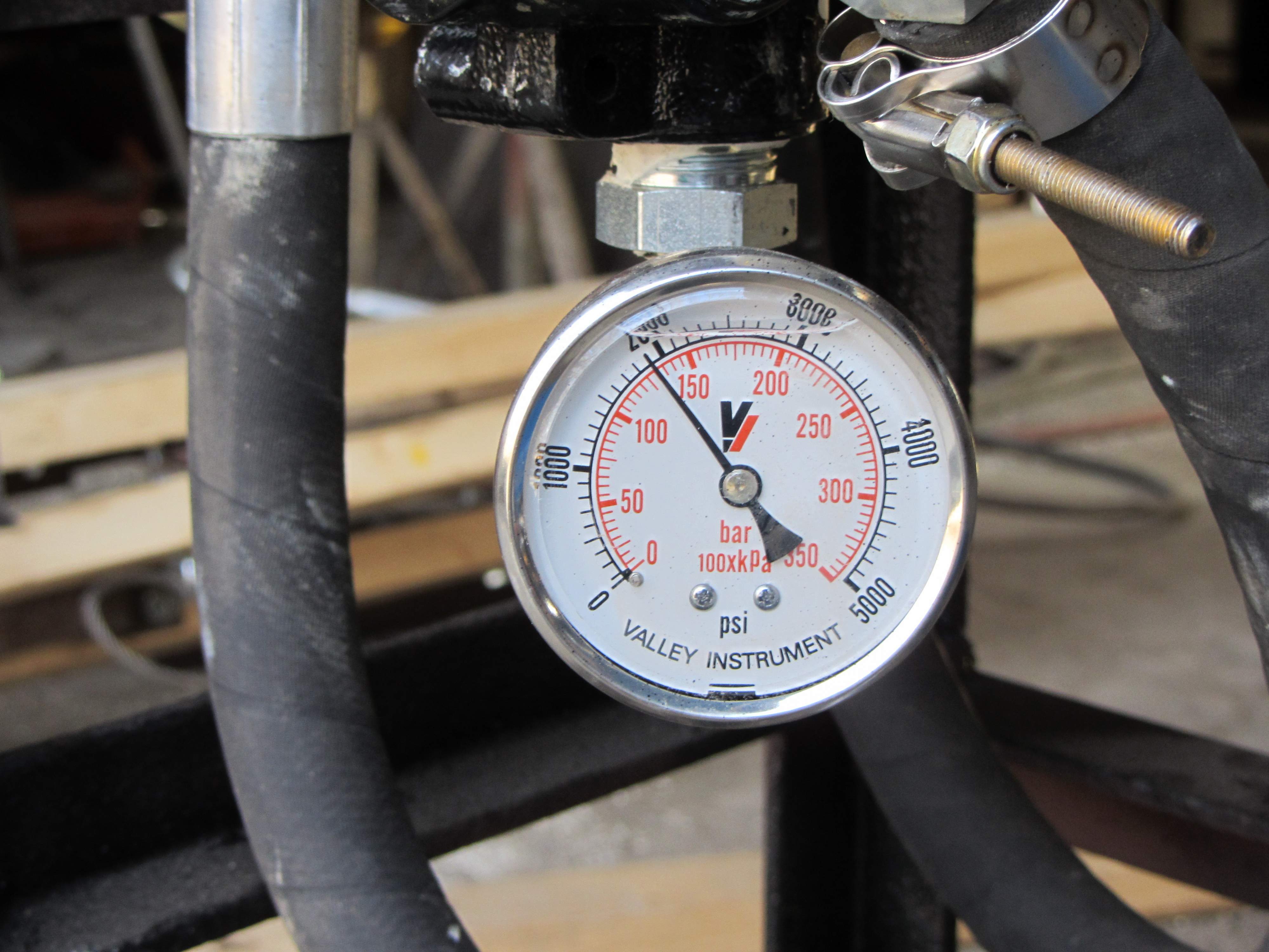

1900 psi at 21A
2500 psi at 25 A This is where I wanted to leave it but after 3-4 minutes the thermal cutout in the motor cut out. Motor was hot. This was going to be a safety setting for the pump. I set it at 2000 psi . I will have to see what happens when the beam is connected and most of the flow is at 600 psi, although the flow is higher.
I can always go to a ,shutter, fossil fuel fired engine.
The hour meter seems to be running fast. Don't know how that can be , they clock off 60 hz. I will time it with a watch some time. Maybe I am having so much fun time just passes.
Edit: What am I thinking. Set the relief at 2500. It's a safety. I don't care if the motor stops 5 min after oil is going over that valve. It should never happen. I can set the valve on the splitter ram cylinder to the minimum that works.

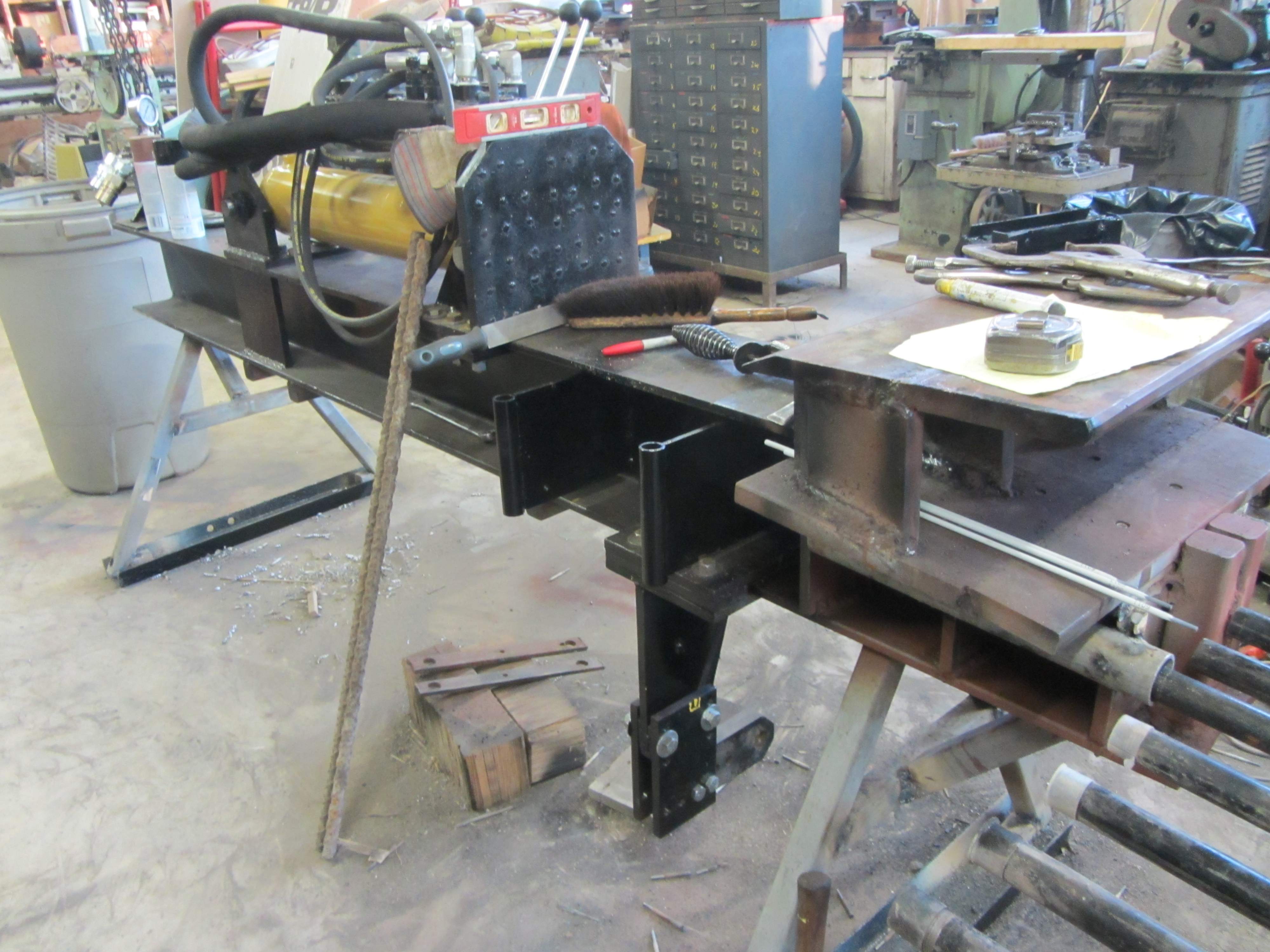

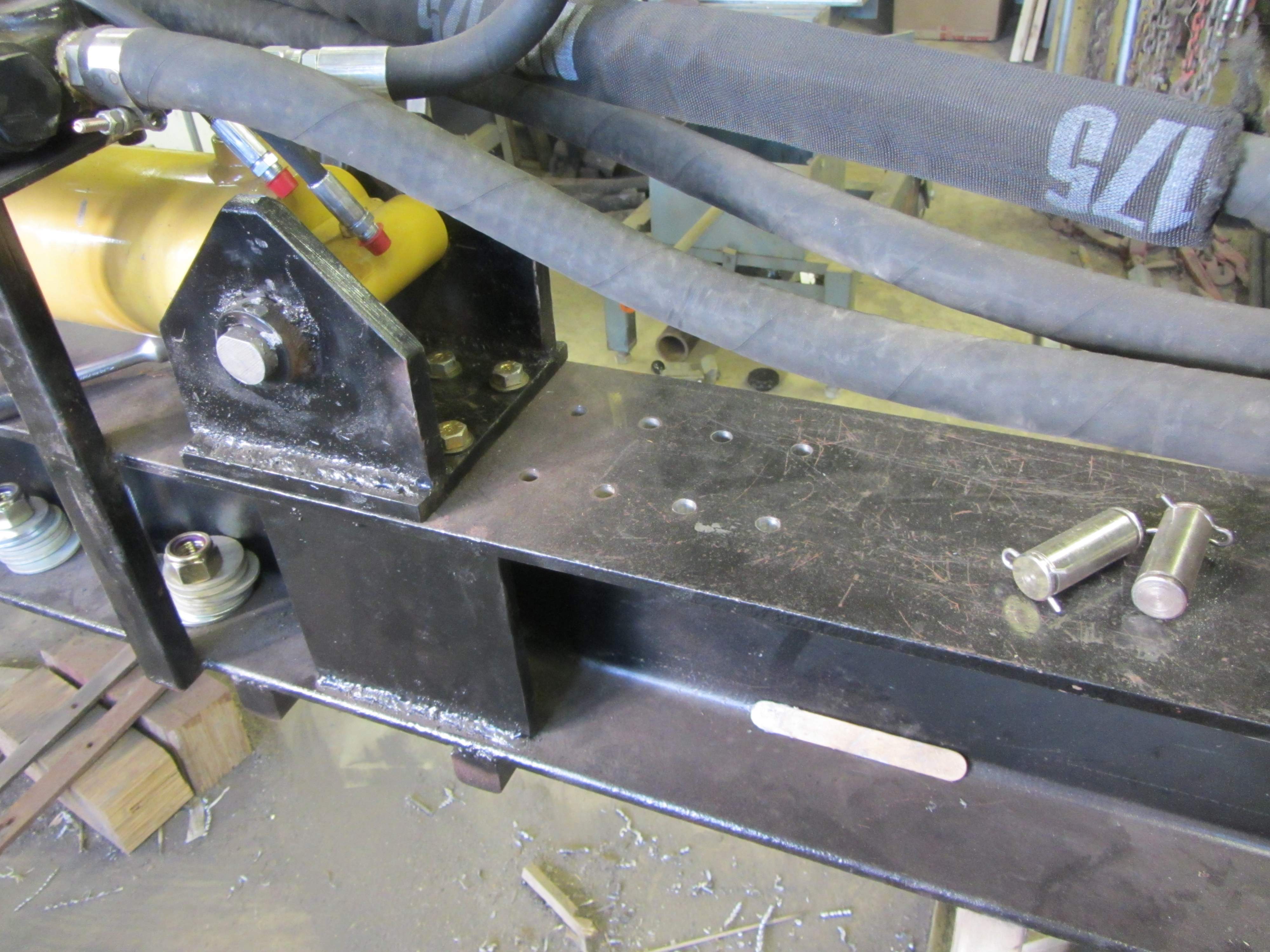

You guys forgot to tell me that the difference between a 20" cylinder and a 24" cylinder is 8" not 4". I had to unbolt the cylinder anchor , unbolt the hydraulic tailgate , put the mag drill back up there and drill 4 more holes. I debated with myself for a while whether or not to bother but I finally decided to do it. Also finished, almost , the mount for the log lifter. Needs some right angle braces but I need to put it together to see where they go. Finished the mount for the off side log stop. Just going to stick bent 3/4 rebar in those pipe sleeves with those orange caps on the ends.
Started thinking about the outfeed mount. Looks like 3/4 pipe will slide nice and loose into 1 1/4. I have to find a couple of feet of 1 1/4 pipe somewhere.

I plotted the 2 points I have and the theoretical lets see if I can attach it. The 2 points in green are real measurments. The others derive from the PSI x gpm /1714 = hp and then converted to kw and then amps. They are not too out of line from each other . I am curious to see what the rest of the real numbers are.
One of these days I will move the beam outside and leave it there Then I will have to run it

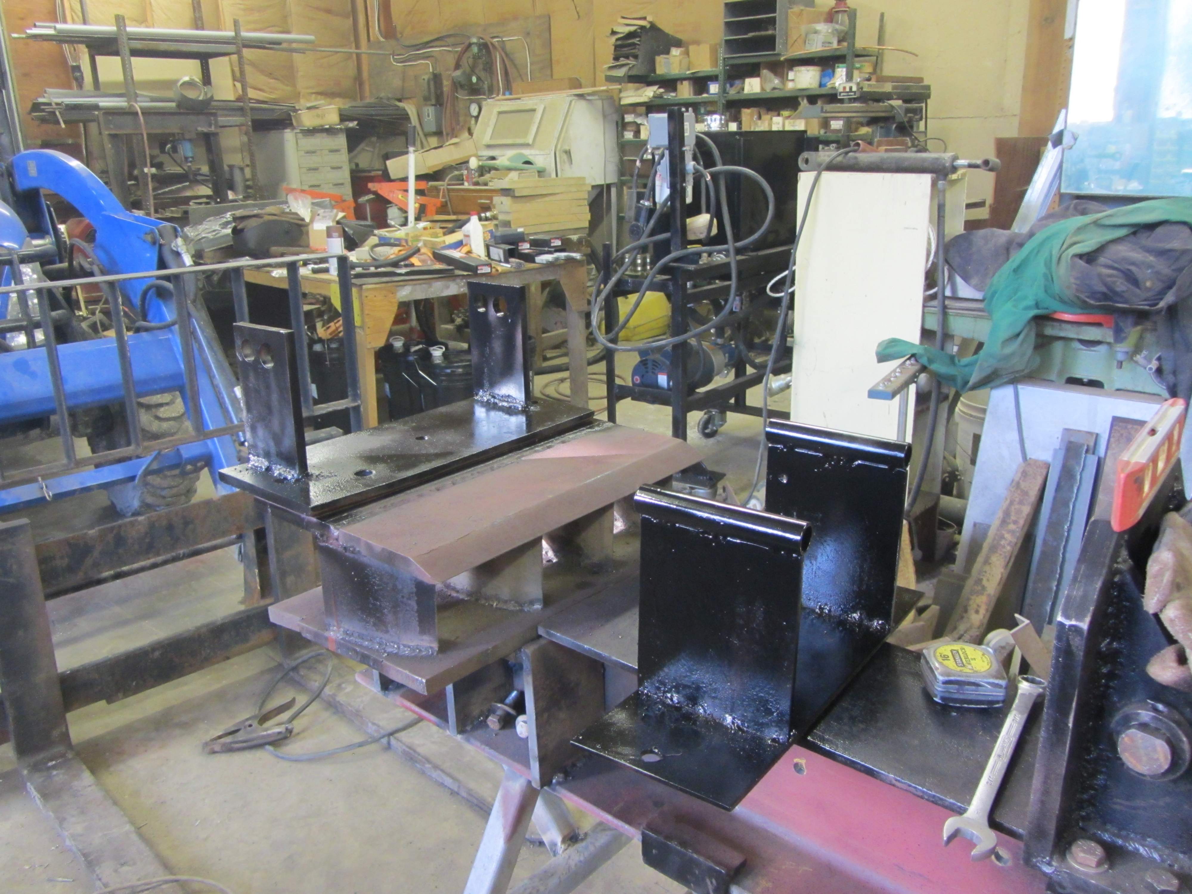

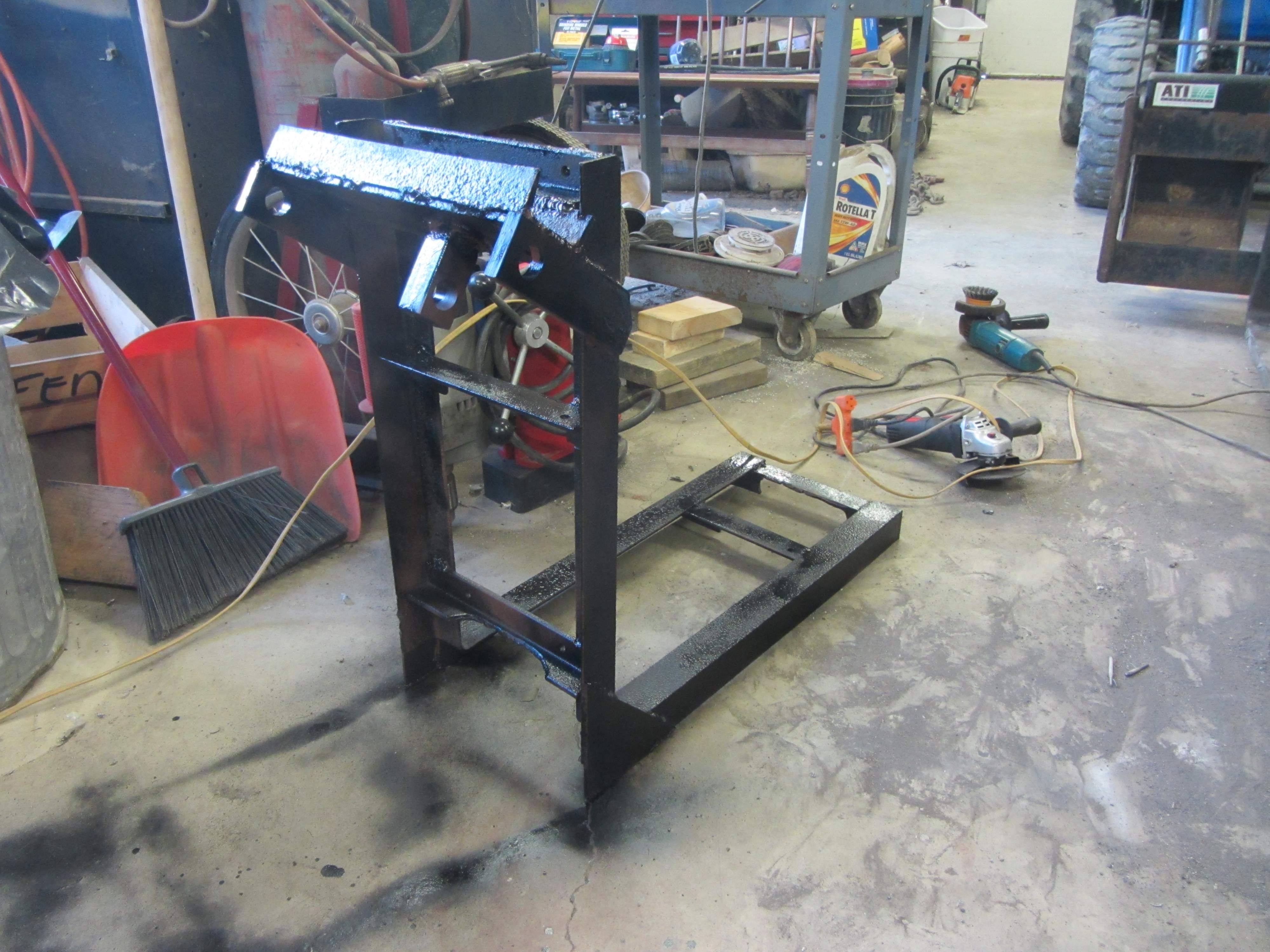

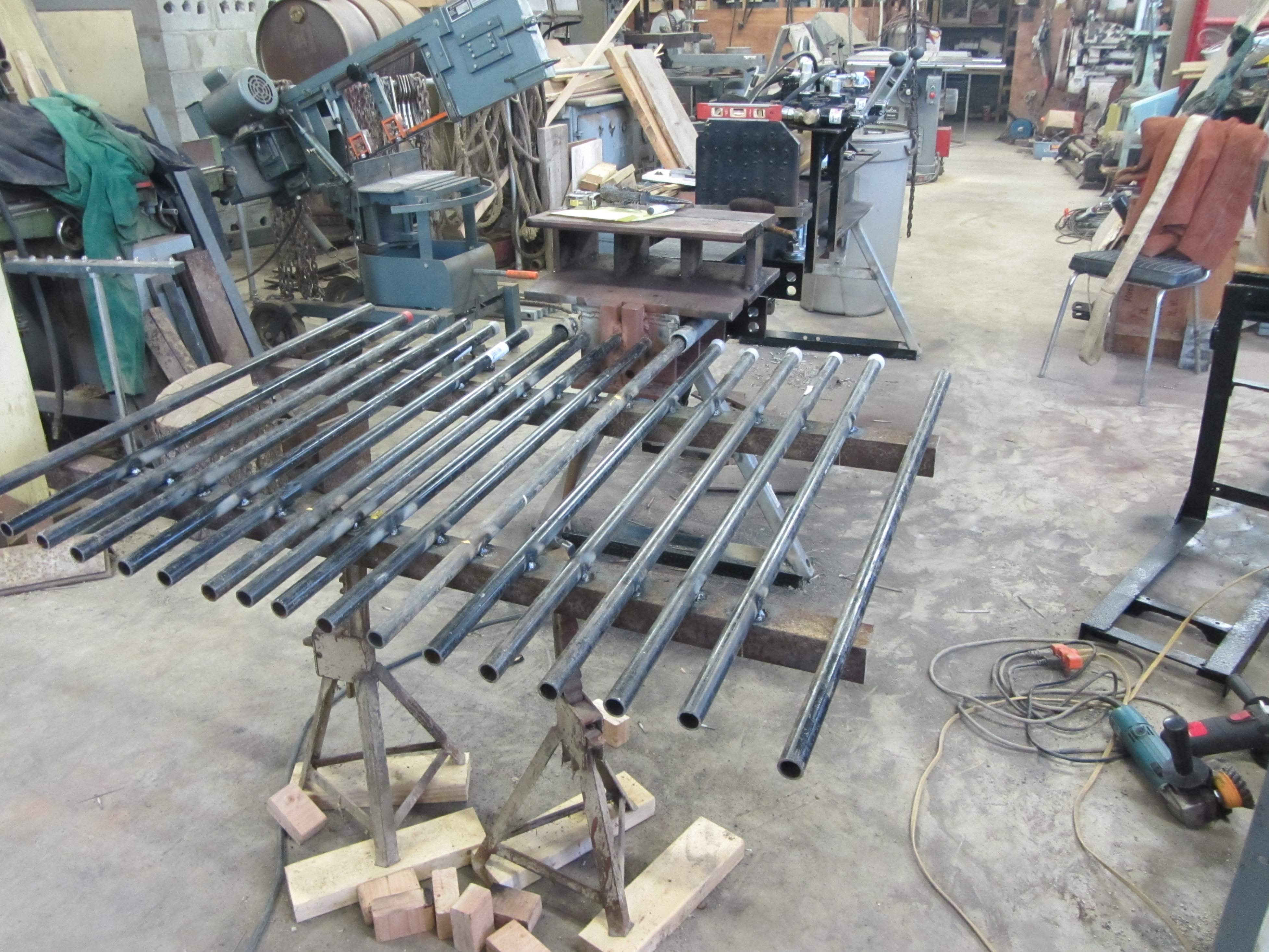

Almost there. Bolted on lifter bracket and off side mount. Bolted in the lifter. This is the first time those big nuts have been on the pivot bolts. The up position with out the cylinder is the travel position. IF you look at very first pictures you can see forklift pockets. The left hand one ended up under the log lifter . That why the cylinder push point is off center and why there is a travel position. I am going to run the lifter one more time on air to make sure up is slightly beyond horizontal.

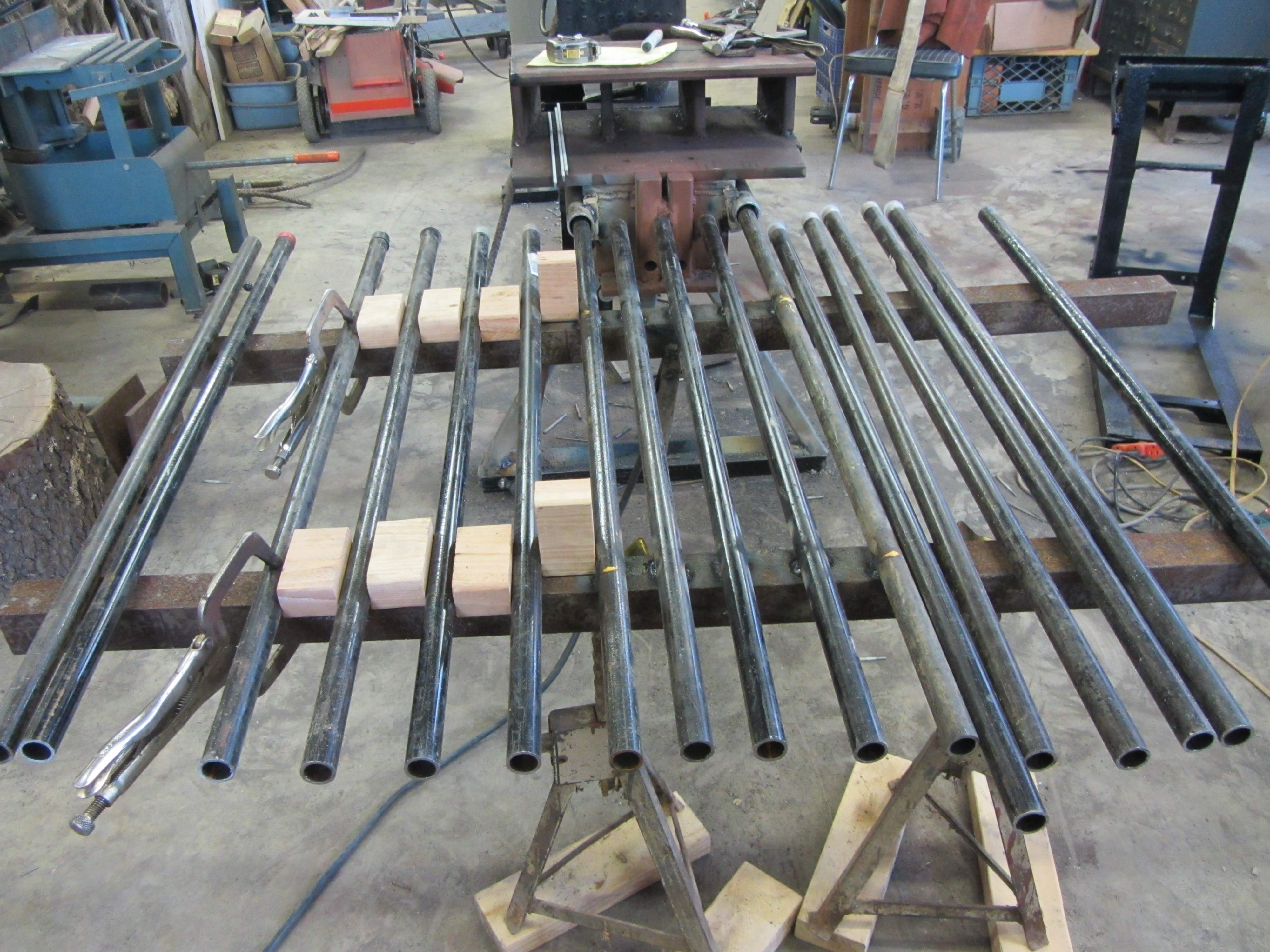

Also got the out feed table going. I worked till 5pm today IT was warm out but it was 2 hrs past my quitting time. So of course I managed to goof up a few things. Lost track of my tape measure and the angle iron is an inch longer on one side than the other, Also welded a bar right over the bend slot on both sides. I can weld on an inch if I need to. Cutting out welds is what grinders are for. IT is heavy , I will need legs at the end, Pipe and pads. Good thing I have forks for my tractor. Those orange things are rebar caps. I got 10 for $5.

Bob are you going to put a lip around the outfeed?
I have about a 6" lip around mine and it does a good job keeping the rounds from shooting off. Something to think about.
   / Woodsplitter build #2
#96
Yes I am Just got late and I was tired of bending over. I think I have to extend a couple of the inner ones back past the splitter
