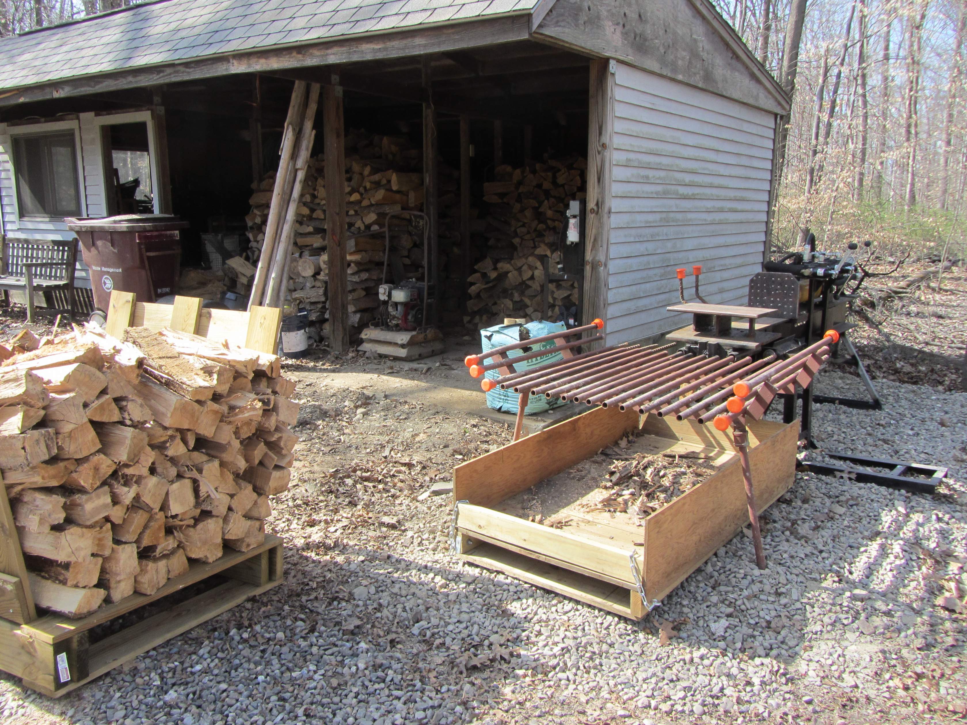

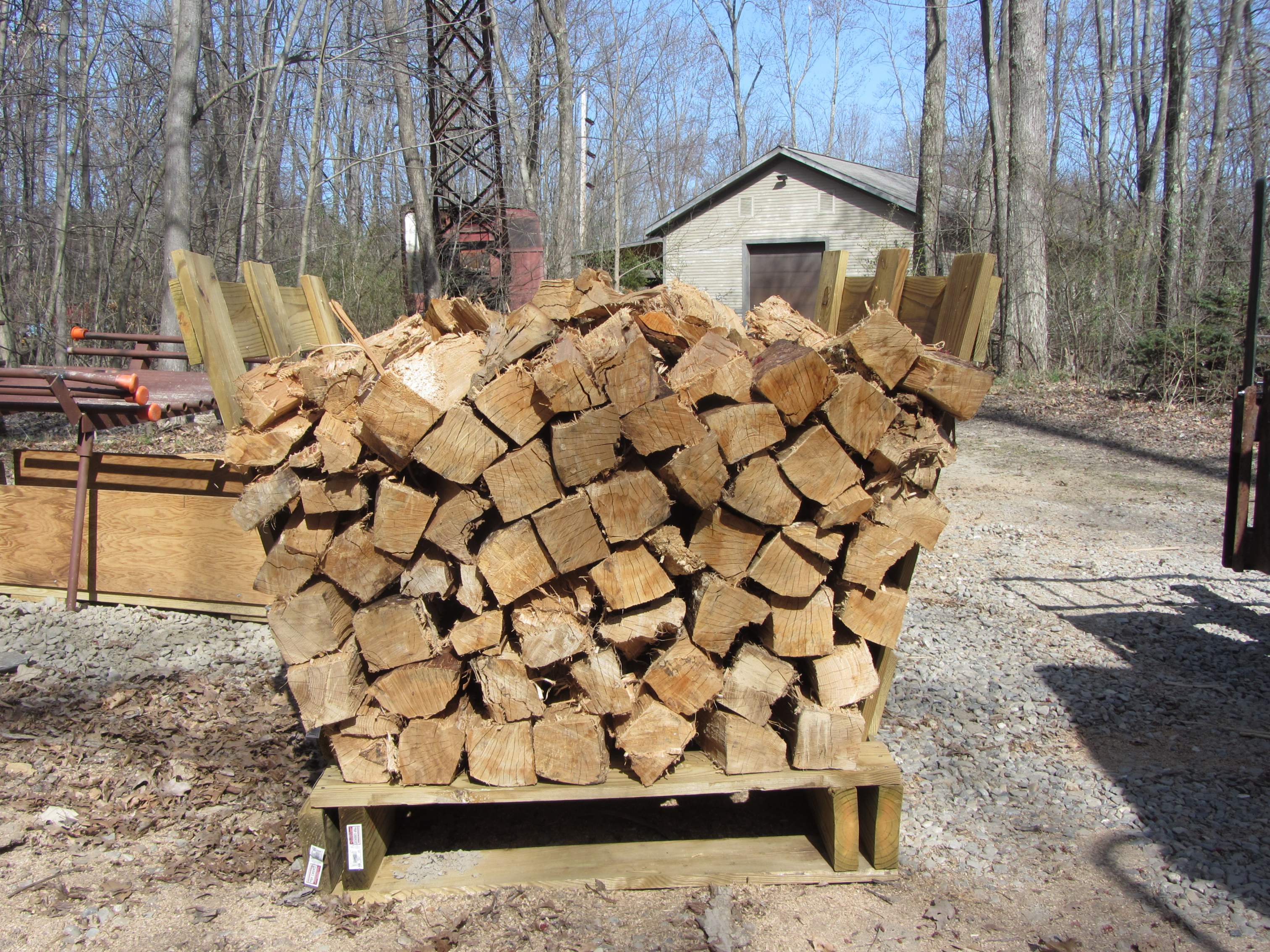

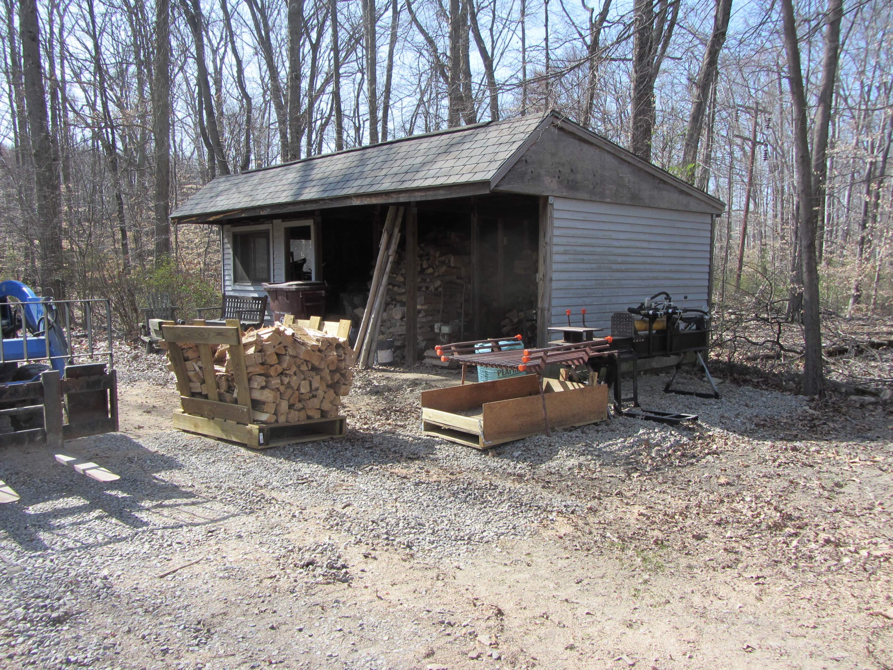

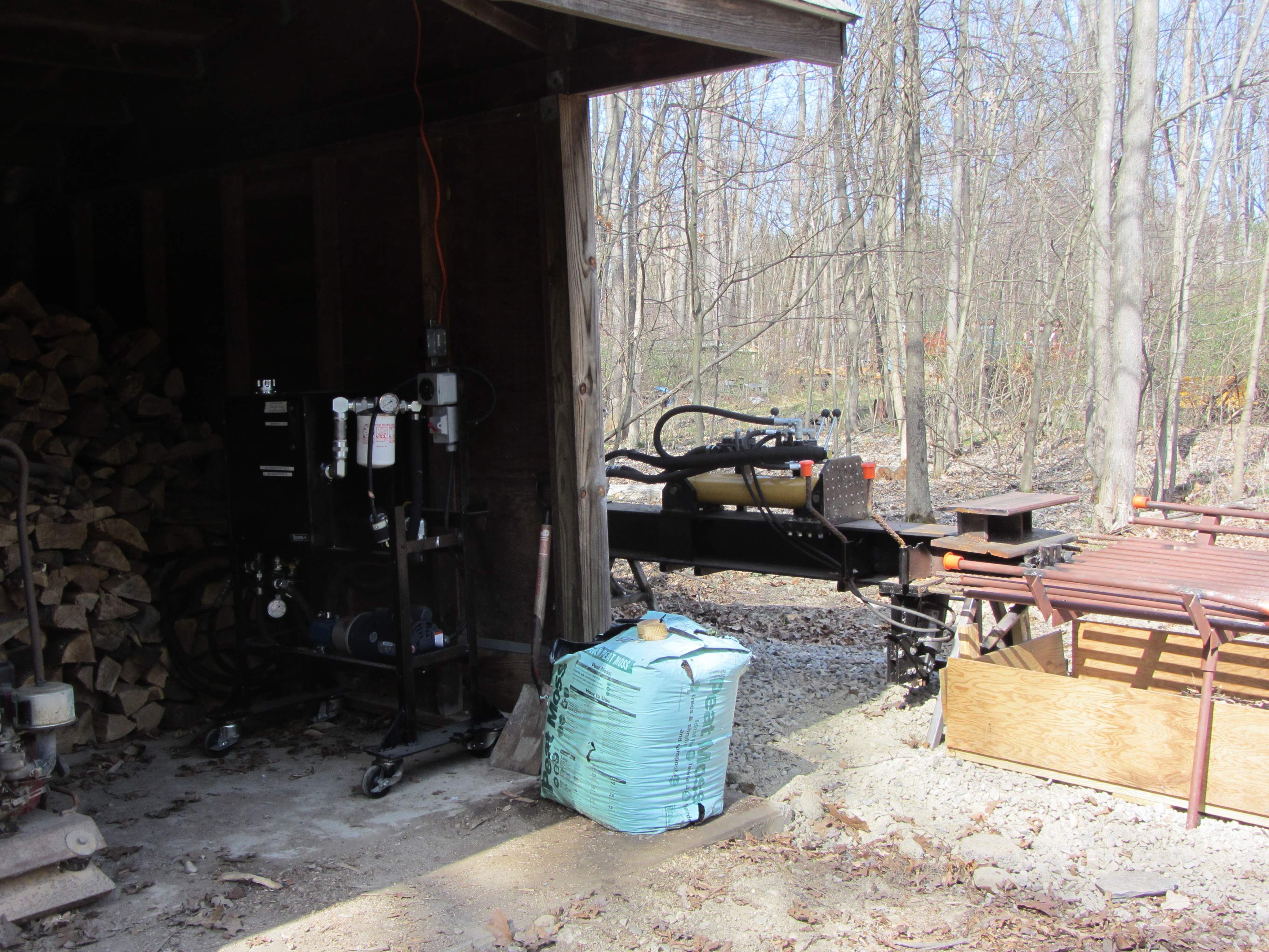

Last post with final pictures. Unless something blows up.
Splitter in its final home at the wood shed. I realized that if I have to weld on it I have to move it back to the shop. uh portable welder????
Power pack is inside , beam outside. The skid is 3 x 4 x 2 1/2 high about a 1/4 of a cord. That is all my loader can lift. Notice no bark on the splits. A full skid of 4 x 4 x 16 will fill the trash skid under neath. Some kindling slips through but the split wood is nice and clean. I have 8 skids filled like the one you see, all oak from 1 tree. I was thinking about a concrete pad but figured I would get sticker shock. I had the gravel around and put down some geotextile I also had around. It's a little harder to clean up on gravel than concrete but that is life. Lets see have to get my wife to move her peat moss bale, or rather tell me where she wants it. I decided to ignore the valve problem for now. Maybe it will fix itself or I will get used to it. I also have to put in some kind of fence rail so I don't spend any time under the crane boom. I don't worry about it coming down but I also don't like being under it on purpose.
I actually have 20ft from the splitter to where the end of the boom would be if it came down. Anybody ever taken one down by cutting the cable inside the cab where it comes off the spool? All the action would be out side then. I would really like to use an explosive cable cutter and be far away. Off topic sorry. Ok this was a great story and fun to build. Thanks everyone for comments and looking.

   / Woodsplitter build #2 #156
Nice looking shed. I think im going to do something like that this summer if time allows. It sure beats dealing with tarps all winter.
Good idea on the box under the splitter. I got a ton of splitter trash piled up under mine. Im going to have to wait till it thaws out and push it into a pile to burn. Your system seems easier to keep clean.
#157
About the trash box. The chains hook on the back of the fork attachment and the front door lifts out. So other than getting on and off the tractor a couple of times I can dump the box with the forks.
The shed was supposed to be my wife's garden shed but she discovered she hates mice. Oh Well. I have to finish the siding and stain it. Been ummm 18 years. Maybe next week.
