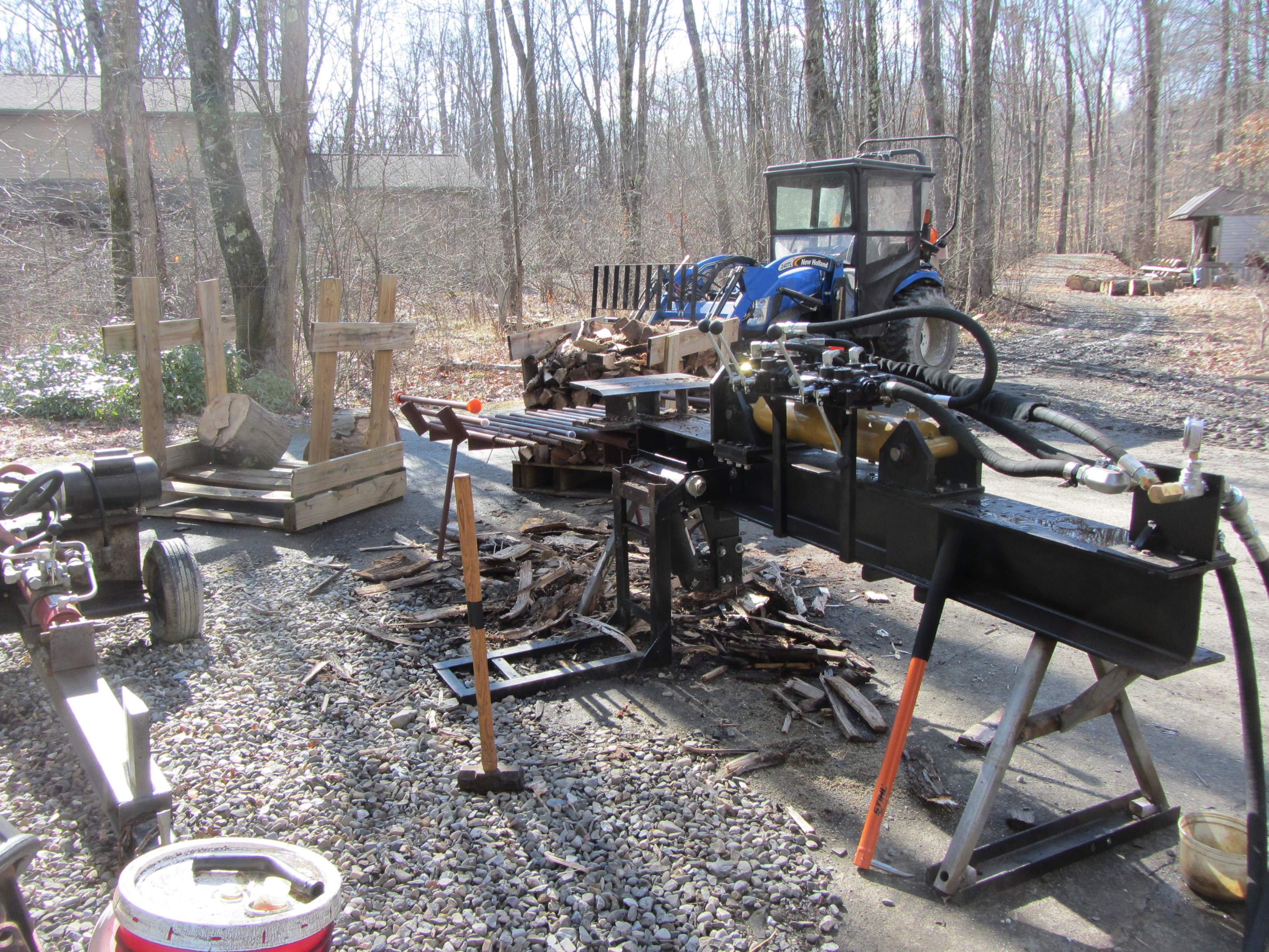

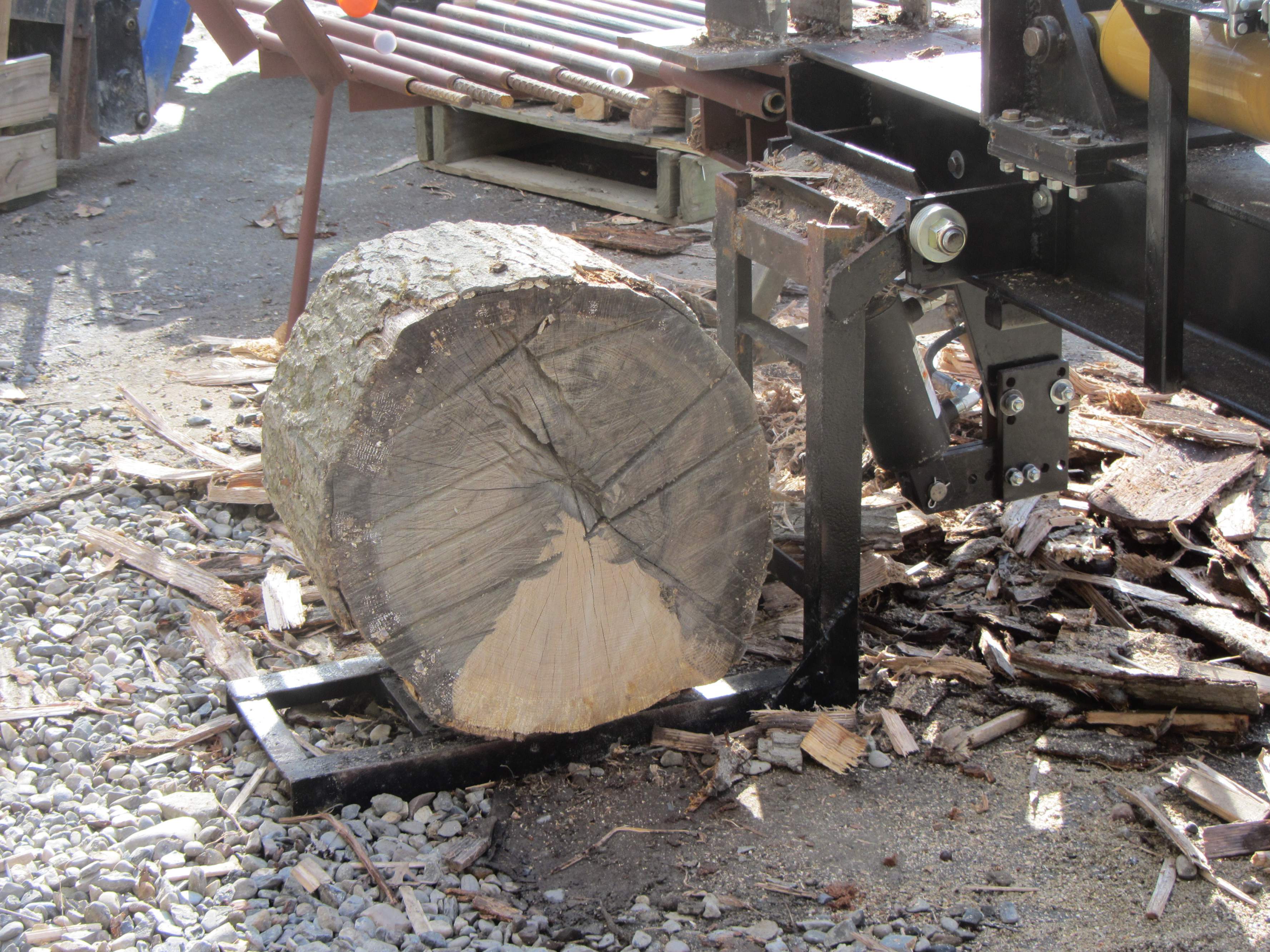

All right. This will probably be my final report. Maybe. It works. Pictures say it all. I have some comments.

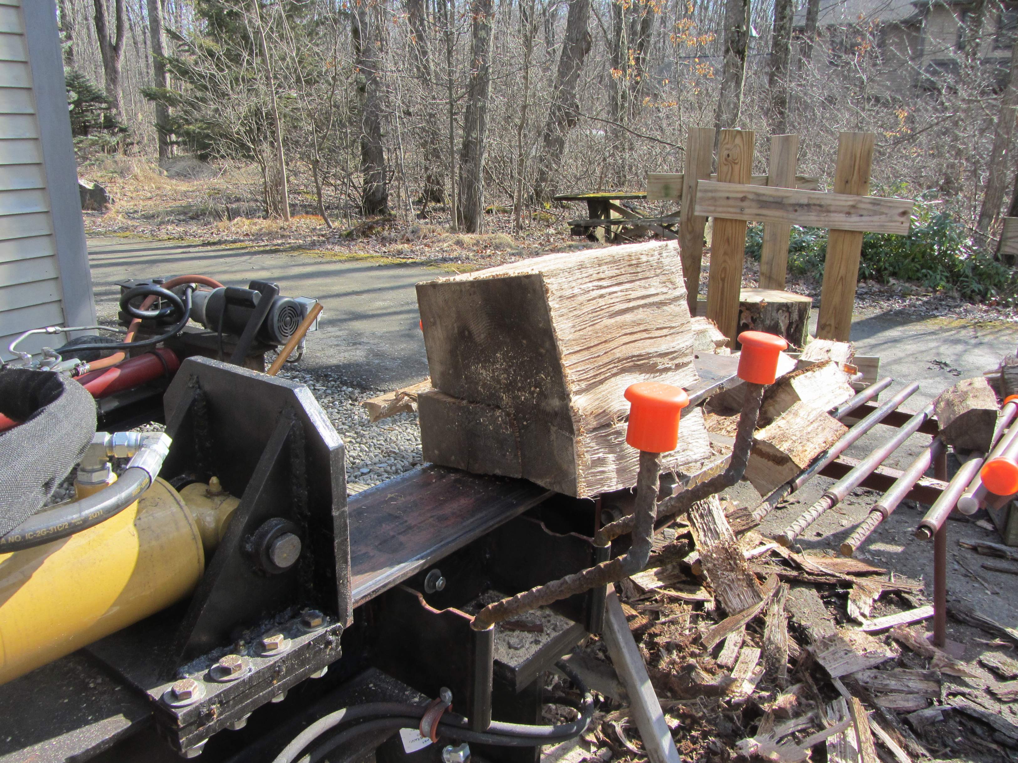

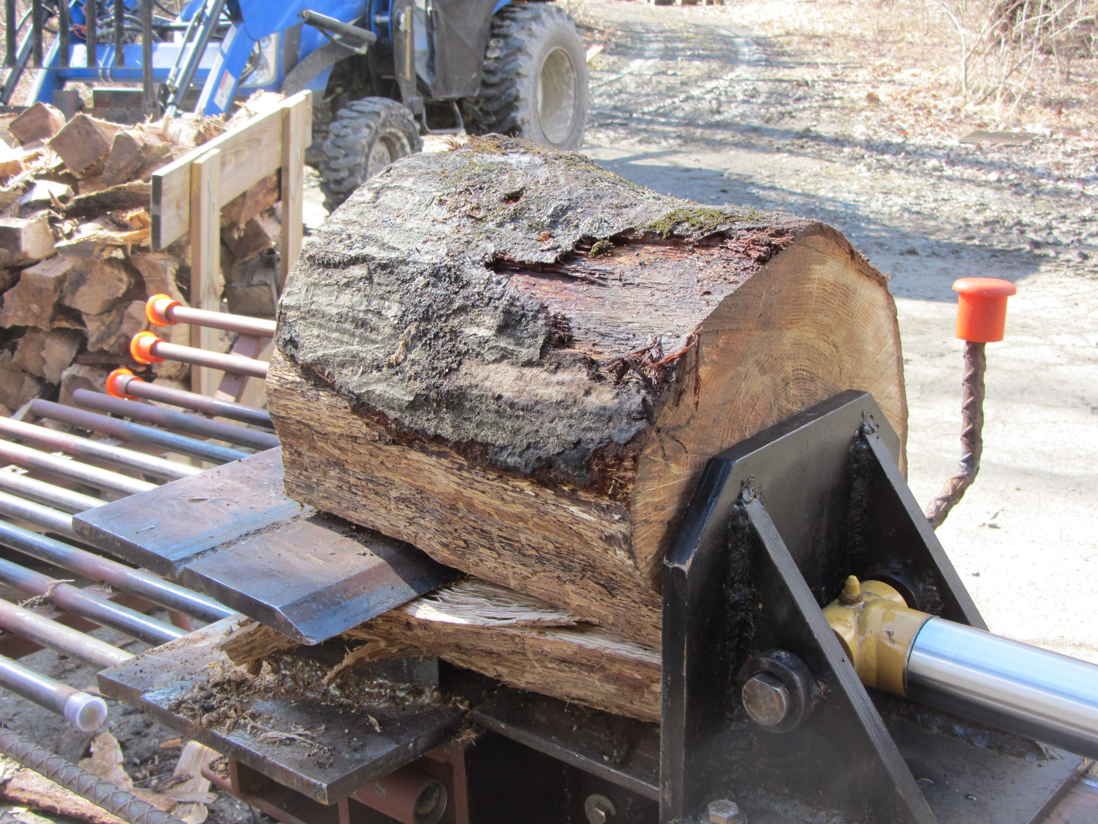

Box wedge. Most of the psi activity is around 800- 1000 psi occasionally 1500. Knots or tapering grain will stall it at 2000. Just like learning on a single wedge to keep crotches vertical and work around knots, same here. I did not pay attention at the beginning or experimented and so the sledge hammer and chain saw are nearby. I split 10 rounds today. The last 4 went right through. What I did was run one split and then turn the round over 180d, avoiding knots. This seems to take some of the binding and compression out of the round. I flipped the big ones a couple of times. When enough comes off I flip it 90 to keep working around the knots. The smaller rounds 18" I don't have to do that but still watch for knots. In one of the pictures you can see a large square balk, that is from working it around. That whole thing went throu licitly split. :laughing: At 2000psi the whole end of the beam , box and all was flexing a little bit. NO more psi on this puppy with out some added structure. The top of the box is really nice for keeping the round close and it position. I cleared the box after every round, works a little better like that.

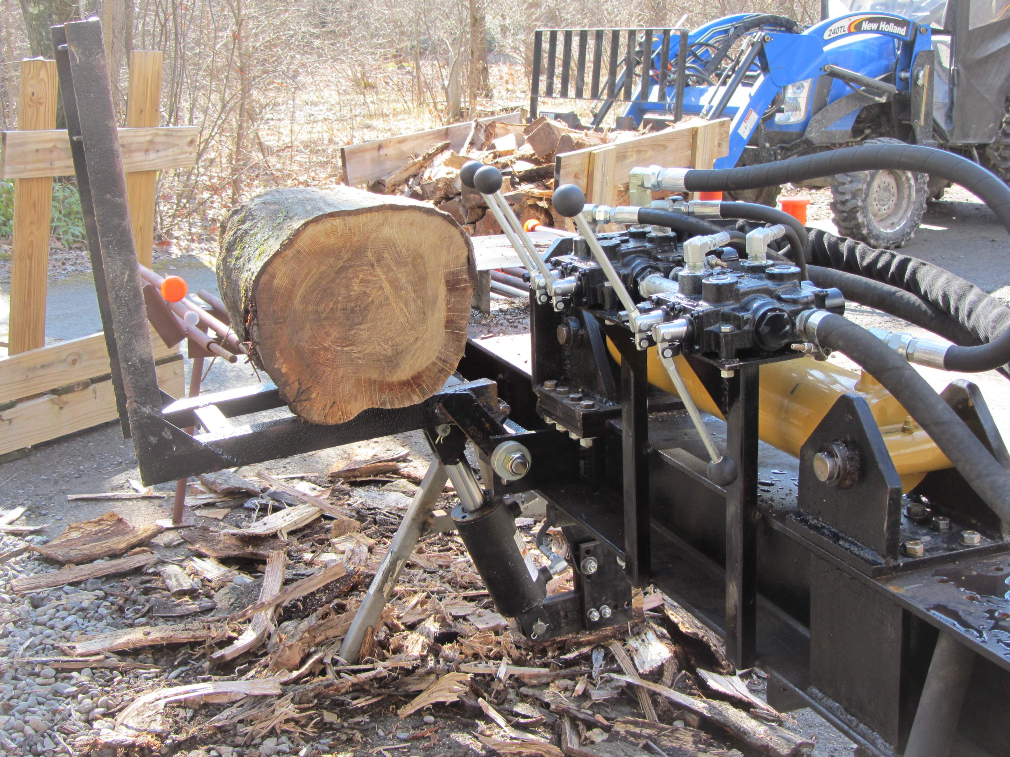

Auto valve. Probably not worth the money. It does not always work, sometimes pops out early and sometimes does not reverse. Be better off with the one you hold to split and then has an auto return . This one does that too if you want to run it like that. Hold the first lever to complete split, let go of it and pull the other , it will stay until it detents out.

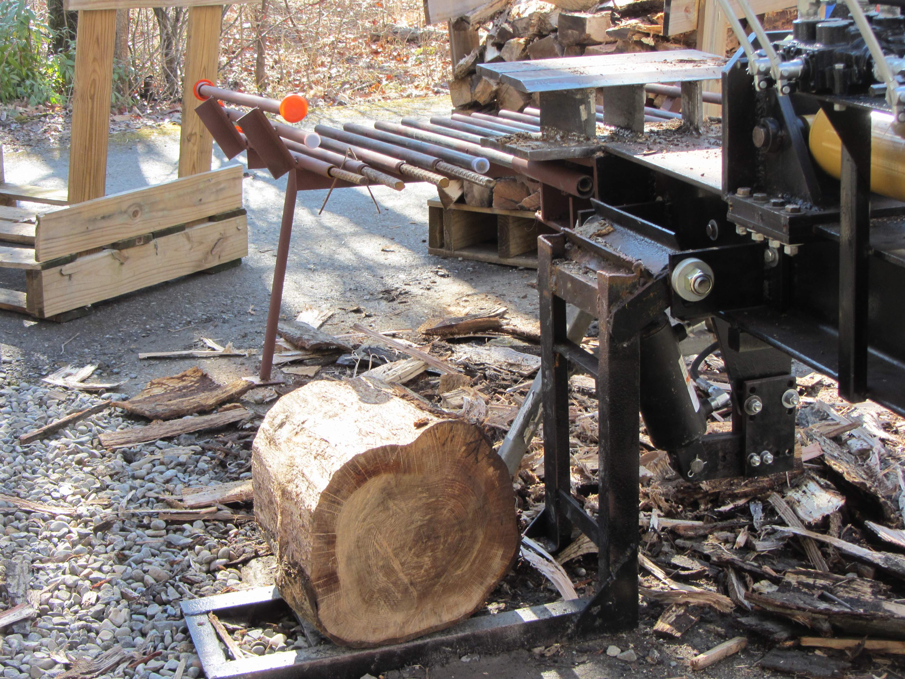

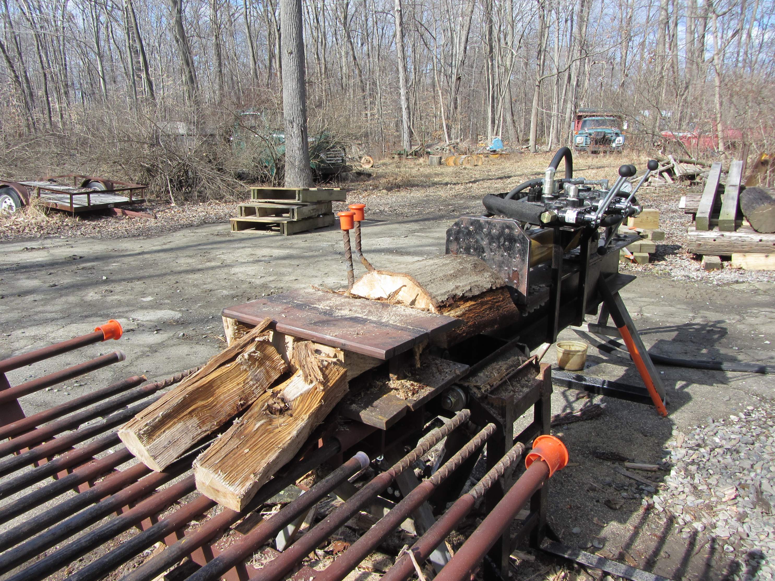

Out Feed table Outstanding What a back saver. 2 small rounds 18" or 1 big one and I have to clear the table or the splits get pushed onto the ground. What is the point of that. My skids take 8 rounds. They are 3 feet wide. They used to be 4 but my loader could not lift a 4 x 4 x 4 skid full of wet firewood. When it dryed it could but whats the point of that. The way mine is built it slides in so when a piece get stuck it just pushed the table out. It is good to notice before it is completely out.
Log Lifter Better back saver than the out feed table , well maybe equal. See the last picture That is almost the largest round I currently have. A welded part broke just has I was lifting. :( Too bad because I wanted to see the psi for the lift. The part was a keeper for the weldment that holds the cylinder. I did not think it was taking a load but just holding the rest in position. So a little redesign and welding. I will post the psi for lifting that round when I get it fixed. Next week.
I started the build of this on 11/17, today is 2/17.:):):):)
I will answer any questions anyone has here or PM

Very nice build Bob. It's possible your machine may be working harder to over come the angles of your end wedges. I think these angles are more pertinent if your center wedge was out further than they but from the looks of it, you are getting a straight push through without the splits angling to the end wedges. I could be wrong and someone somewhere else may have mentioned this already but I am not the type to wade through the thread to find out so forgive my repeat if indeed this is so.
   / Woodsplitter build #2
#133
It's hard to get the right angle on paper. The top wedge leads by an inch, then the side wedges start 8" in between, The center starts an inch behind the sides. The sides angle away such that when the center starts there is enough space to account for the thickness of the center when it starts separation.
Best I could do on paper. The center is beveled on both sides. The top and sides have a single side bevel away from center. When the grain is straight the pump does not even go to low gear. Most of the time it never goes over 1000 psi. Knots are a killer.
   / Woodsplitter build #2 #134
Knots and a box wedge are a killer for sure. Its a brute force thing. in a normal wedge, the log can squirm around knots and follow the path of least resistance.. Not so with a box, hence why the commercial models have a huge cylinder and high press. But it sounds like you have it figured out to work with your lower pressure, just watch for knots.
Glad to see you appreciate the log lift and out feed. As i said, probably the best features pound for pound.

Your autocycle should lock in. Mine very rarely kicks out, usually it only does it when the oil is cold. Yours might need adjustment if its kicking out all the time.
Once you get used to it, i think youll like the autocycle more. It lets me do two jobs, run a cycle and throw the splits into the loader bucket at the same time.

Lifter is fixed. After welding the second attachment that let go on that big round. My 9 year old grandson helped. Actually I grew a set of eyes in the back of my head keeping track of him. We went out to spilt wood. Broke a weld, un bolted , ground it out, re welded, bolted it up . Split wood. He was great, Did everything I told him. Asked a thousand questions ,including why pay for hydraulic oil when you could use water? He came back in and told my wife it was the best day of his life. I guess maybe there is something to this skipping a generation. Anyway 600 psi to lift that big round. Which is 5700#
No wonder small sections were letting go. I should know better than to try and weld up under something. Took it off and rotated all welds down.
