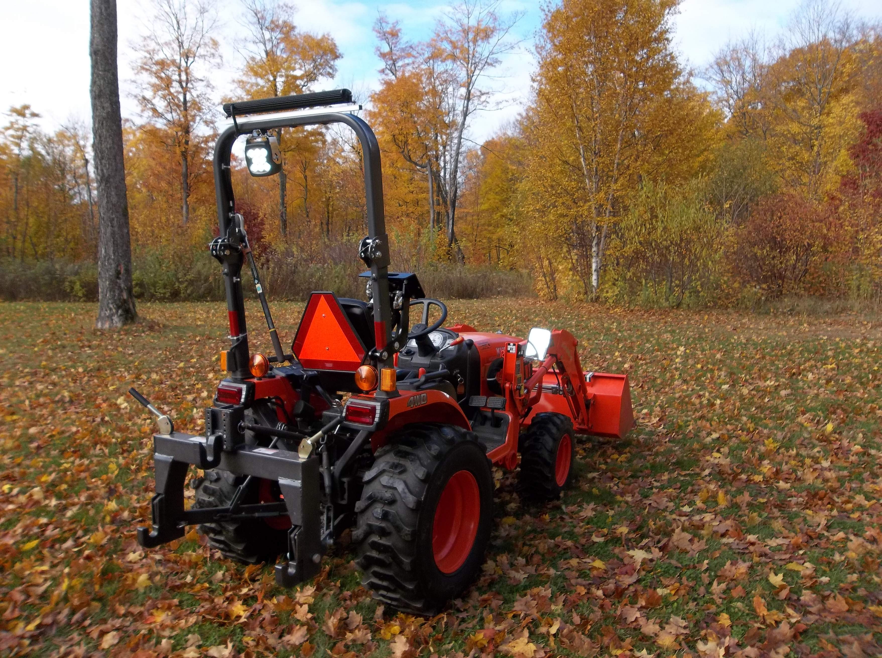

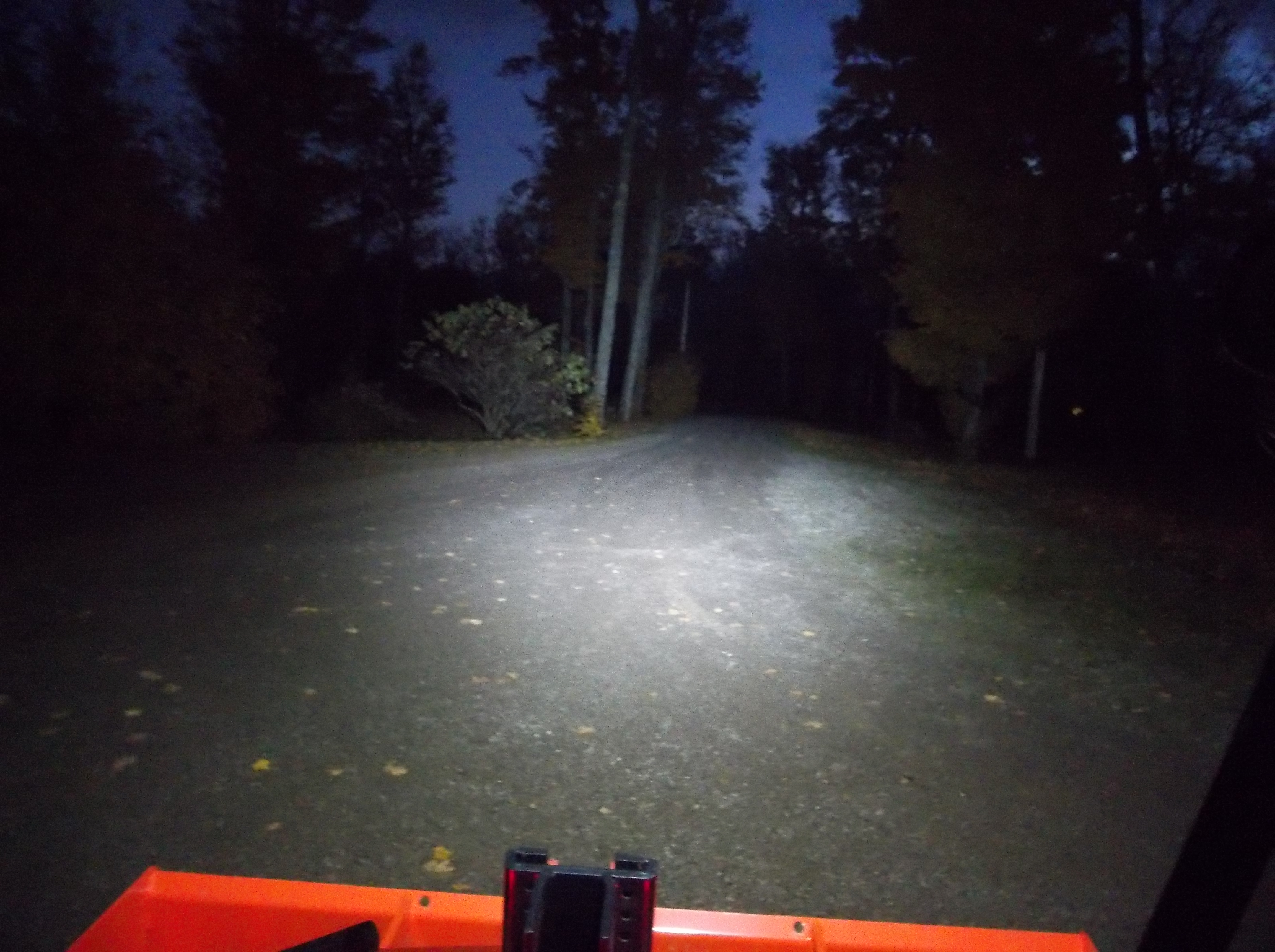

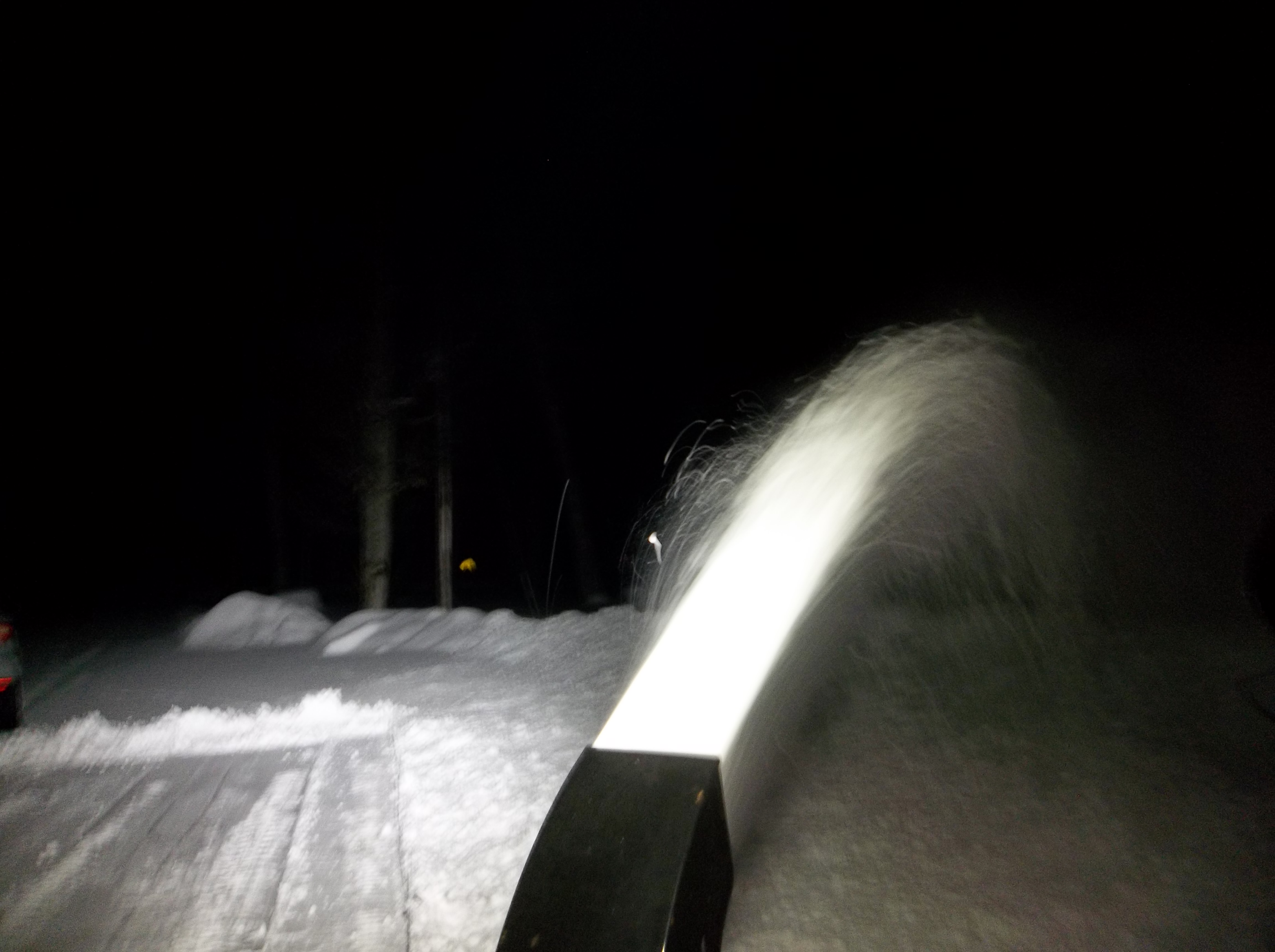

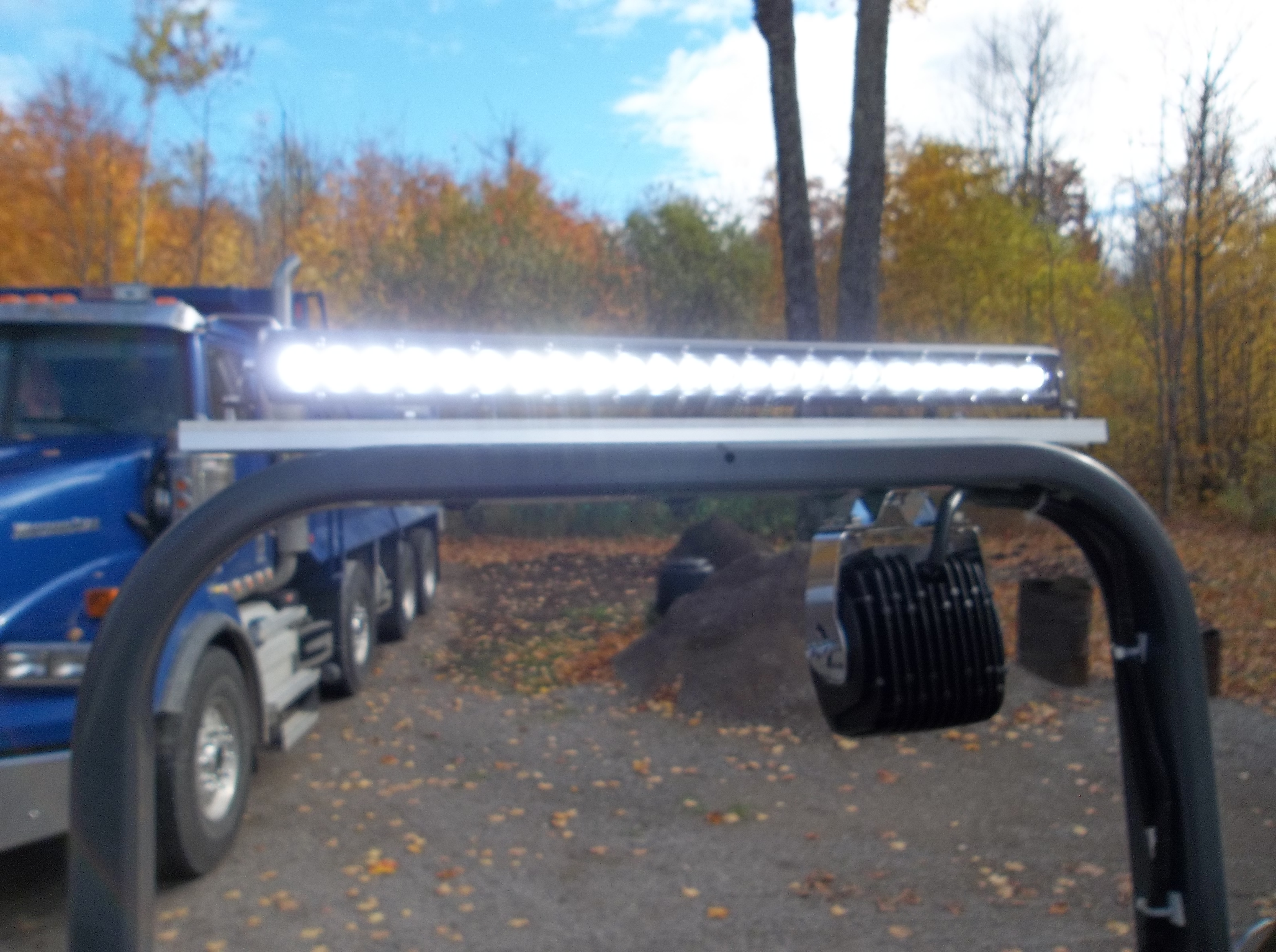

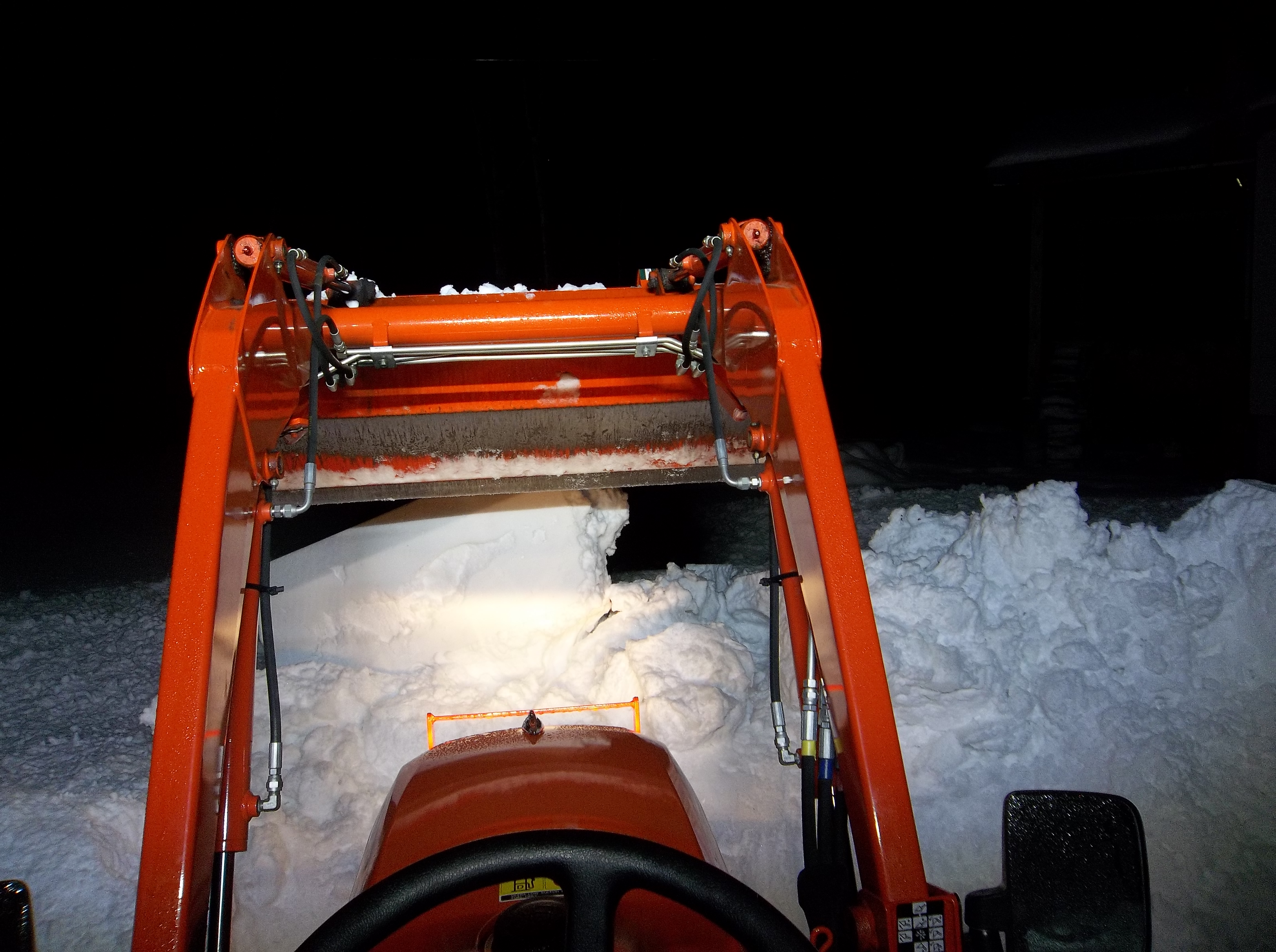

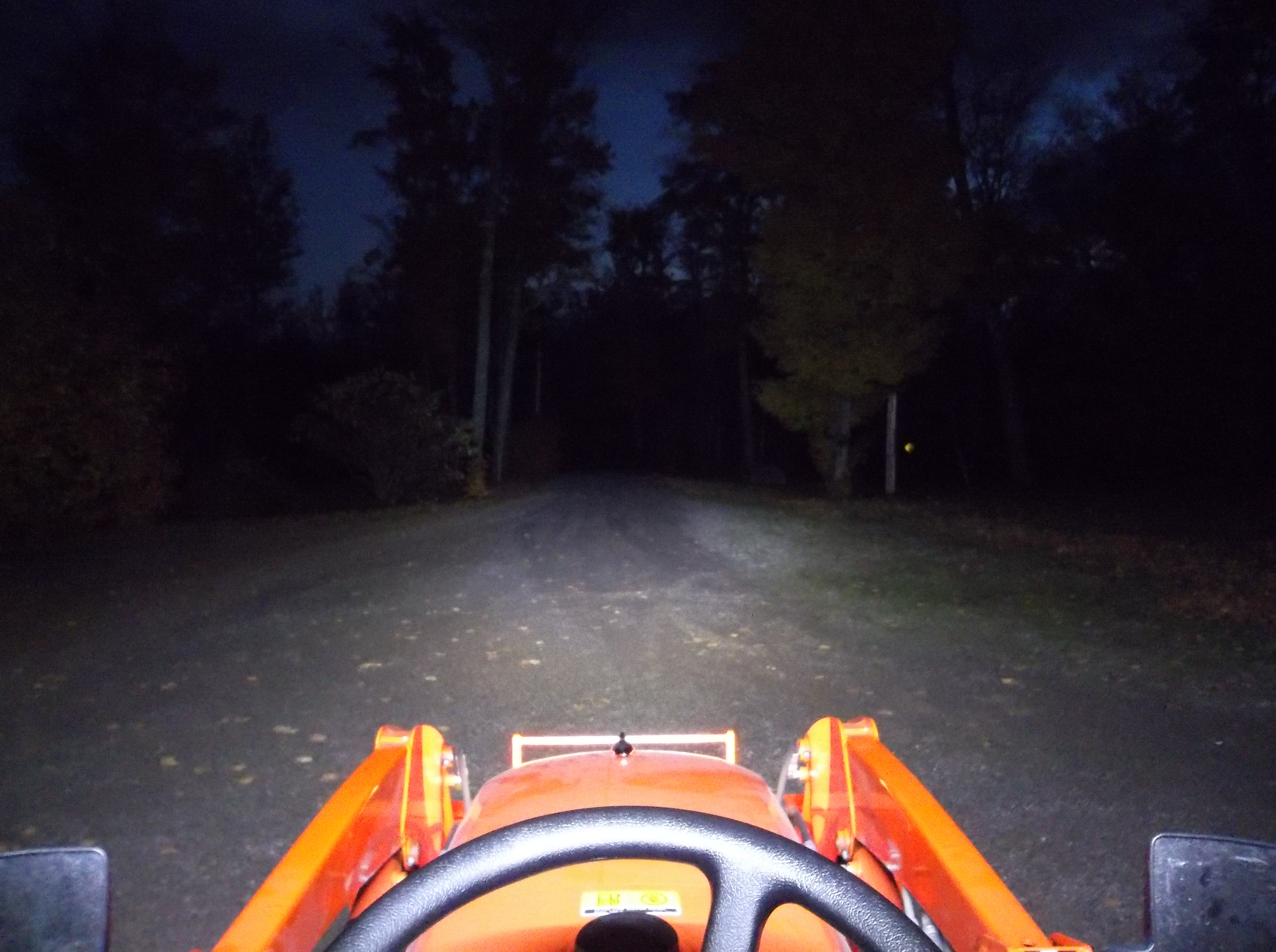

I had the optional 40A alternator installed when I bought my B2620. Only downside to it is they have to put a different engine oil dipstick on the engine, so you now have to remove the side panel to check the oil.
I put a 120W Cree combination spot/flood light bar on and an 80W flood on the back. Very little power draw, and no glare snow blowing in winter. Just don't look up and back, LOL.
With both on I get 360* lighting. I can see the edges of my mm mower quite well.
