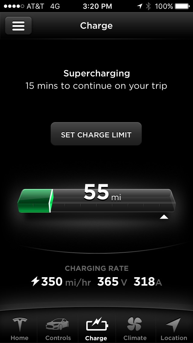

I know their superchargers are three phase, I think I saw something about a hundred amps but the person may have been blowing smoke, that's a lot of juice.
Aaron Z
It really IS a lot of juice. I think We take for granted just how much power our vehicles take. I wouldn't be surprised if the super charger draws 100A @ 480V. In fact I think that if the claim of a 30min charge is accurate, it would have to be even higher. We can scratch the surface of the math, assuming Google is correct about Tesla having a 100kWh battery pack. I won't bother calculating charging efficiency losses or minimum depletion level, just assume they cancel each other out. So the supercharger needs to deliver 100kWh in half an hour, that's a 200kW constant load for the duration of the charge. At 480V, 3ph, with unity power factor that would a 240A load. Enough to power a trailer park during a superbowl, assuming they're on propane.
The V2 Supercharger is nominally 400VDC at 300A for 120 kW. The latest is 250 kW, a rate supported by only the latest versions. My 85 kWh battery from 2013 will only charge at 120 kW.
Thanks for the insider info. I was speaking in terms of amps @ 480VAC, the draw on the 3-phase electrical grid. DC charging amps will be higher. But with the info you've provided, there is a better foundation to work it out. 120kW charge rate would demand 144A from the 480V grid (plus losses). 250kW would be 300A.
I(A) = 1000 × P(kW) / (√3 × PF × VL-L(V) )
