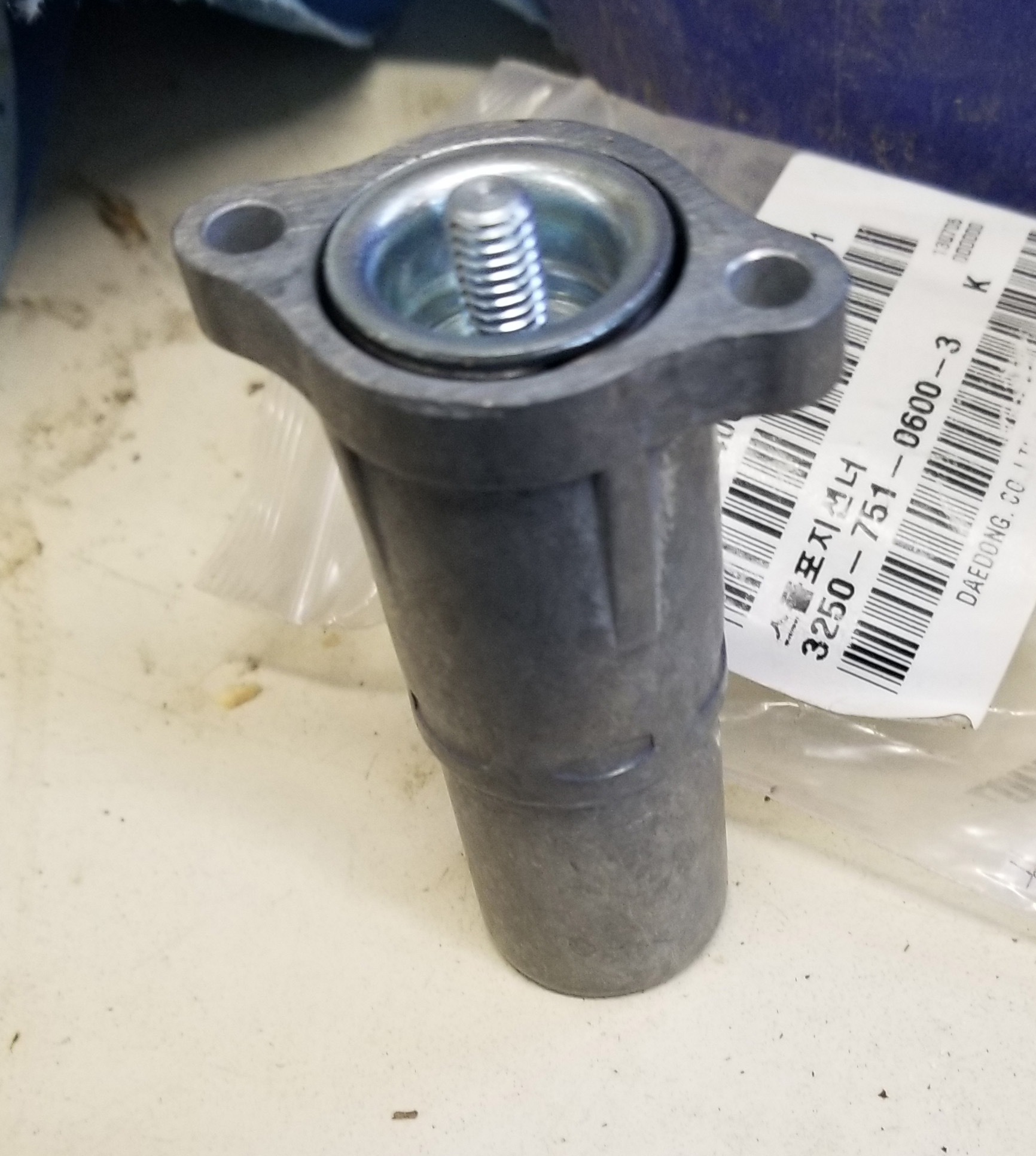

Curiously, what fails in it and how easy is it to repair?
   / Would you buy your Kioti (or another) again? #103
My float isn't working since I broke my joystick. I repaired it but 'float ' still isn't working. Haven't looked at why yet.
   / Would you buy your Kioti (or another) again? #104

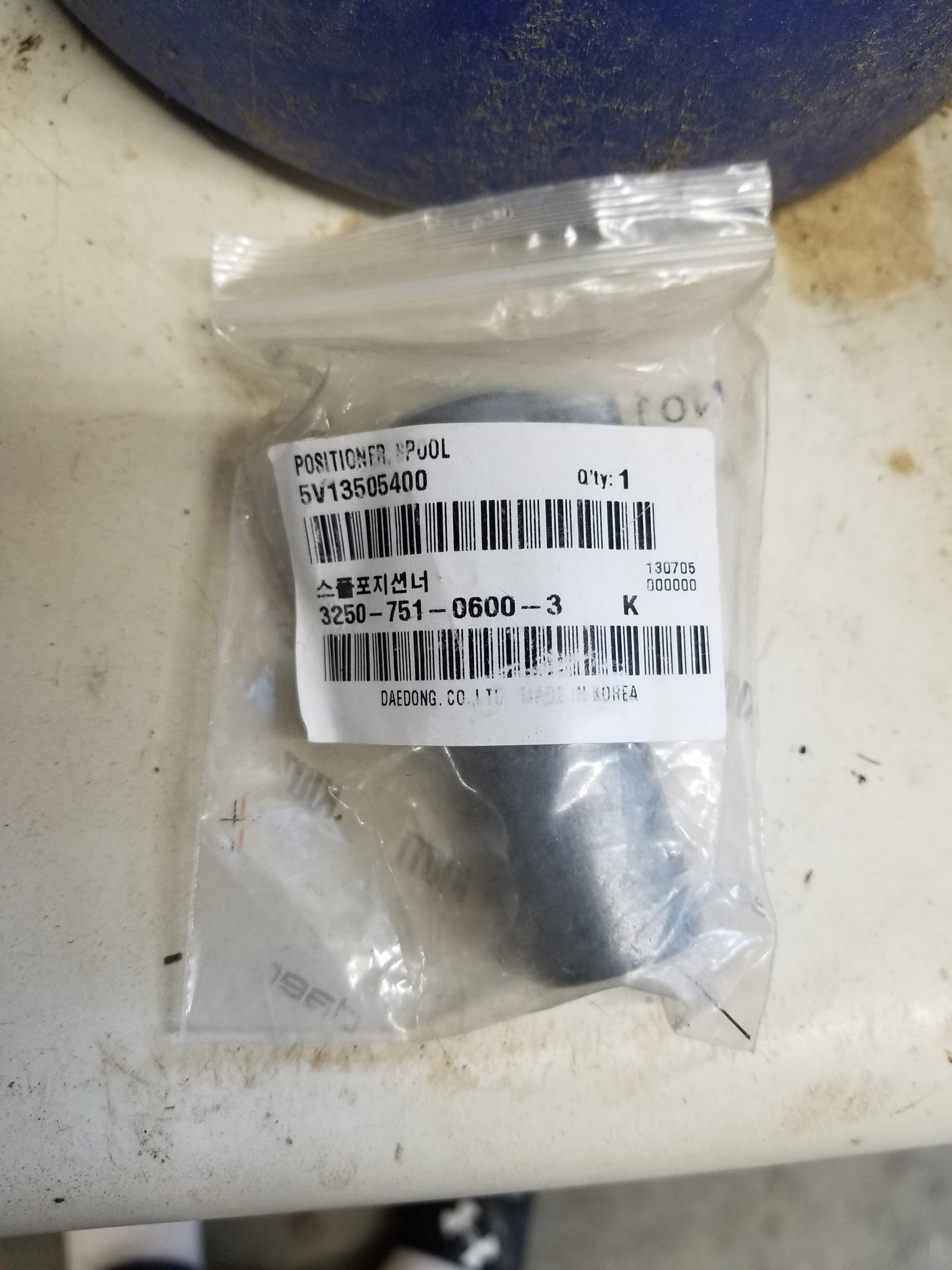

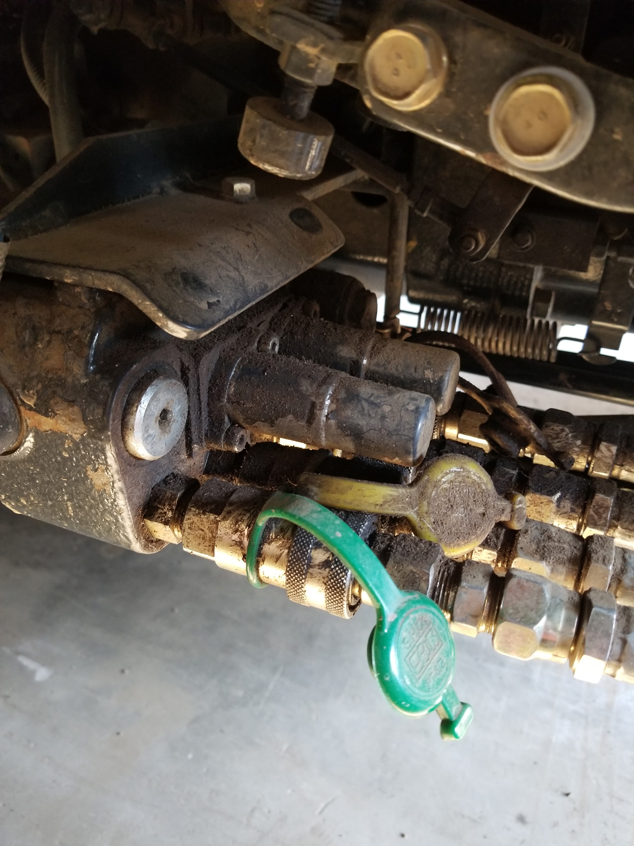

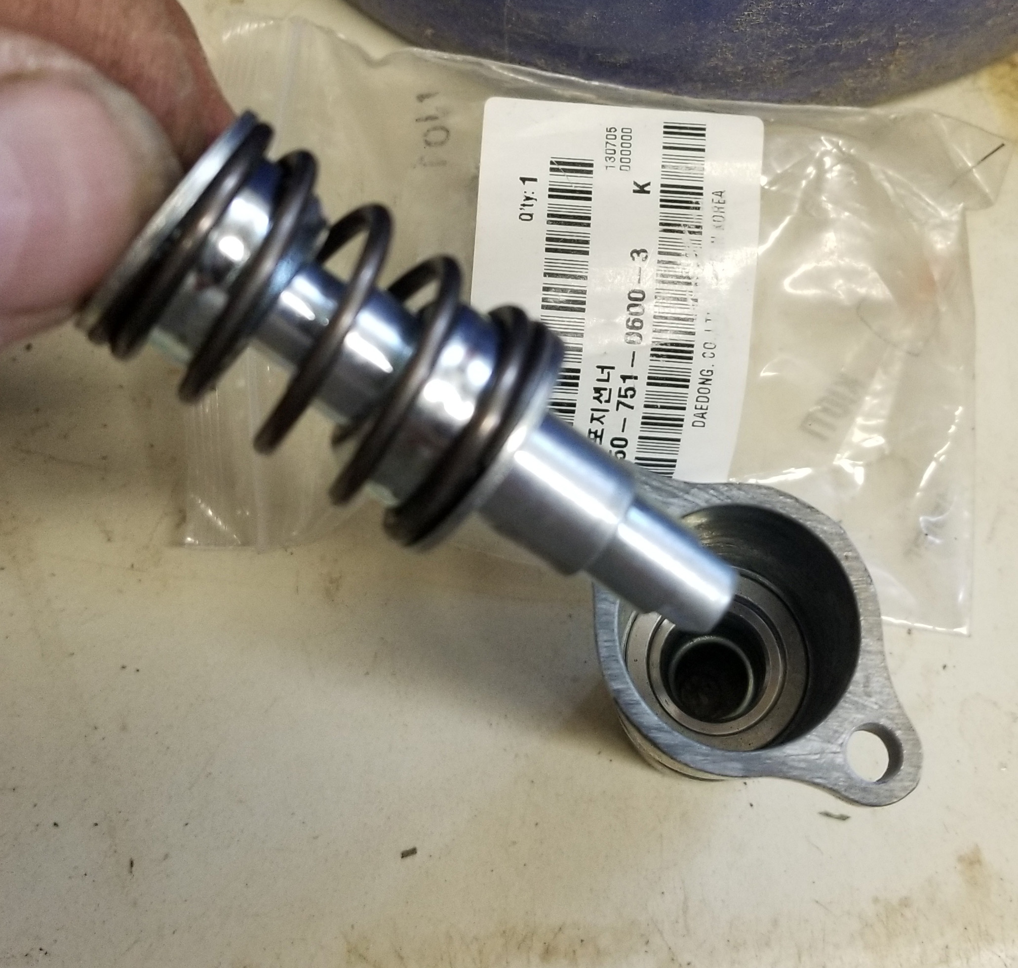

its called a positioner. its easy to replace, you just need to not be as lazy as i am. i actually got the part while tractor was under warranty about 6 years ago. still sitting on shelf. i hear that the part is not cheap though. with mine, the problem is it keep starting to work again. it did after i got the part. then failed during the winter. the next spring it was working again. its now working again. go figure. heres a few pics of it/ 20201102_144926.jpg 20201102_144940.jpg 20201102_144950.jpg 20201102_145030.jpg

Many floats on different makes ofl machines tend to wear out quite quickly. A few spring loaded balls at the end of the spool. Often a kit is available. I think the tolerences are just extremely tight because to look at a used non-functioning one, you couldn't tell that anything was worn out.
TIP: Grease up the balls before you try and put the new one together.
   / Would you buy your Kioti (or another) again? #108
In my case I had leaky o- ring and the oil caused the float balls to be slippery and not hold. Oh and I just replaced another leaking o-ring in backhoe valve body. Will no longer use factory o-rings, they turn to jelly. I’ve replaced them all.
