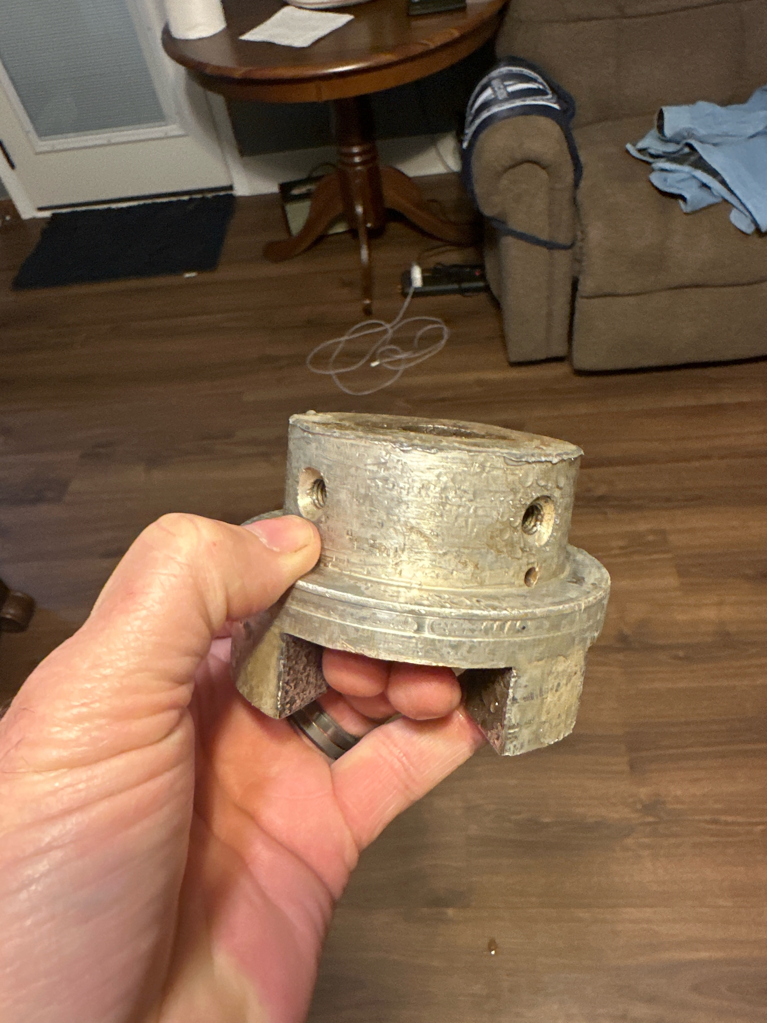

If you were to repair that shaft today, if it was removed from the motor, the cost would be less than $600.00. I would think it that the price in Georgia would be less.
Eric
Just trying to help the guy decide what to do. You have to take into account the labor cost and seals to rebuild the pump. If its a tram it is pretty complicated. If the cost is anywhere near a new pump, I would try a field repair and if it doesnt last, but a new one and have the old for a spare parts. Sucks either way. Sometimes you have to bite the bullet. Rebuilding the old pump has a higher chance of an assembly error and it doesn't look like an easy job to R/R the pump a second time. Just my 2 cents

Removing the pump on my machine, takes about 30 minutes. It’s not that difficult on the over unit. You just removed the cover plate, which is where your feet goes two bolts on either side of the pump to slide it out of the bracket that holds it the linkage which is three bolts, and then the hardest part is removing the hoses and marking them not too difficult on this machine I love how basic these machines are. My wife actually wants me to just go and buy a new one, but I’m not sure I wanna shell out that much money. I guess the tram pump on this is the most expensive repair for this unit. I bought the other pump before and it was around $600. The engine is about $2500 .
Doubtful PT made their own. No identifying markings on it anywhere?

It actually looks similar to a pump that’s on a Scagg STHM. I’m going to compare them because I have one on my other mower. If it’s the same one then I’m going to look around and try to find one on marketplace. They’re older machines, but they usually Have the engines go out on them before the pumps do before the pumps do

No, they don't make their own pumps. As I recall, they are (at least mine from 2001) is made by Bondioli & Pavesi.

Sometimes, with a little measuring and looking, a new part can be found cheaper than repairing the old one.

I compaired the pump on my Scag three wheel mower the model STHMcv from the [emoji[emoji6][emoji6]][emoji[emoji6][emoji6]]’s and they are identical. Now to find a used one to try out. The new pump from online from Scag is [emoji6][emoji[emoji6][emoji6]][emoji[emoji6][emoji6]]. That is half the price of the one from P.T.
