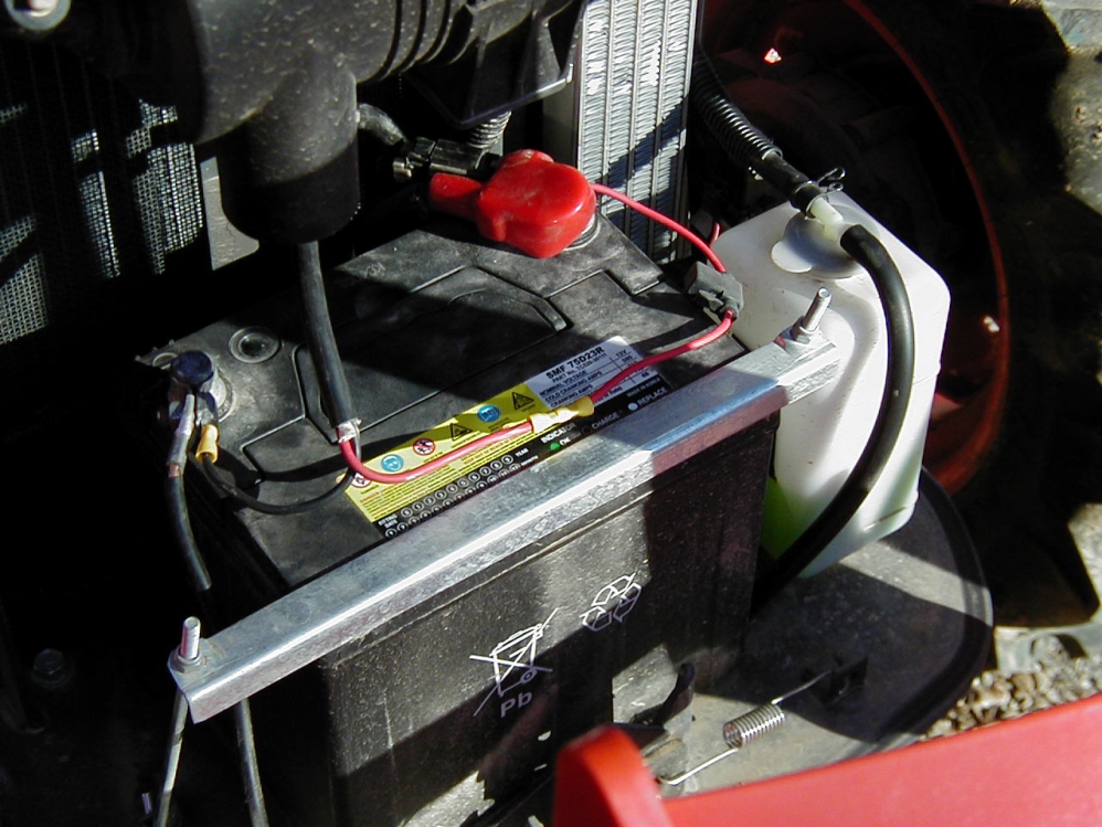

/ WR Long 3rd Function Install #5
When I added an Anderson SB-50 connector to my L3901DT to power my transfer pump, I went straight to the battery to get the power. I put a fuse as close to the battery as I could in case of a short it wouldn't burn the whole wire. This allows you to totally remove the power that you added and doesn't mess with the factory wiring.

Use the battery. My instructions indicated it as the best solution (I just installed my WRLong 3rd function the other day). Also, you do want it powered even with the key off so you can release the hydraulic pressure from the lines for service.
