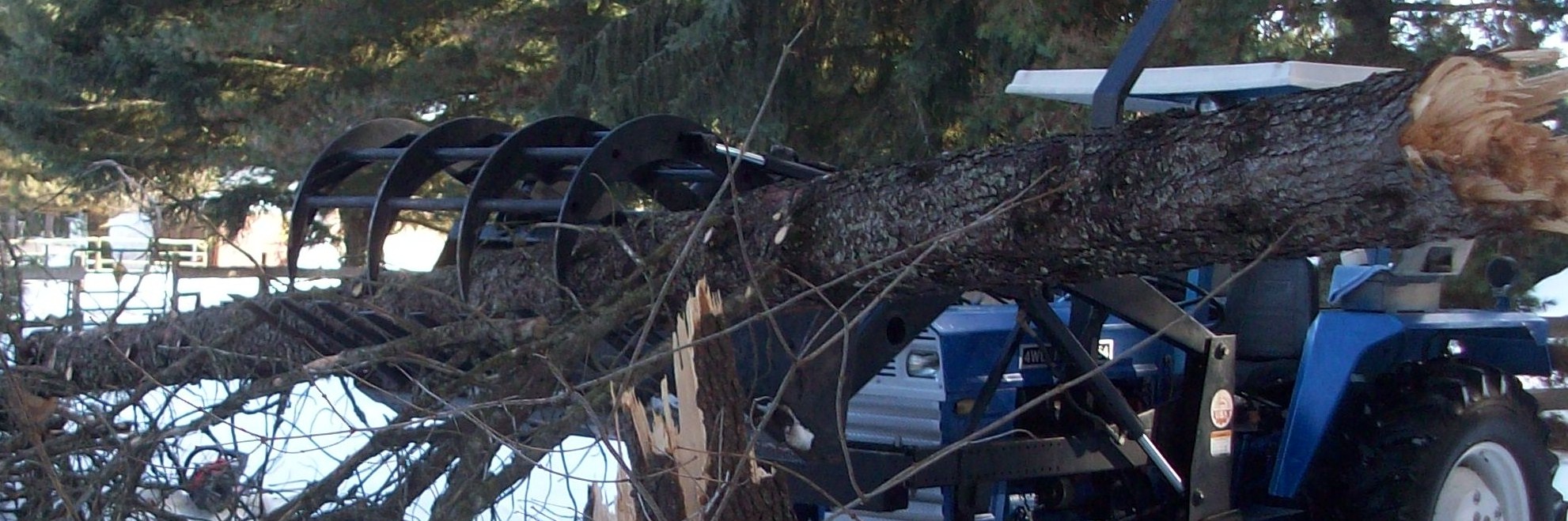

lwm- you can just grab the log diagonally like this Rhino-picking up blow down trees 003.JPG

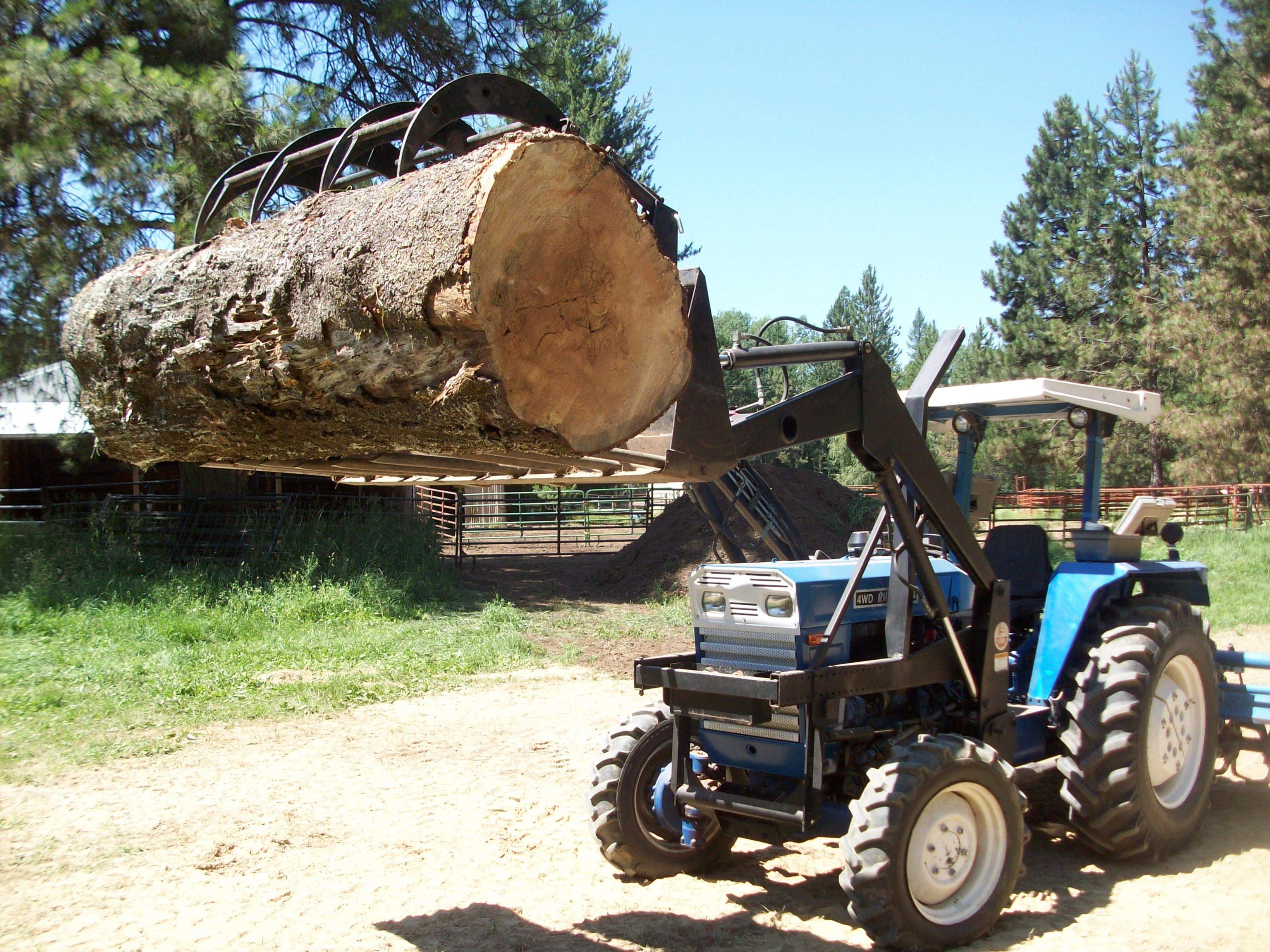

I thought you had mentioned having some large logs to deal with- post 52, and that is what happened to me lately-firewood 2013 007.jpg any larger and i am not sure if the grapple would have closed on it. but it sure beats dragging it .

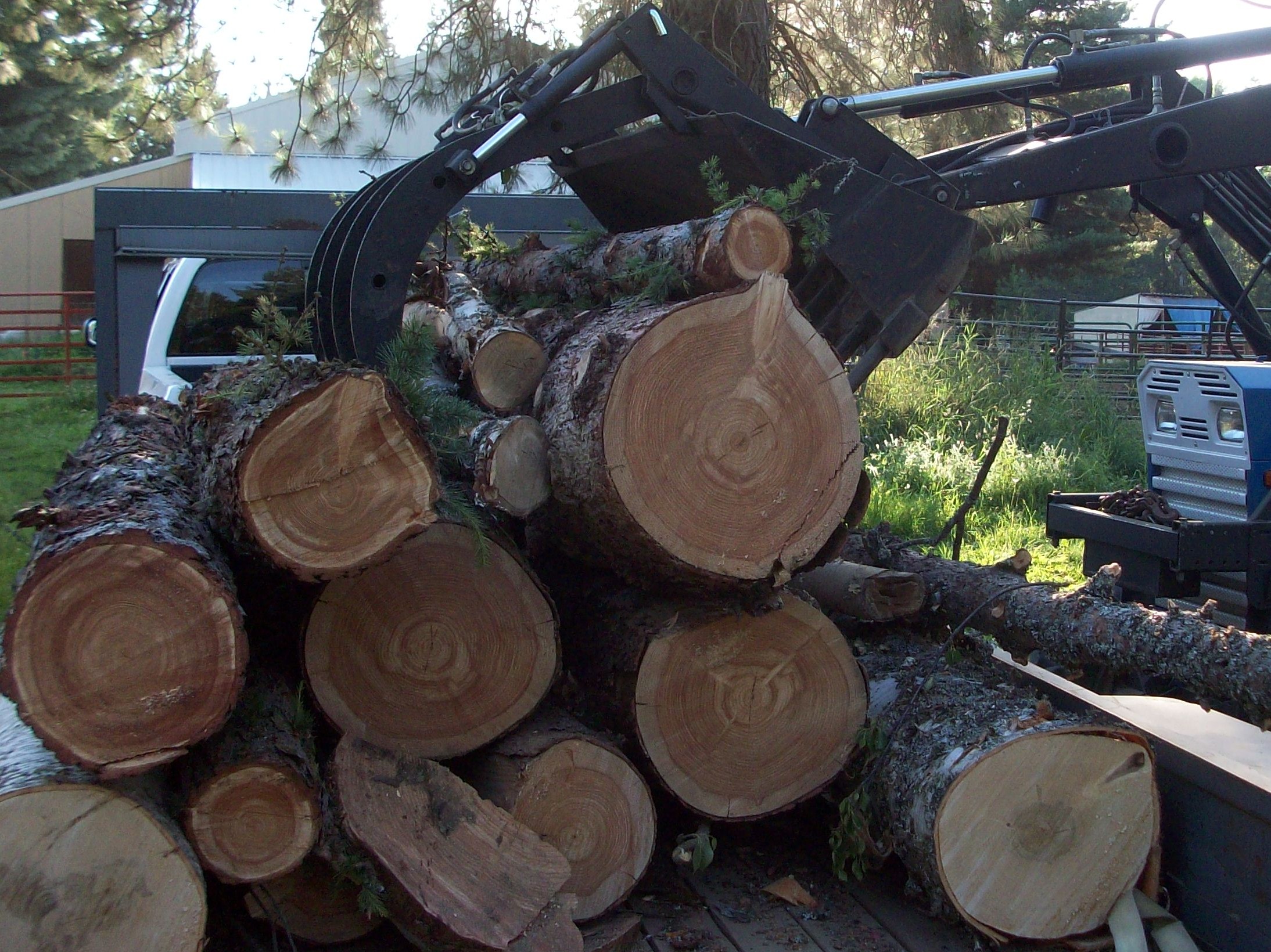

I think once you get some hours on the new set up , you will be glad that the grapple has a larger opening and Longer lower tines- if the movement of a small log bothers you can tilt the grapple back and it will be held like a v on each side like Xfaxman said, then it takes a quite a bit to get the log to actually move around oh and the style you got should be able to unload a trailer like this style firewood load 2 2013 009.JPG i have looked at the RBG style and i guess I just can't wrap my head around how that style can easily unload a trailer full of logs, maybe it's easy but i don't see how to do it it?? I agree with xfaxman and island tractor, running time is what is needed my :2cents:
