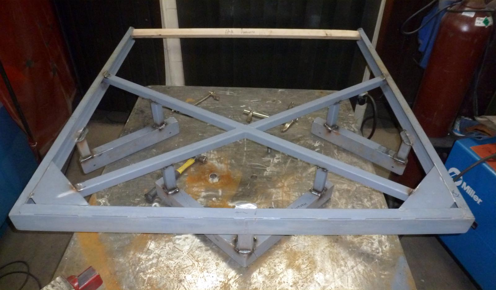

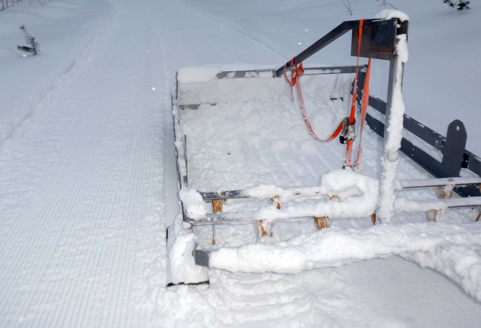

Here it is in the field this week. I did PM the fishhead guy.

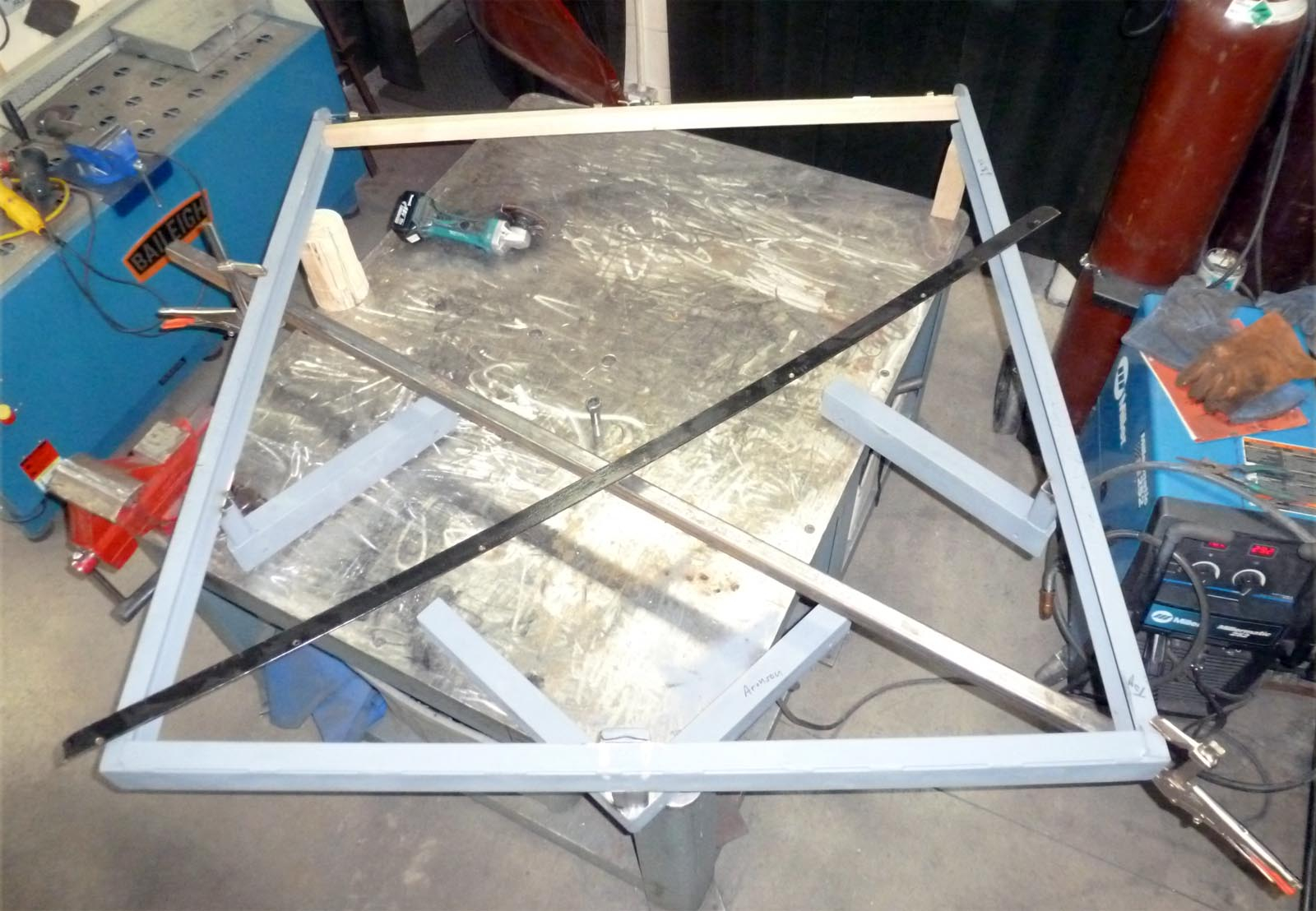

The cutter frame was worked on.
Top view, shows the cross-bracing that will be added to support the teeth. When we catch something, this frame really goes into high stress mode. :LOL:
   / XC drag build #147
Did you ever consider making the bars that hold the teeth able to pivot back if you hit something large? Kinda like the springs on a truck plow.
   / XC drag build
#148
No, that's to much work and its already overly complicated now. The frames are held on at three points, the two rear pivots and one in the front via the actuator. This allow enought flexibilty to move up when you catch something, while not getting damaged. The KISS design is your friend.
   / XC drag build #149
The frame is 5ft wide plus wings, so with them, it will be around 7ft. Its close to 8ft long without hitch. Weight I'm not sure, it might be 125lbs but its also unfinished. Weight is not all that important for snow implements.
Even covered with snow, the entire unit can probably jump a little if it hits a immovable object.
   / XC drag build
#150

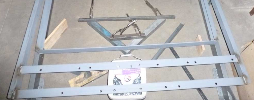

As promised, here is the tooth frame. Whats not seen was gussets added behind the down tubes that hold the tooth angles on. The angles that hold the teeth on are lowered so as to allow materials to flow over there tops.
Any questions?
