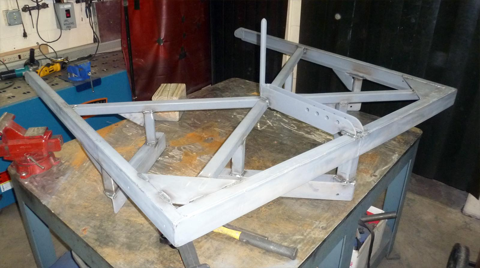

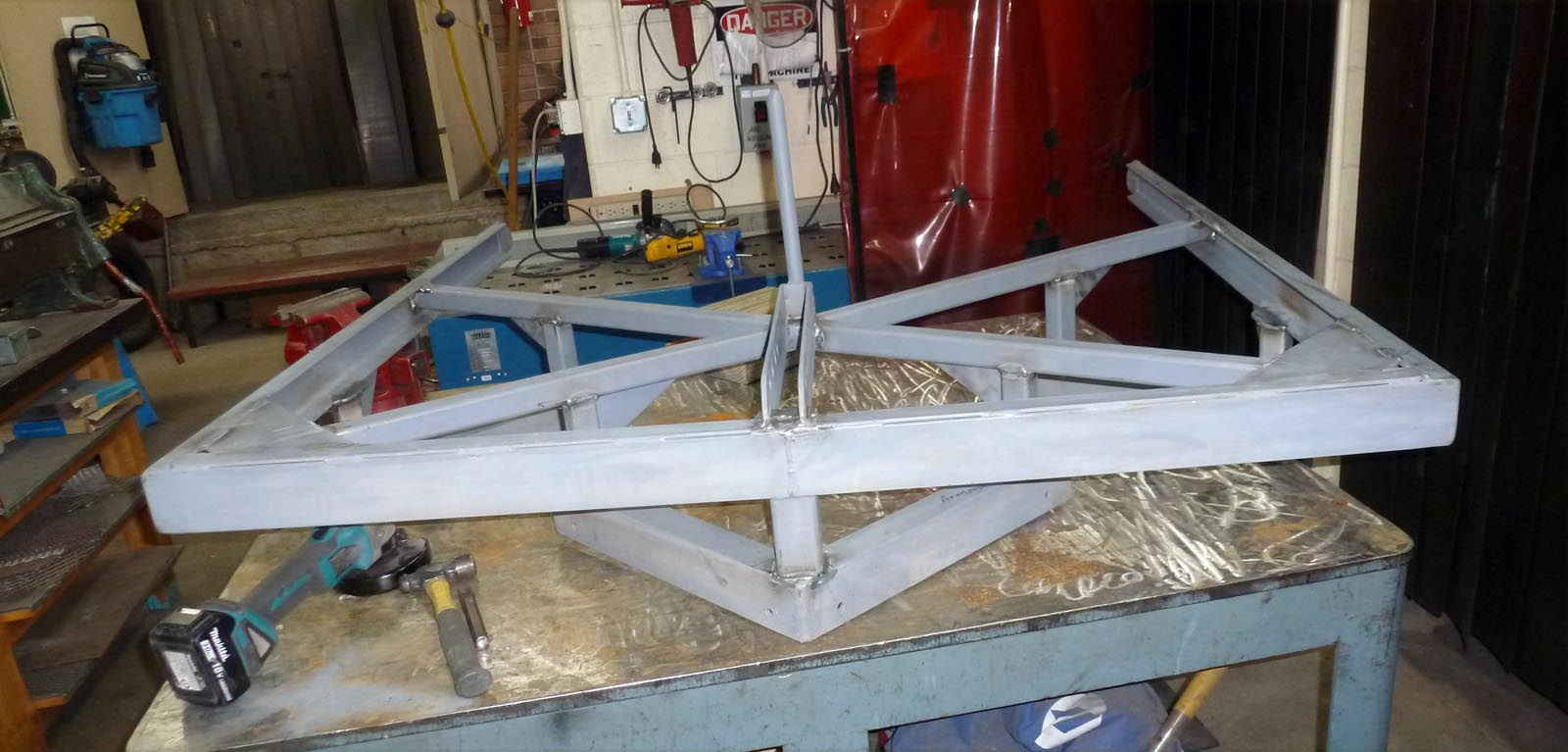

We got cold as %^#! here and been off the trails. On the south shore we call cold zero degrees. I'll be in the shop the next two or more days off of work and at the school shop to work on my project. Just ordered $150 of 14 gauge wire for 2 drags. Grooming trails is a cheap business..... :LOL:

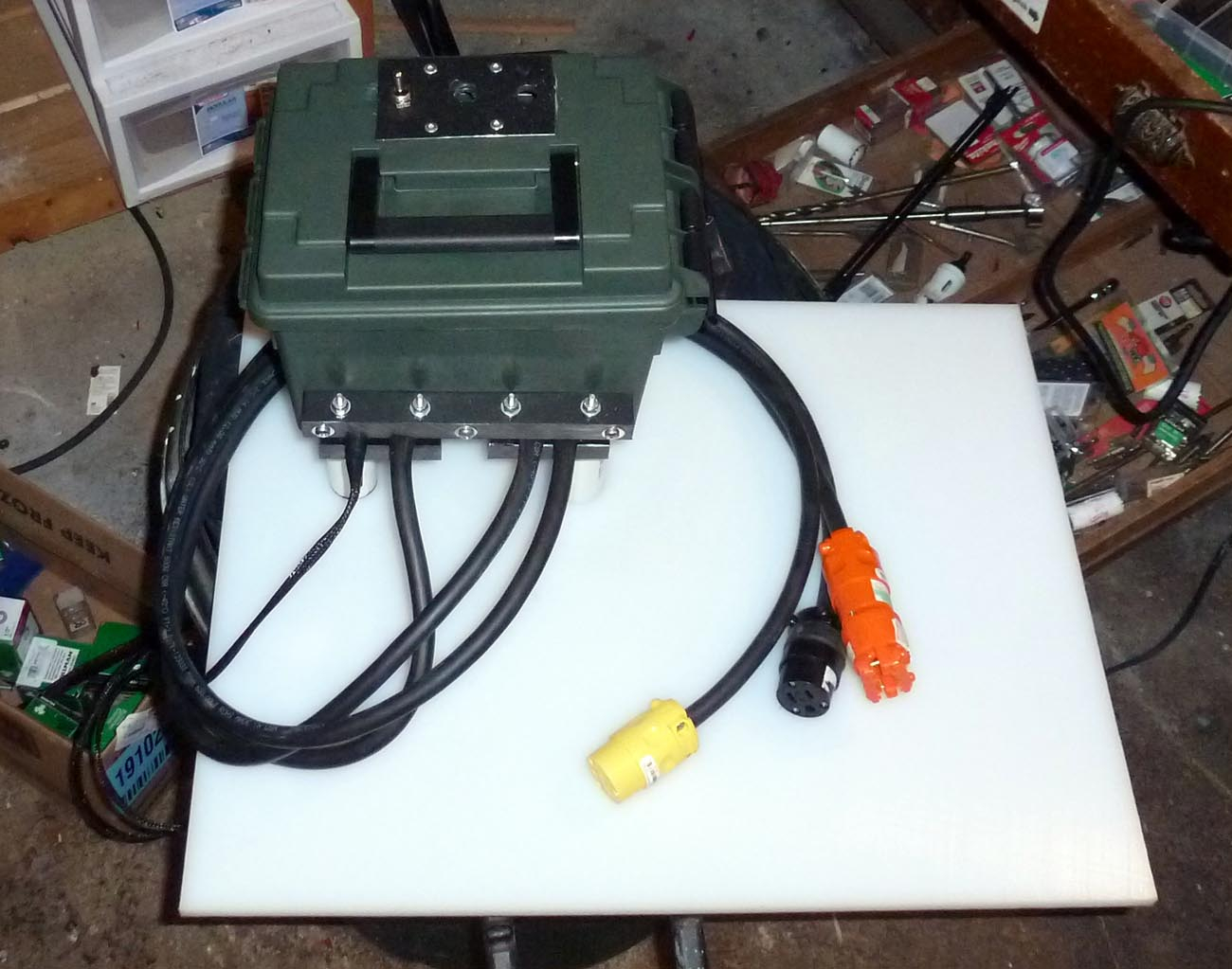

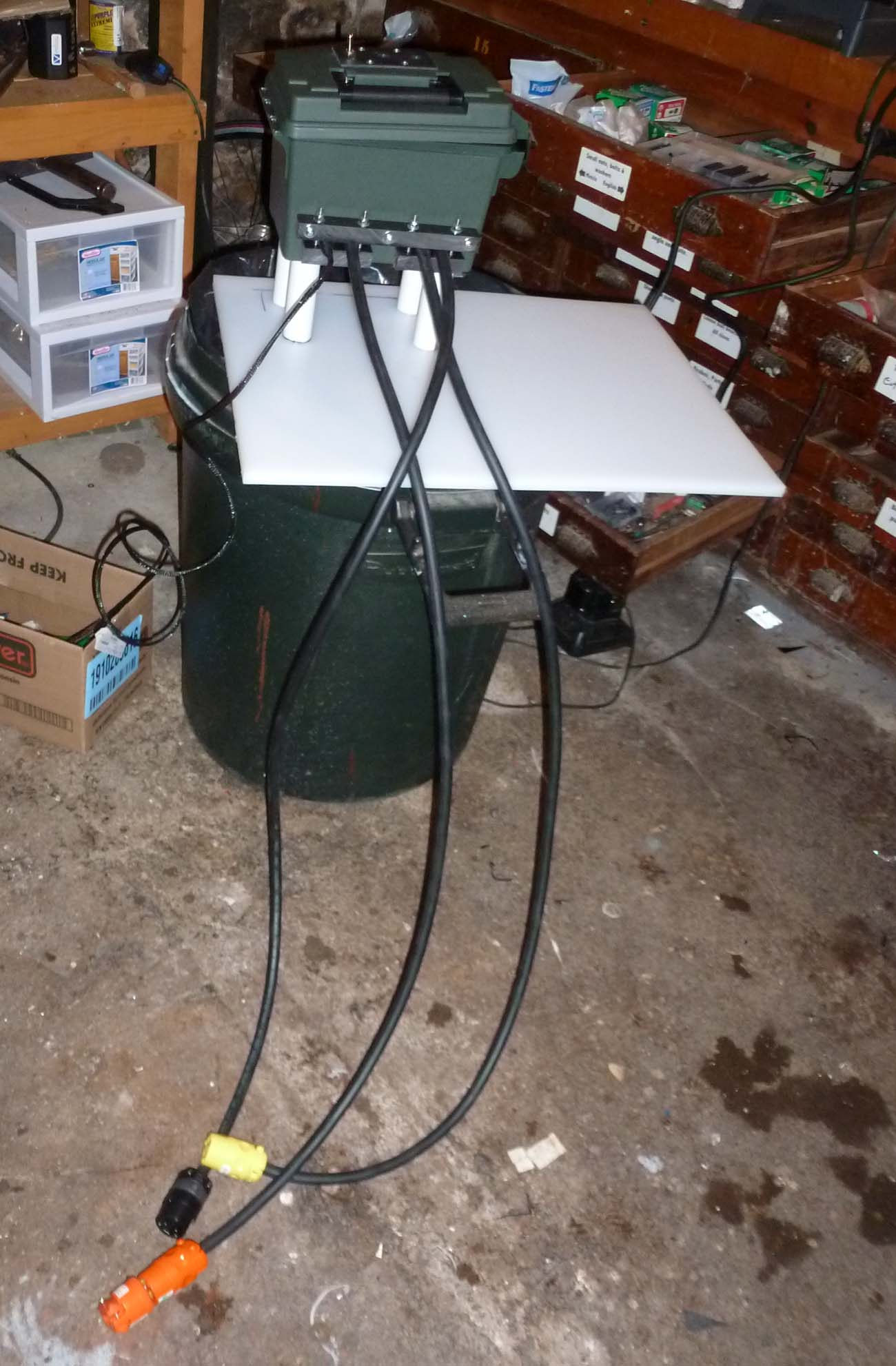

I have been working on these implements but nothing worth taking pics of. I did get the control box partially done today. Its done enough to make a test run with it. The white HPDE plate its mounted to is to hold it in its correct position in the the Bosses box. 2 more switches will be added to it.

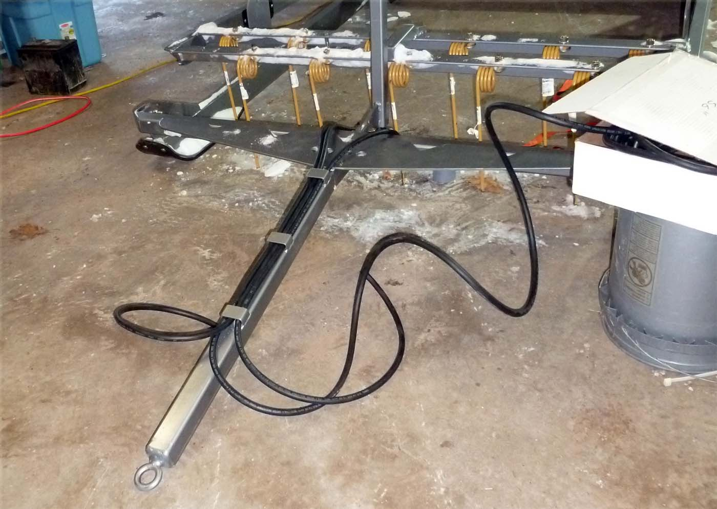

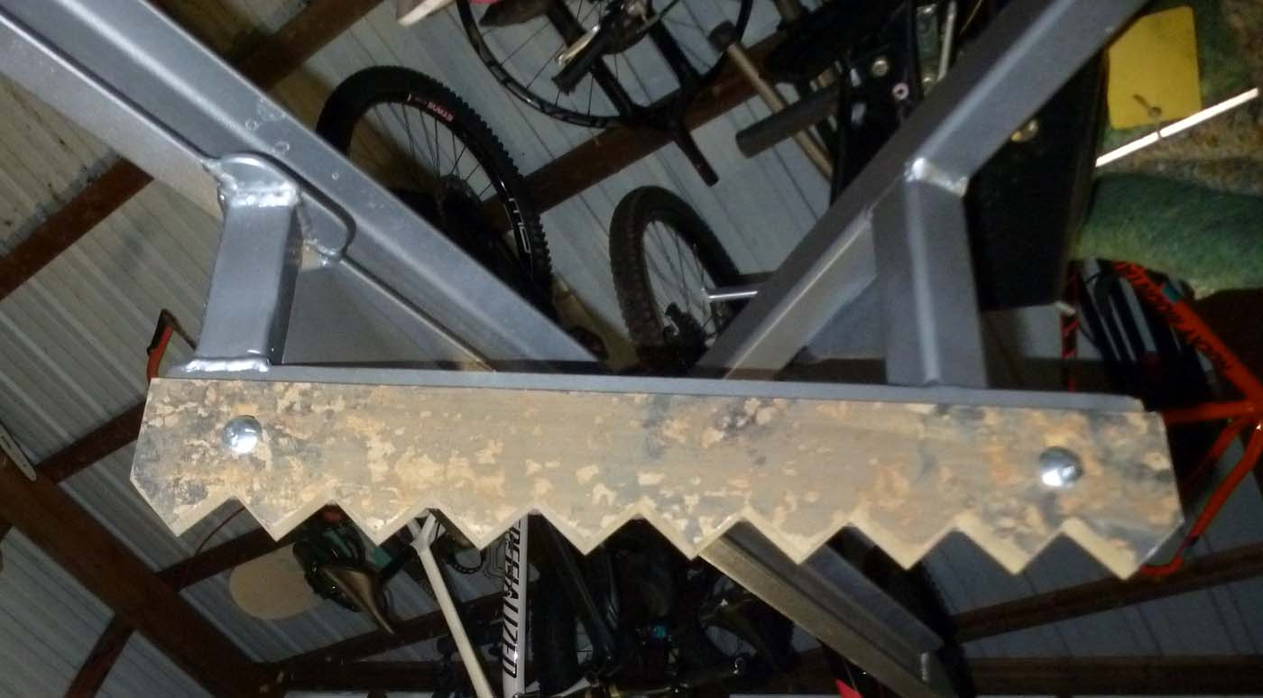

Cutting teeth were made and the frame to hold them was installed over the weekend. Groomzila was also wired but we've been receiving enough snow that yard plowing and grooming the trails has taken priority. A break from snowfall would be OK!

Looks like it works great. Nice build. I would really like to see how it preforms on a hard packed trail that has seen heavy use and no fresh snow. Some winters around here we can get long periods of time between snowfalls and the trails get very hard packed and beat up from use, this year is an exception to that though. IMHO that's when you know how good a groomer really is. I have seen tires bolted together make a nice flat trail(without the grooves) after a fresh snowfall. If I had to guess as to how your groomer would perform in this type of situation, I would say pretty good. It seems to have good snow engaging points to rip up the hard pack and also the weight to make those points do what they are designed to do. Its hard to tell by the pictures, so correct me if I am wrong, but the only issue that I could see being a problem in these conditions is the snow engagement points are not/can not be adjusted to extend below the level of the skids.
