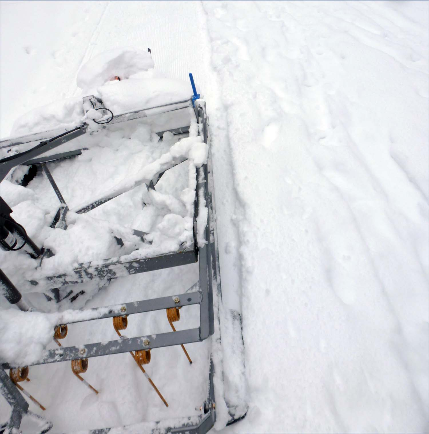

Well, it has gone into service but its not really done. Wings have not been added and a few other minor details uncompleted. I was out this am doing some modification to it in the field. Our grooming season is coming up on the end.

The Polaris still misses at times. We are still trying to master its cause. May be low battery when winch is used.
The wings are flexible have comb and weights on them. These make the edge of the trail more skiable. See pic below of what they look like. Its circled.
