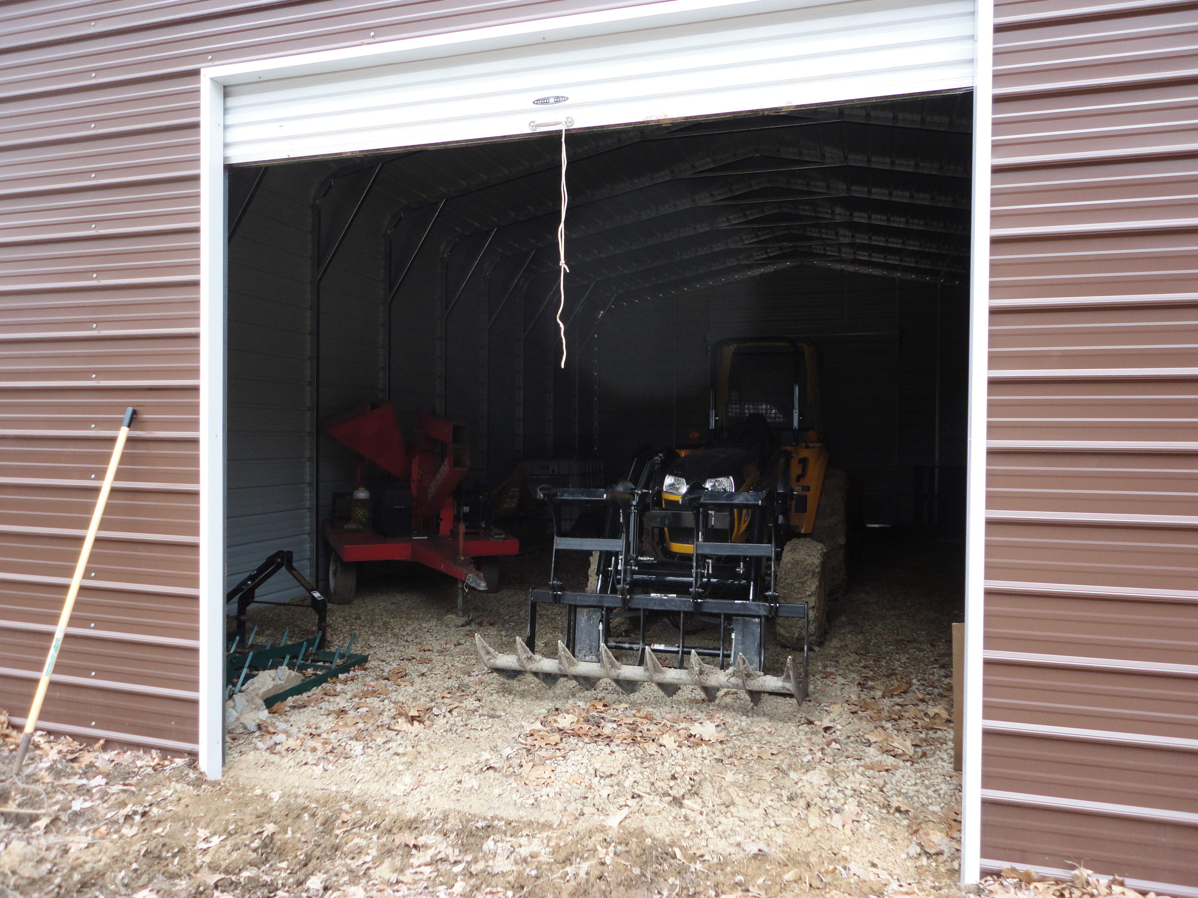

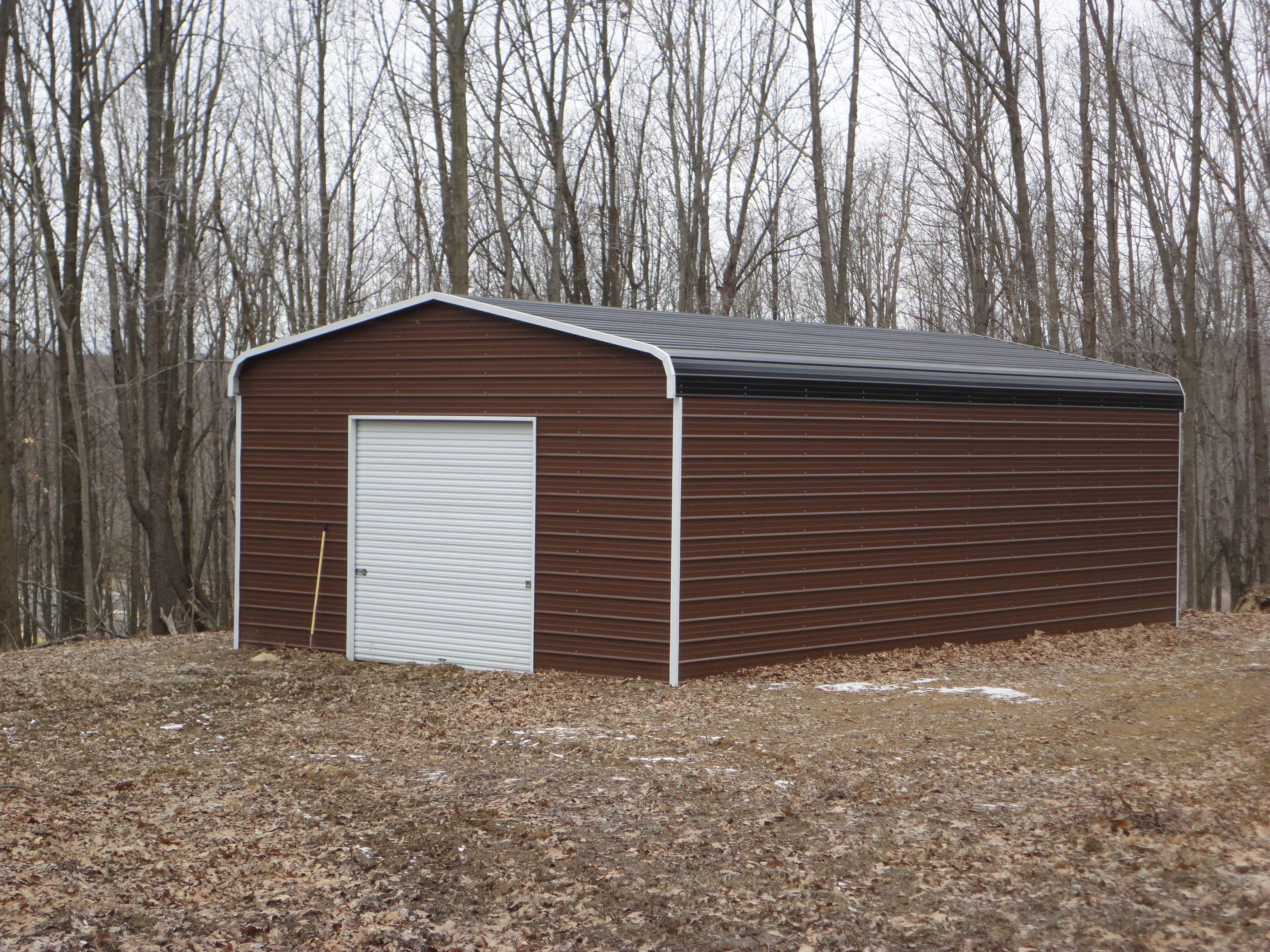

As for structures, I'm on board with the "less expensive" version of storage.....carolina carports as well. Got a 24' X 41" enclosed with 2 10'X 10' rollup doors installed for around 8500. I do need to get the ceiling foamed, it loves to sweat..... 506.jpg501.jpg

Foaming the ceileing is probably a good idea, but I added 2 vents on the side on each end , and it helped tremendously. I think turbine vents or a continuous ridge vent would be better, but I could not figure any way to do it. as you cannot walk on the roof.

I was thinking about that in lieu of the foaming, which will cost around 1500.....:eek: Did it eliminate the condensation completely, or somewhat? It's raining in my building at times, which defeats the purpose of the enclosed storage......

I would put it about 80 percent better. I just did it last fall, and I need to go thru more time and weather variables to be sure, but it seems to be a definite big improvement. If you had power in the building ( I dont) and ran a small fan to draw air thru all the time it would probably eliminate it totally.
I think 2 or 3 wind powered turbine vents would work perfectly, but I could not figure a way to install them. Why not try the vents, they are low cost, low effort, and if it doesn't solve it completely in your climate, then you haven't lost much.

That sounds like a good plan, think I will try it and monitor. I also dont have power to the building. I was wondering about climbing on the roof, and the turbine vents sounds good, but also unsure of climbing around on that metal....and getting a good seal on the vents as well.....

By the way I used Stainless Steel hardware to fasten the vents to the sheet metal, and when I cut the sheet metal out I spray painted the cut edges with clear Krylon paint. The idea is to prevent rusting and staining the building. The cutting was no fun, I used a sabresaw, but there is nothing to press against, and was difficult to cut. If you come up with something better let me know:thumbsup:
