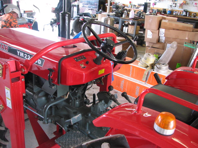

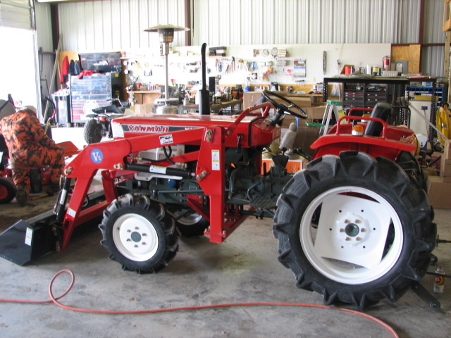

I have searched the forum but can't really find a good answer for a guy who don't know a whole lot about the hydraulics. I have a Yanmar 2210D, with a V-Tek V2 loader. I bought it a couple years ago at Bid Reds in near Fort Worth, TX. The right seal on the joystick keeps blowing out. I don't know which valve this is, the in or out. Any thoughts. I love the tractor other than this part of it.
The bucket dosen't operate at a normal speed when lifting or unloading, has a lot of drag in it.
Also is there anywhere I can order a new joystick for the V2 loader? When i was replacing the seals in the valves I broke a bolt (very cheap metal bolt) in the joystick that runs through one of the valves.
Thanks Guys

I have the same loader but not sure if we have the same joystick valve. Mine is a BLB Model BM-40 - if not, take a look at the valve for manufacturing markings and google is your friend. I have a manual I can send you if its the same...just PM me with your email address. FWIW, this is an Italian made valve and only found a few folks in the US familair with it. I spoke to Beiler Hydraulics who can get parts....but in my case, I am waiting for it to fail so I can replace with a more standard valve that includes Power Beyond and Float. - I don't have either in mine.
As for blowing a seal - if you follow the plumbing you should be able to figure out what the in and what the out is - plus the manual will help. I installed a gauge onto mine to help me see what my pressure is. thats simple to do and any hydraulics place can get you the tees and the gauge. If you are making too much pressure that could be the cause of the seals blowing.....I am not a hydraulics guy....but the gauge and the manual is the first step I would take.

Well I called Big Reds in Ennis TX, where i bought the tractor, they said yeah it is probably the joy stick assembly. $350 later the seal still blows. I'm frustrated to say the leaste. I can hear the loader under pressure when i have just the slitest load in it. I am assuming the pressure to the valve control is to high. The bucket lets down at a decent speed but when i try to pick it up or tilt it, it is extremely slow. WTF

How is the tractor's hydraulic system plumbed? Does the hydraulic line from the pump go to the loader valve, then the rear lift in series? Does your rear lift leak down faster than it should?
/ Yanmar and V-Tek Help
The hydro system is in one series. The back box blade does seem to leak down faster than it should.

The trouble may be excessive pressure developing from the rear lift. When the rear lift valve is activated, the loader valve isn't in use, so is open. But I think that when the rear lift leaks down excessively, it is, in effect, in near-constant activation to maintain the position. I think this pressurizes the outlet of the loader valve, and hinders its operation, since the "out" of the loader valve is having to push against the pressure required to maintain the rear lift. I also suspect this is what is blowing seals, because most of the loader valves aren't designed for pressure in that manner.
I don't have a developed theory about why using the rear lift doesn't rupture seals in the loader valve the loader is not being operated. A quick test to see if my suspicions are true would be to lower the rear implement down the ground, and experiment with the loader and bucket. I predict it will work much more quickly and with more strength, than with the rear implement lifted.

If at all possible Id plumb it with a power beyond rather than the in series I can almost promise it will work better that's the way it is on all other equipment. The rebuilders are taking a short cut here and they are not doing us any favors other than mounting a loader. my .002
I always suspected my 3pt causing back pressure or restricting the return and slowing my loader down now I can guarantee it was now I redid the plumbing to include PB.

When i bought the new joystick assembly. It came with different O-Rings. They are white, look like teflon to me. They are hard, not rubber. Now it seems to want to leak from the nozzles on the joystick assebly. To me that means there is too much pressure.

Well shucks, I was hoping you were close by. I would love to see your setup. We are about 270 miles apart. Any chance you could take some pictures of your setup. I feel like we could give better advice if we could see just what you have.
