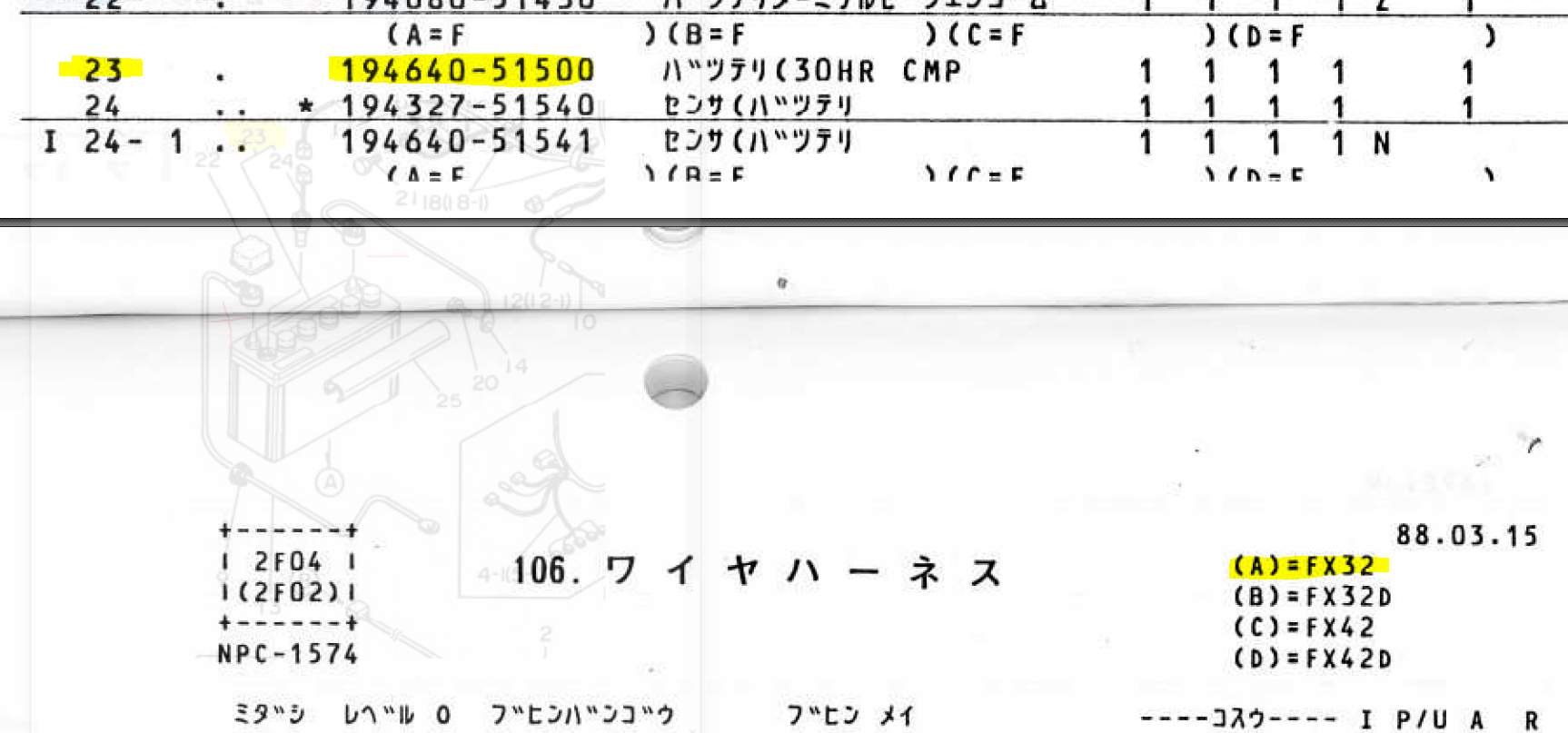

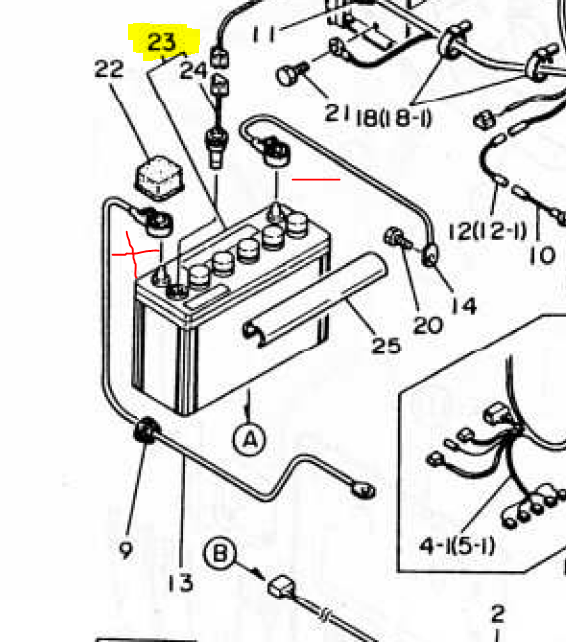

Cross reference to the battery shows,
Group 34 & 75 both fit.
