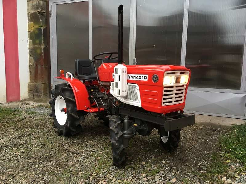

According To: Pickpaint :The red was just a little lighter than Yanmar red and Case IH was a little darker red. Back in the old days (before we had the color matched paints) we would paint tractors with a 30/30 mix of the two. It came out close enough that you would never know the difference.
Rustolem Apple Red. It matches the same red Fredicks uses on their restored machines.

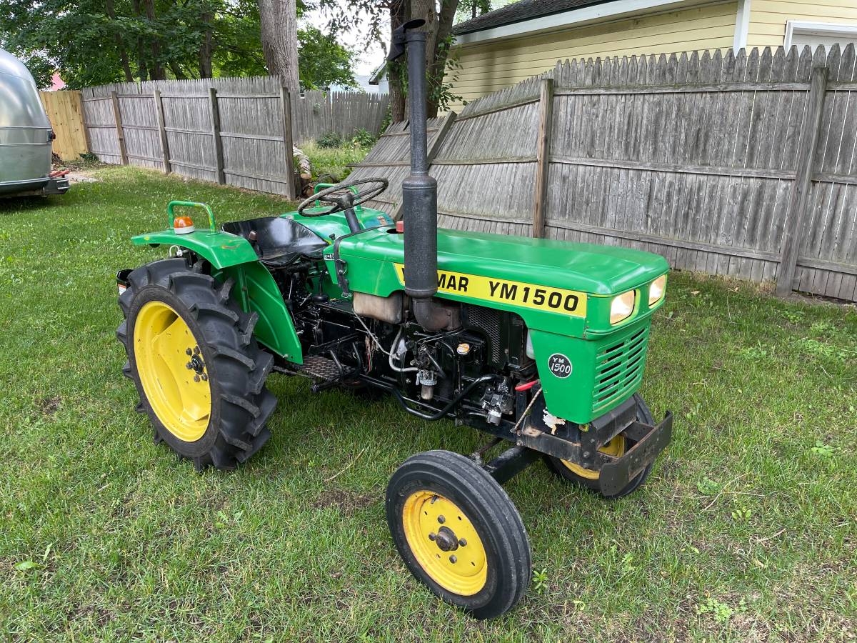

Or just simply paint it John Deere Green and have a YanDeere. 😄
It's a very common thing to find a Yanmar looking like a Deere when you can't match the red.
It's now open YanDeere season

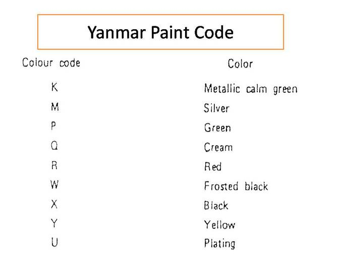

From the YM manuals,
YM frame paint original should be this pantone,
And yet, the available colors from refurb places can be nearly anything green or dull black.

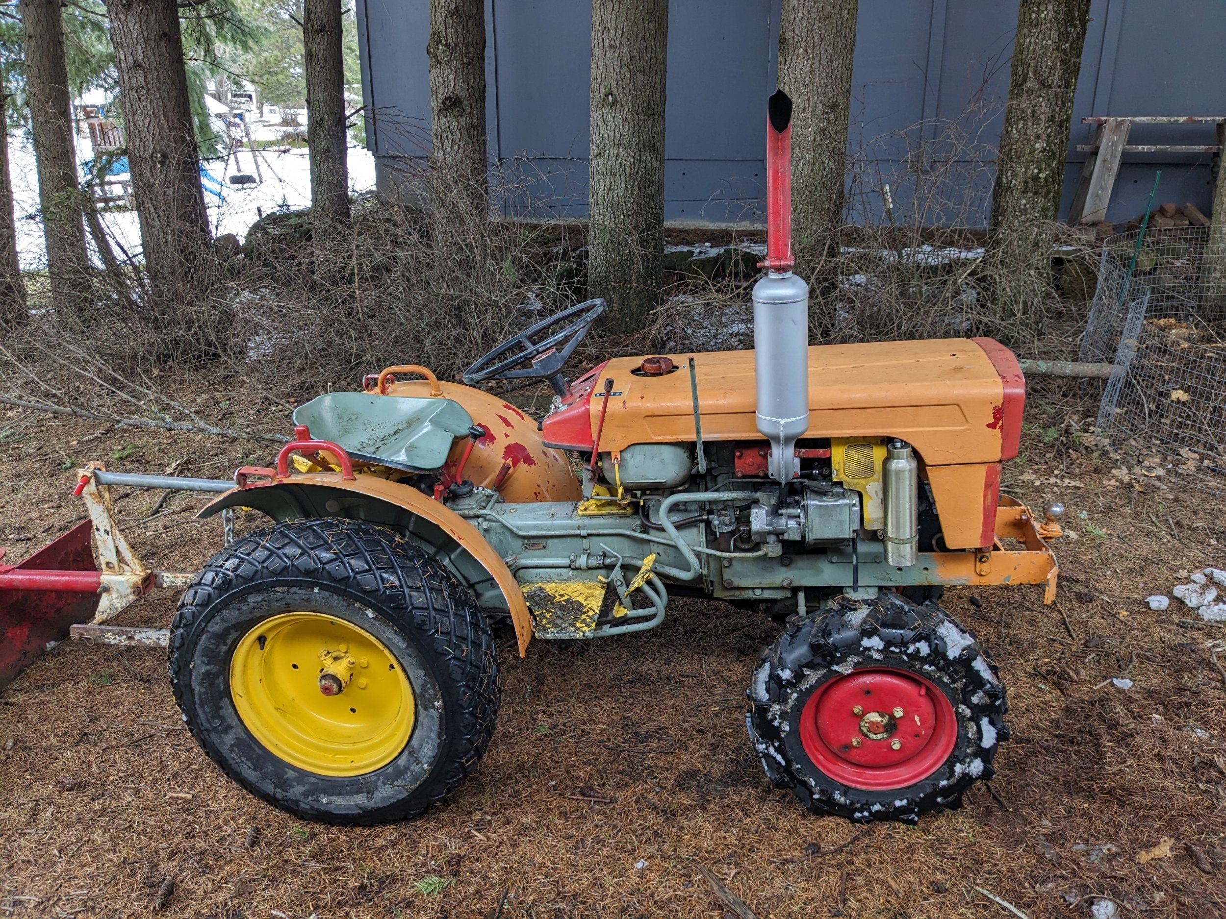

Thanks for the input. Here's the mashup of paint I'm starting with. I don't intend to make it remotely perfect, but just bring it back closer to the original colors.
