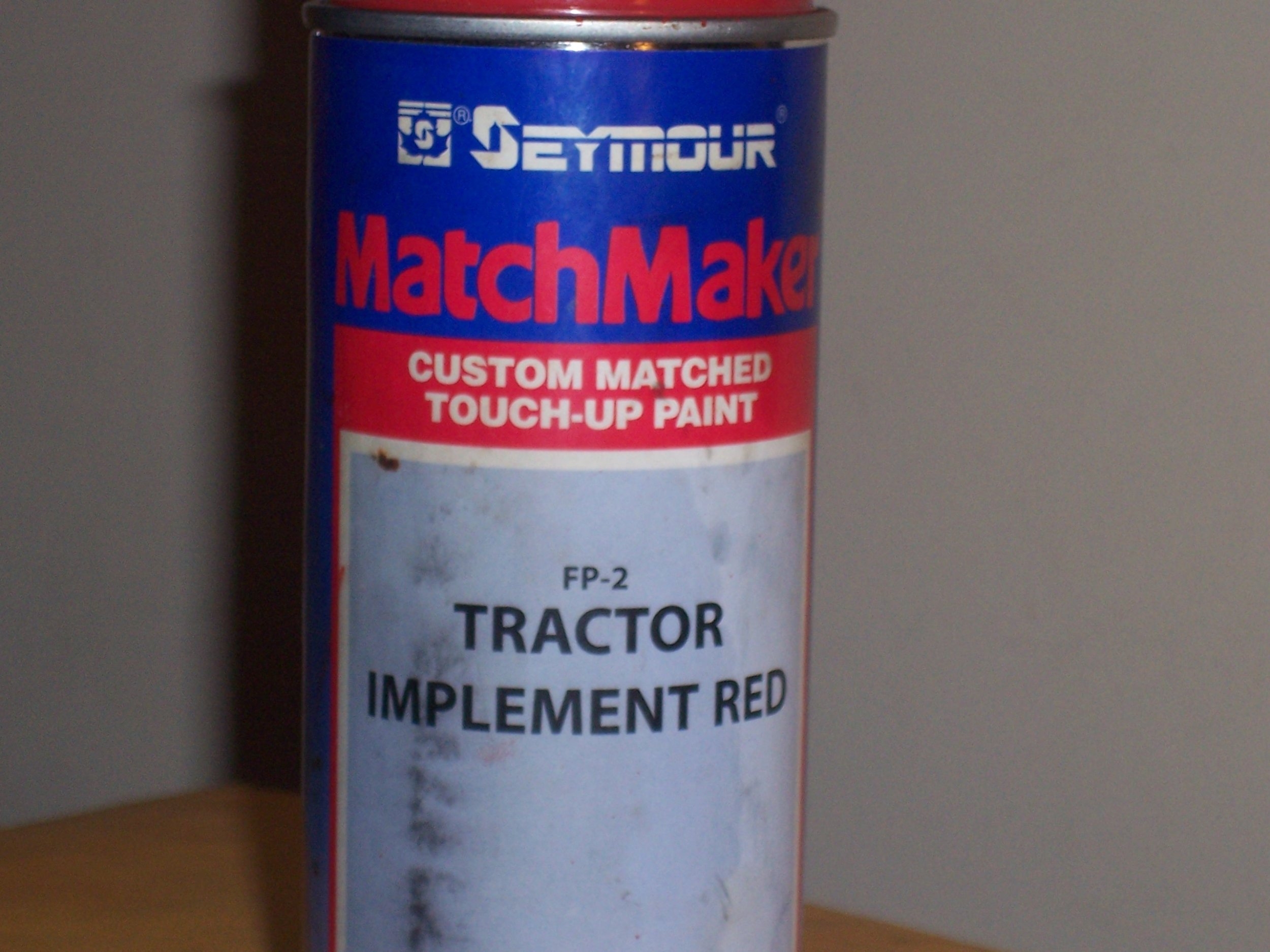

Fredricks is what I used to touch it up. Red was really good for the small light spots. White is Dull compared to Org.. Head lights frame shows that! Grn. seemed Dark but not really noticeable but was in Excellent condition and didn't use much. My guess is it might be the brand that they actually use to refurb the tractors.

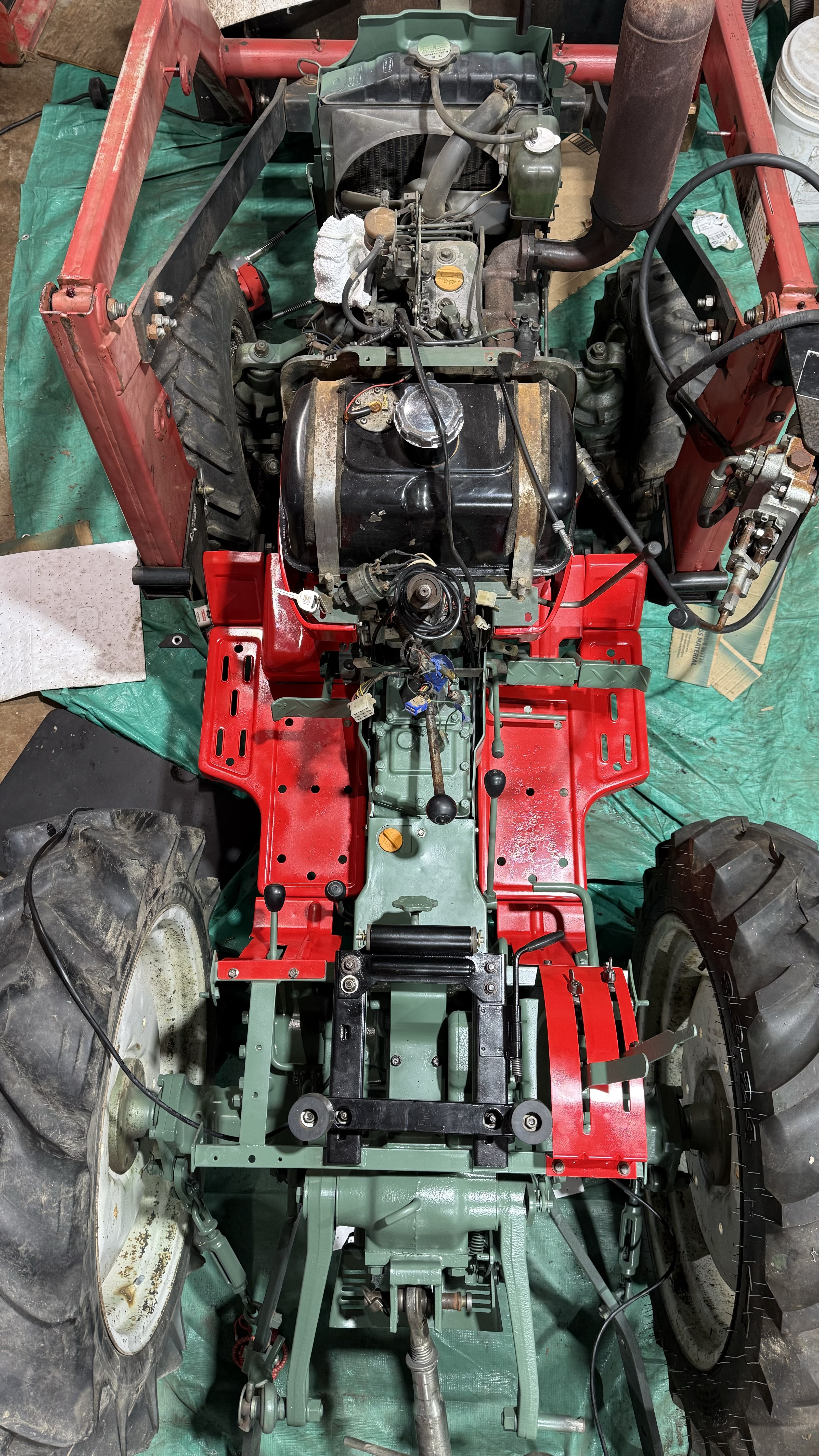

Thanks for the input. Here's the mashup of paint I'm starting with. I don't intend to make it remotely perfect, but just bring it back closer to the original colors.
Since your not starting with any color match concerns the Rustoleum Apple red is a decent match for the body panels and their Spruce green is popular for the frames on the Frederick's reconditioned units. I took a frame color part off on my YM and cleaned it up for a color scan that blended well.

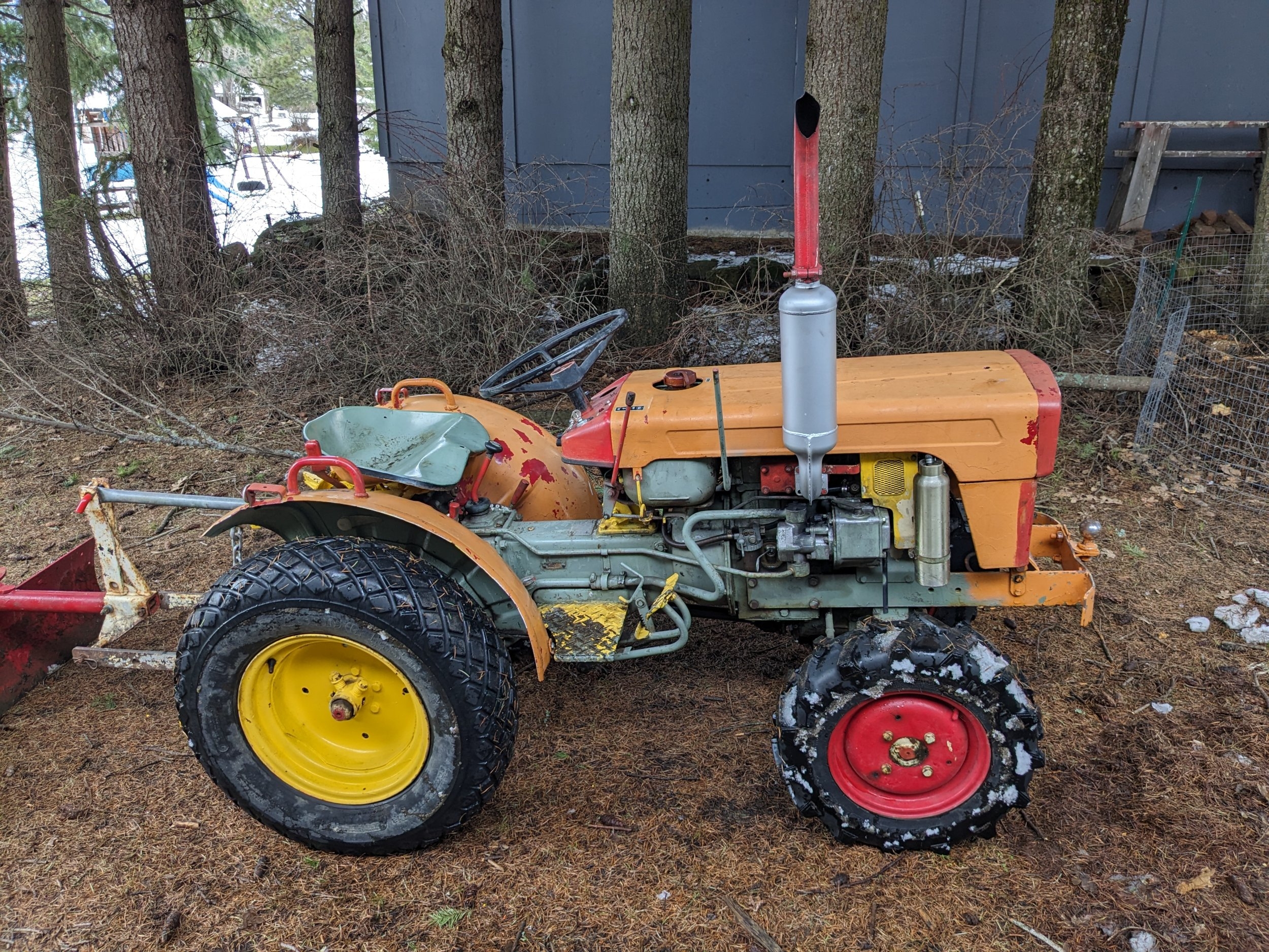

I'm trying to fix up a Yanmar YM2002D. While fixing it mechanically, Thought it would be good to paint too.
I've read thought the 5 Pages and have started on using the Gloss Apple Red334024
On the 'Body' I've got no clue. I think it's a Green color, though there is some kind of goldish pain that looks like it was done in a rush, plastic brush can take it off. I like the Green that is there, so I'm hoping for another Rustoleum that may be close? Also what about the 'White' side panels or the Rims? Anything for Those?
The Family
Thanks!

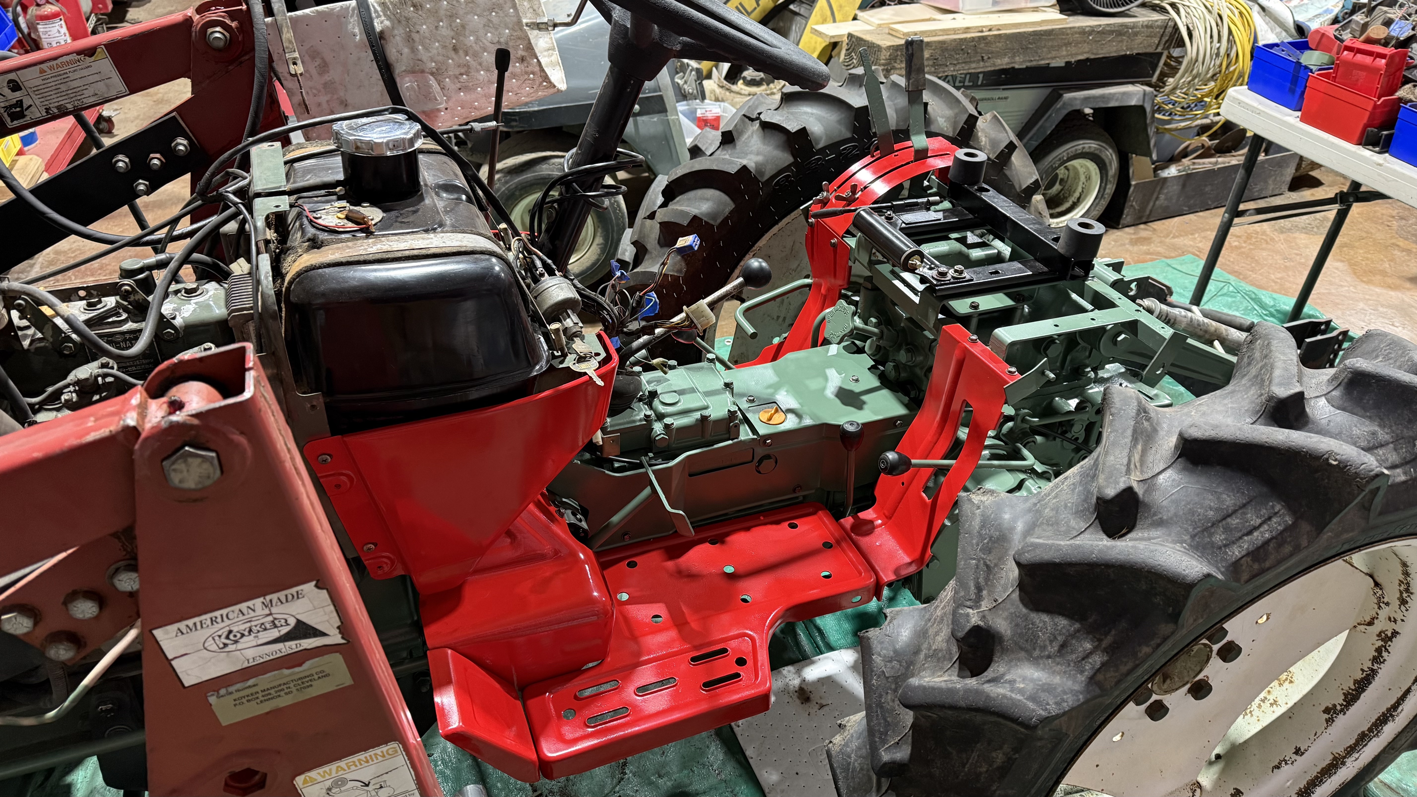

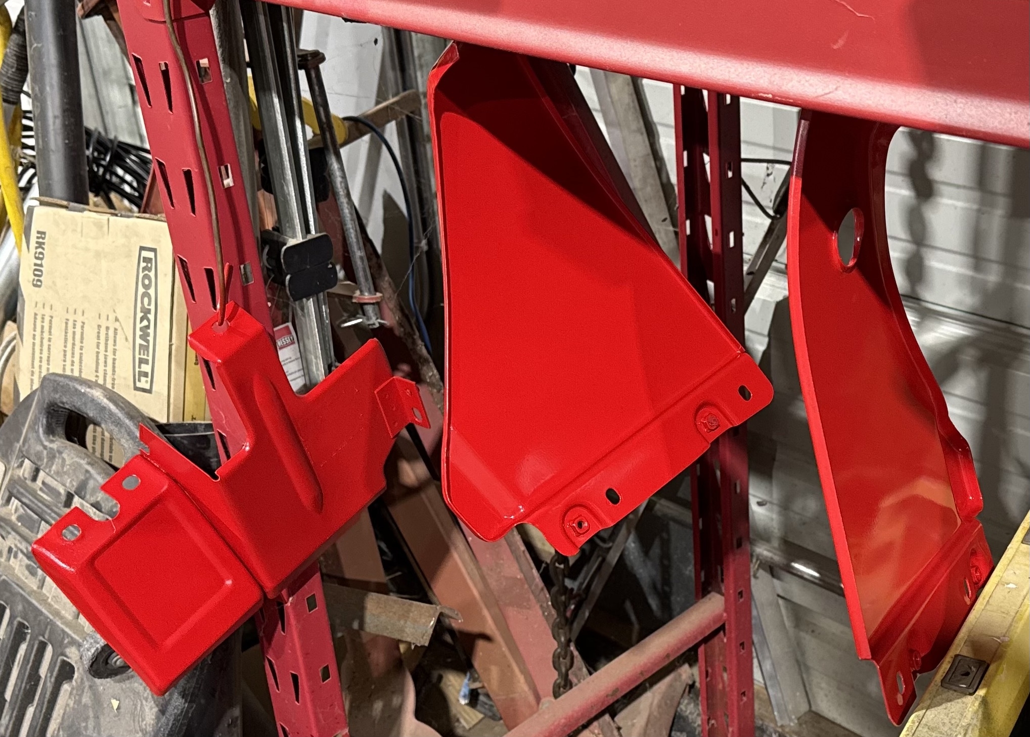

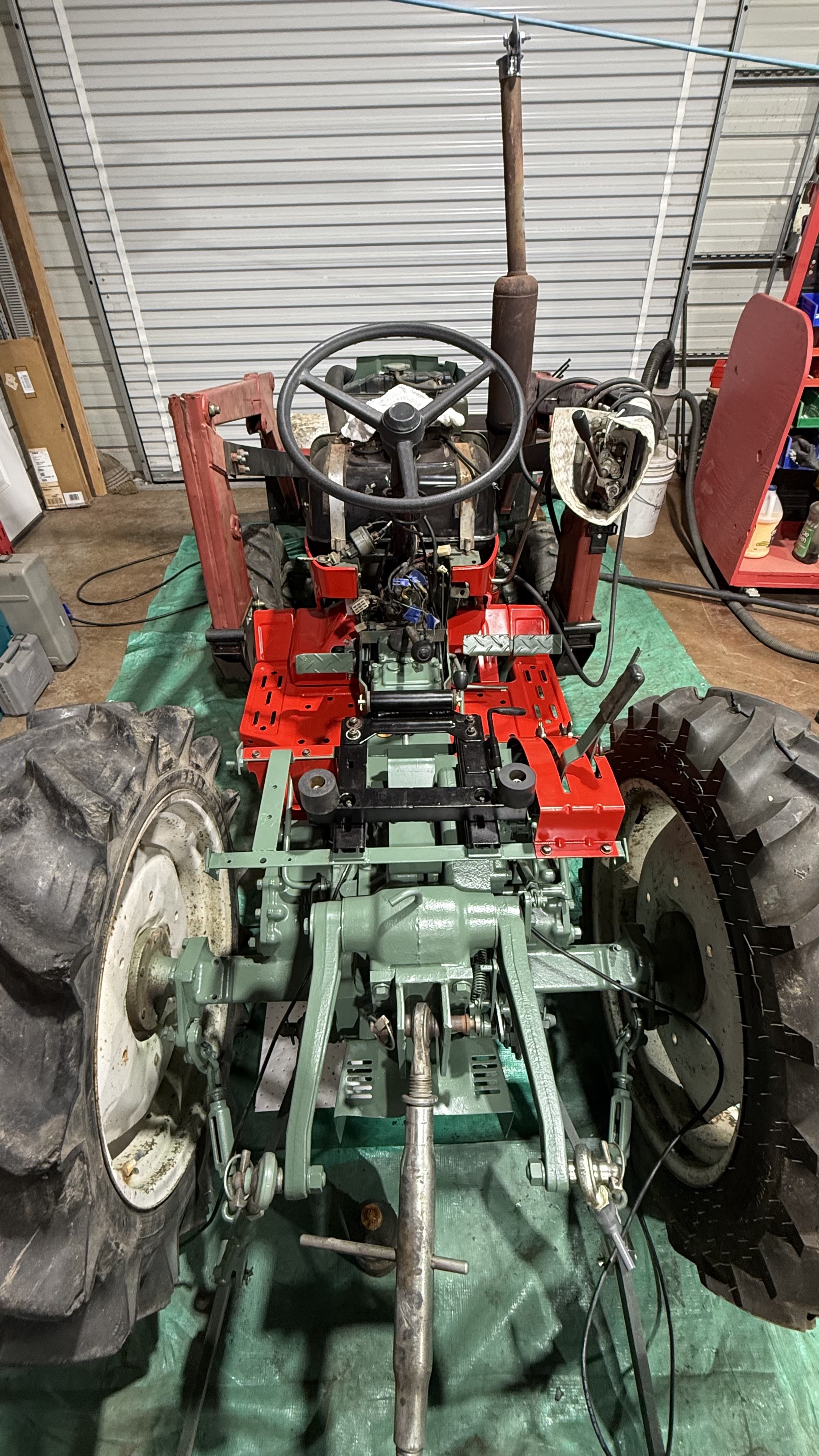

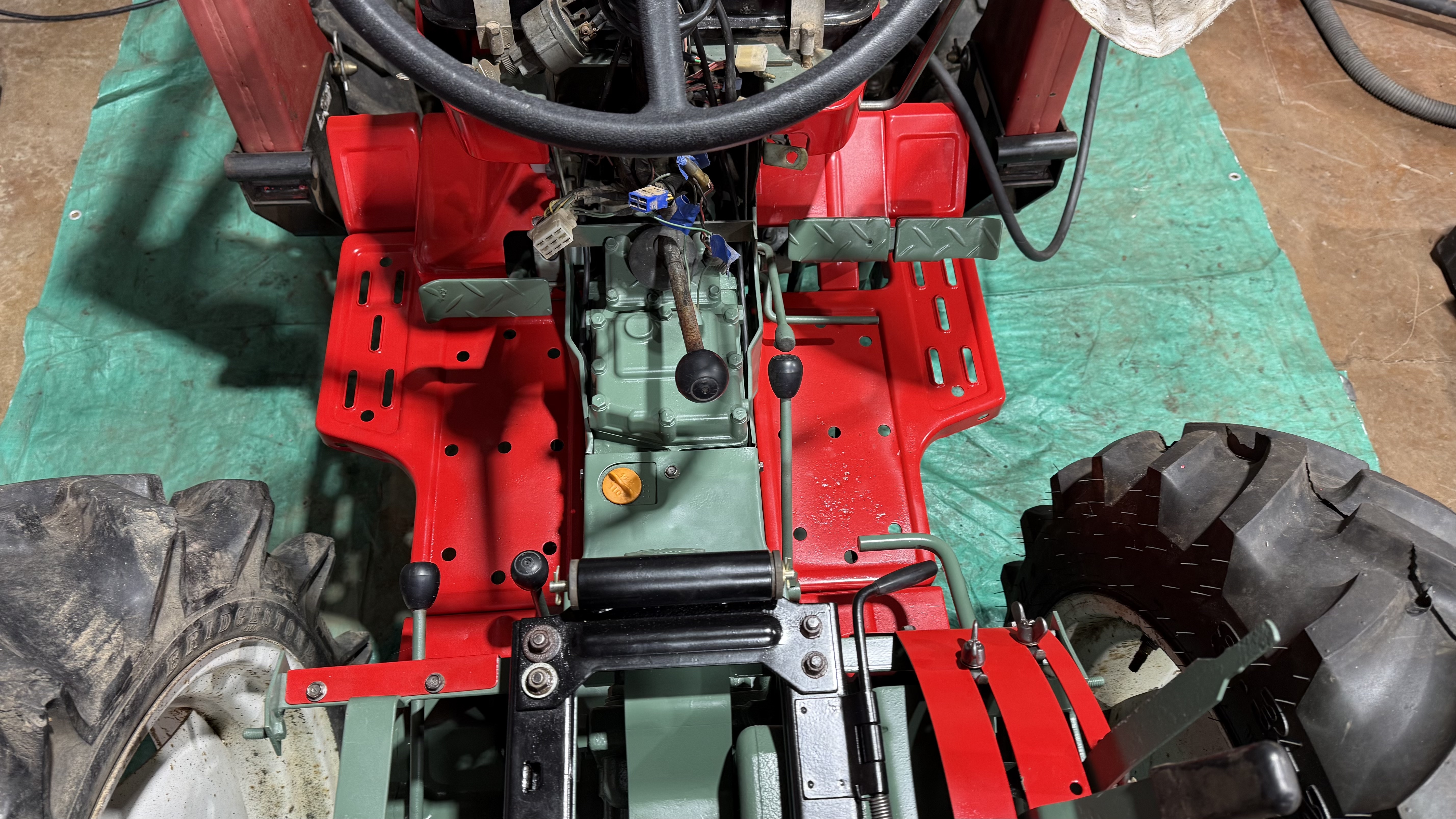

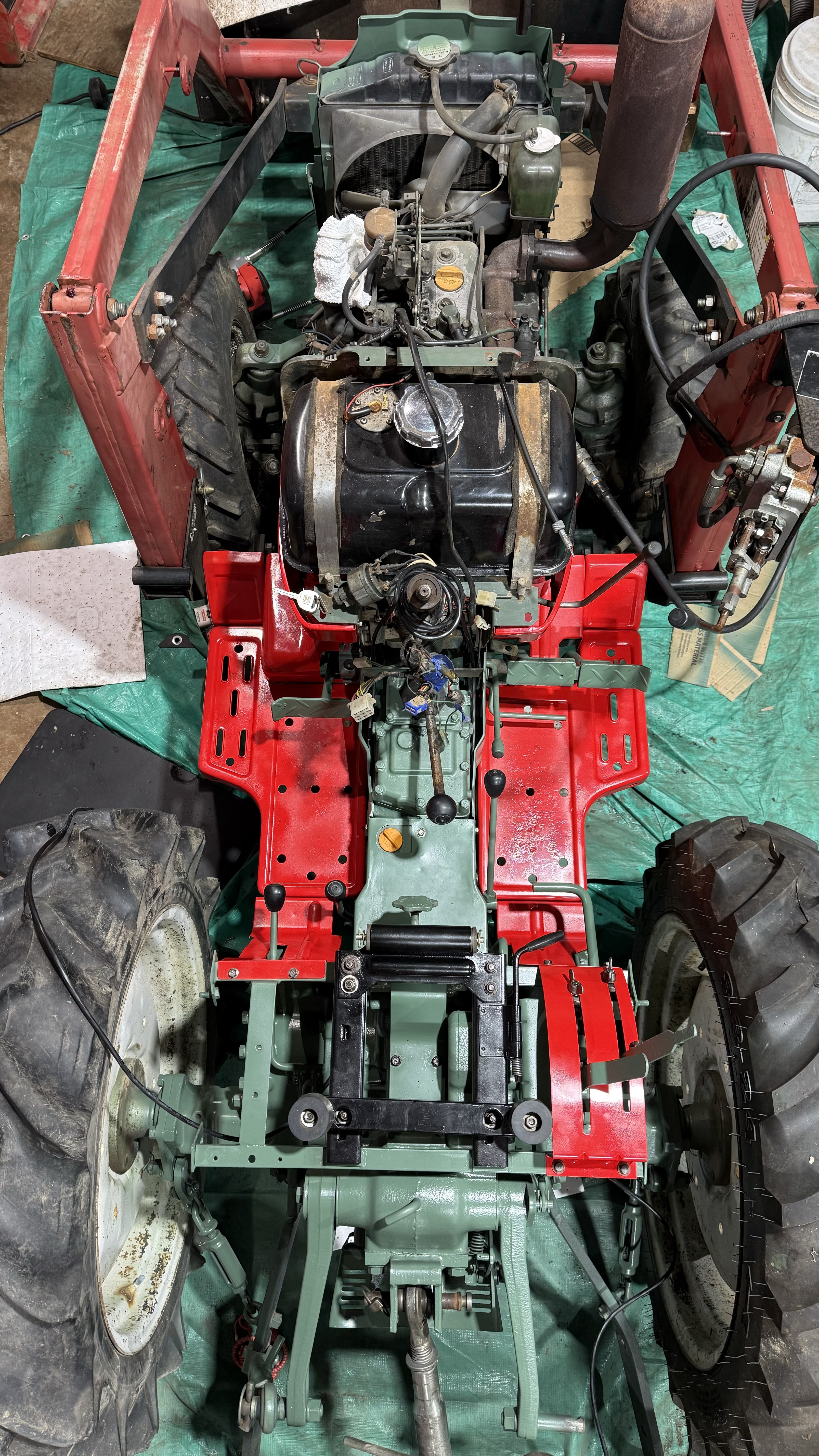

Here are some updates.
This is using the Gloss Apple Red334024 and the Spruce Green
It's looking really nice overall. The Apple Red is a tad brighter than the Fredricks red paint, yet comparing your images to the Yanmar US domestic YM machines, it aligns really well.
Is the Spruce Green also the Rustoleum too? Or another brand and reference number?

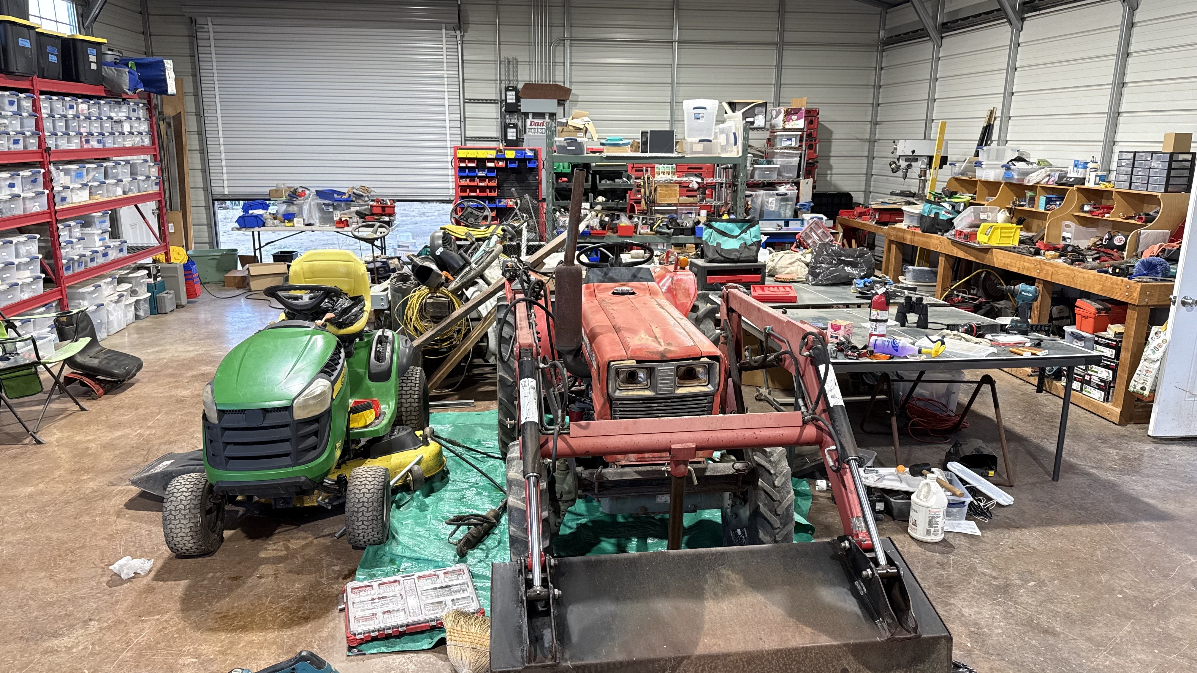

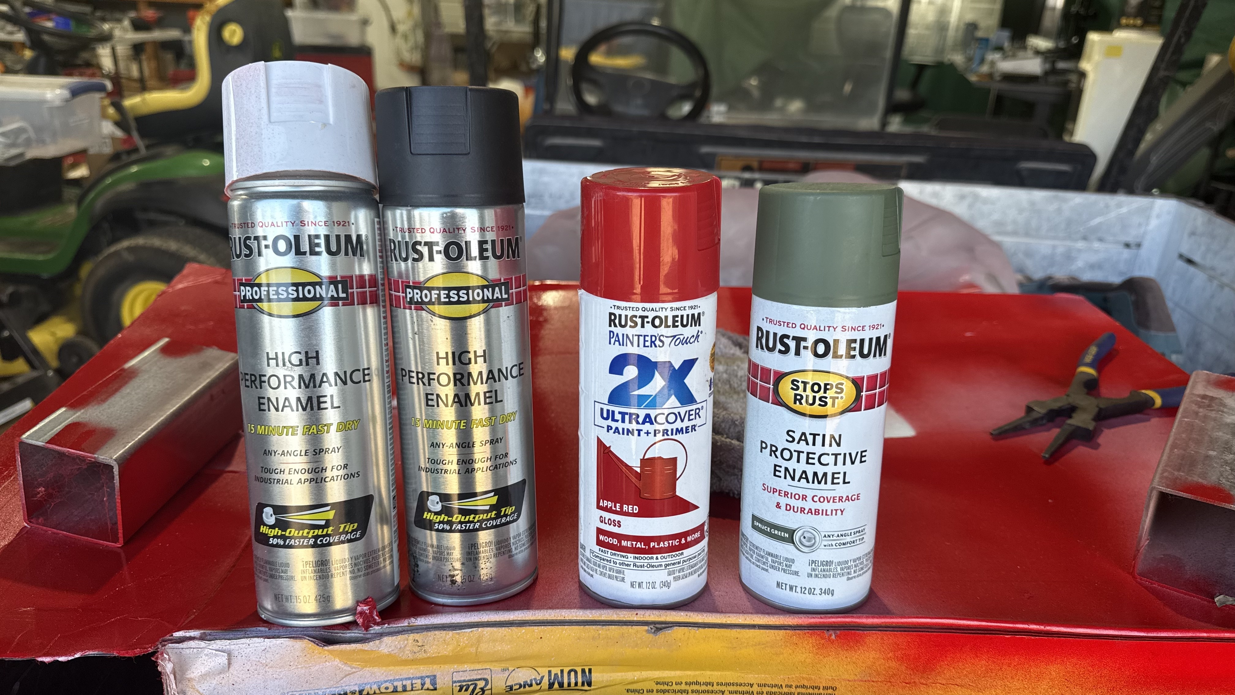

Yes, I could not find a Link for the Green. Attached are the Cans I used. For the white and black and spend a bit more on the enamel. I know the White is more white than the slight cream color, but I'm good with that.

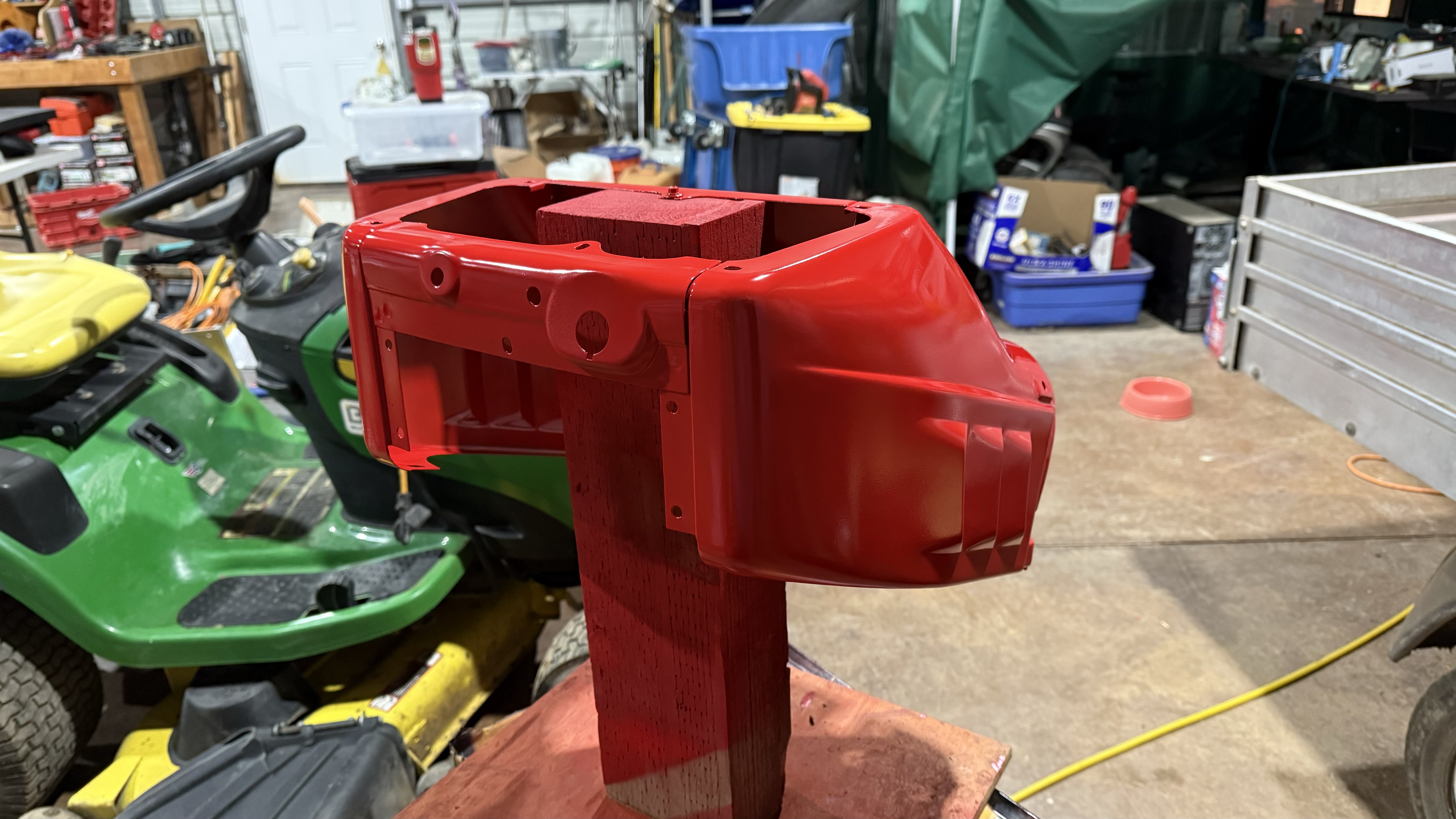

Here is one of the side Panels and the 'Console' portion of the body

Fredricks calls the Grn. Spruce also and that looks correct for a Refurbished tractor that was from them. The Implement red can came from them. Prev. reply! They have it in Gallons or Spray Can. I'm showing Spruce Grn, Red, White, Gloss Blk and Light gray primer. My YM2000 is Org. paint. I just had to touch up a couple fender spots of Red. My Grn. is all Org.. Multi color printing pressman for decades so I've mixed and matched few colors. I would check out the availabilty from them. The cans showing of Rust oleum is a common brand for my area. Hm.Depot . T. Supply Etc.. my wheels are Org.Yanmar white also. The side covers white is Wally world in a can.
