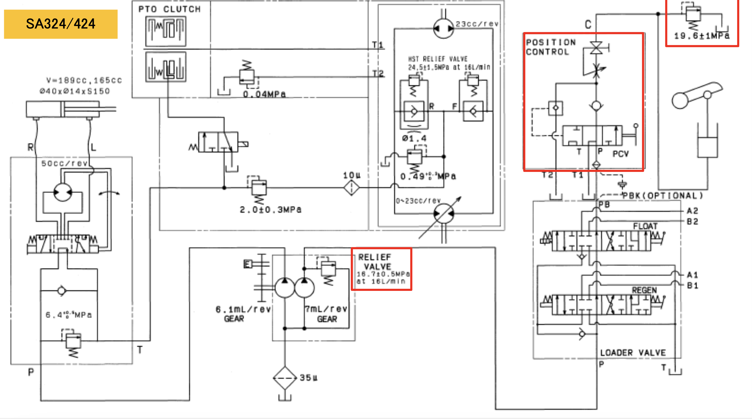

No, did you mean to call them hydraulic motors??? Or do you mean hydraulic pumps?
If you have a shop manual for your Yanmar it will have a hydraulic schematic. If you do, and want, you can post the hydraulic schematic and we can go through that with you. It will answer at least some of these questions.
Luck,
rScotty
Yes, I did mean pumps, though I also realize that there are also motors onboard. I believe those would turn the high pressure fluid into forward motion when I push the drive pedal. Kind of a compressor vane vs a turbine vane relationship, but with a different mechanism?
You reminded me that a helpful stranger gave me a flash drive with loads of awesome information on it, and I just found the info stored on my computer. Though I don't believe it contains a service manual per-se, it does have a powerpoint presentation that was probably written for service techs. I'll attach a screen hot of the hyd diagram, which I'm not very good at reading.
Nice flow diagram. In the center, the thing like a cup or shallow U is the symbol for the common sump. Right above it is the symbol for a filter, and notice it is 35 micron type. Then going on up are two pumps - the circles with a triangle inside.
Somewhat higher and to the right is the HST filter I described. It is a 10 micron super filter for the HST.
The thing inside the HST box with the big arrow is the variable displacement pump that runs the HST. Lots of different ways to depict that...
Hey It looks like your loader bucket dump has a regenerative valve, that's nice.
