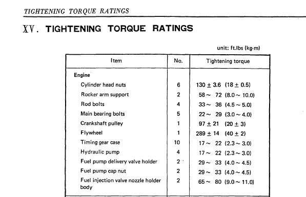

Just received an e-mail back from Hoye. These are the YM2000 engine torque specs that they sent me, containing rocket arm, head stud nut, crank shaft, and rod bolt torque specification: AA765A48-D6AF-4A0A-9B32-51DE6B47C3A0.jpeg

Does anyone have the specifications for end gap, torque specs for rod bolts, spec and sequence for head studs?
You need the I&T Shop Manual, $27 on Ebay. Or maybe get one from a different vendor would ship overnight. This is similar to a Chilton manual but far more precise, it's written for the pro mechanic who just needs Yanmar-specific specs. Or get a real Yanmar YM240 Shop Manual, that covers everything you can imagine.

Ring gap was a little wide. Seems like spec is .011 to .019, and these came in at .023
Oh well, if it works it works, if not, at least it’s fairly simple to take apart again.
